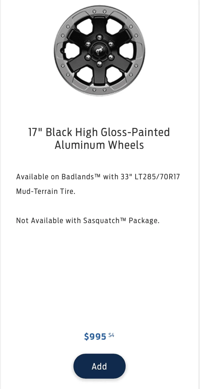

Sas on A BL is a good deal. If you ever think you may want 35s, just get the Sasquatch now. You will pay more than $2495 just for wheels and tires. And that doesnt include gearing.

I would prefer 35s I think, but I hate the sasquatch fender flares, and I really dislike the goodyear tires. So I'm getting a Badlands with the upgraded wheels and the BFG KO2s, which is a phenomenal tire, even if it is only 33".

This is what it costs to add 18" rims to a mustang.
For those sticking with the 33' but adding the optional rims you have this cost
That makes the SAS cost of $2400 very fair and it guarantees the 2.7 gearing.
I highly doubt anyone who adds SAS to a BL will regret their decision. I can guarantee there will be people going with 33s that will and eventually hit the aftermarket to get them and end up spending roughly the same price or more.
