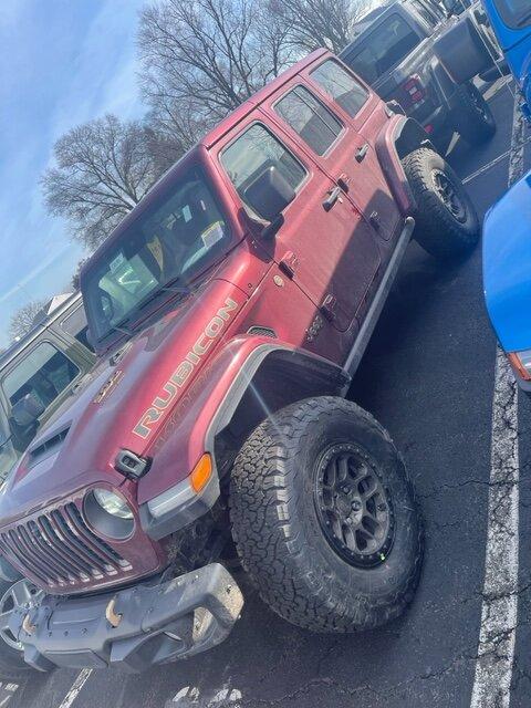

The one in the showroom was still there. Mine was sitting outside filthy. I’m gonna take Lazerus advice and get adjustable LCA. I planned on a metal cloak 3.5 lift so I’ll stick with them.

Nice Jeep. Digging the color.
