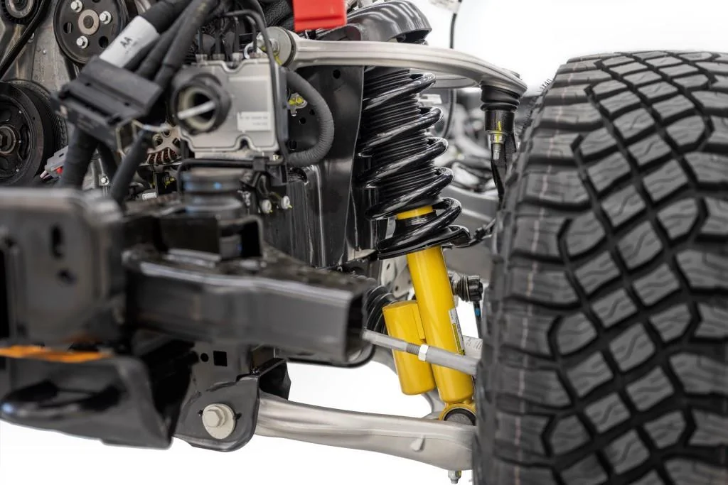

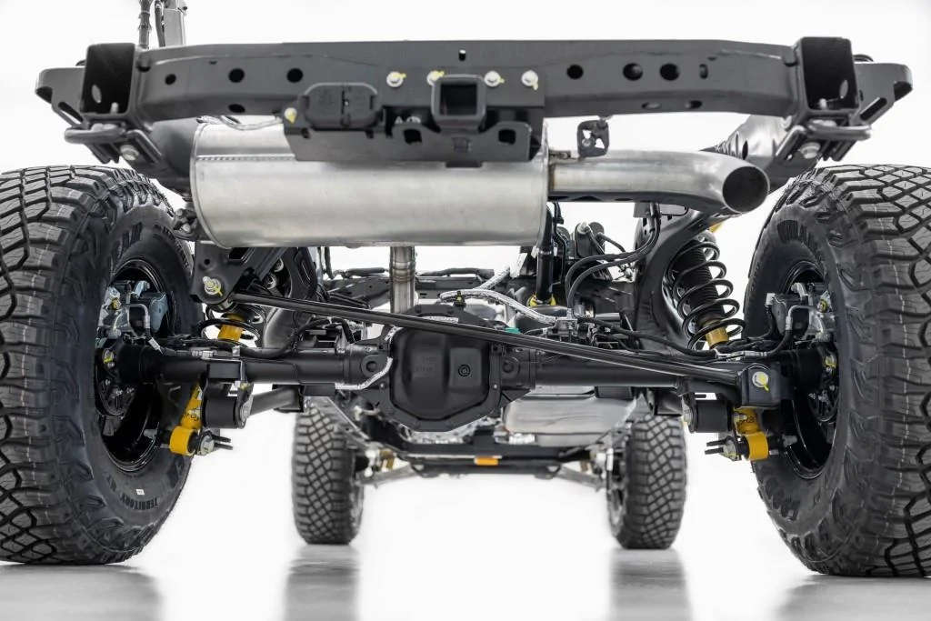

I can't speak for Ford but most of your off-road suspension like Fox, King and Bilstein use linear rate springs. Usually springs are matched around a shock and with Bilstein sourced coilovers like the 6112s I would suspect these would also be linear. I would prefer this myself because once we know the spring length and rates we can fine tune them for added lift and addition weight.
Looking the Bronco springs they do appear to be linear.
Ford Bronco Position sensing dampers.... Why?? FordBronco_parts_09 - Copy
Ford Bronco Position sensing dampers.... Why?? FordBronco_parts_03 - Copy
