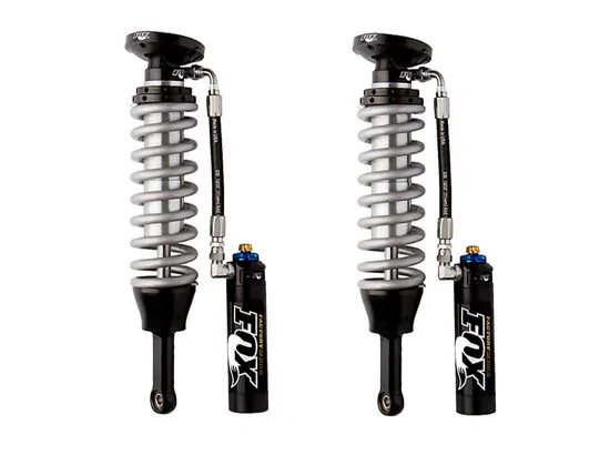

On another note I spoke with the Fox Shocks rep at the 4WP show as well. He danced around confirmation of Fox Live shocks on the Warthog but when I told him about the spy photos we have on the forum he gave up the dance.
Asking him their plans for for the rest of the Bronco's he said the would have the full line, 2", 2 1/2" and 3". He said one challenge they are having are the rear shock angle mounts, like on the Ford Ranger, he showed me an angle mount plate shock similar to this.

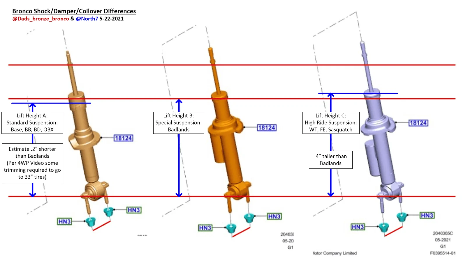

If the difference in height and travel on the BL (not including SBD) is derived from the bilstein shock/spring set up and not other changes, would you be able to put a set of the badlands shock assemblies on a Base/BB/BD/OBX and get the increased ride height and performance without modifying anything else in the suspension?
Yes, that is a reasonable assumption, if you buy a set of takeoffs from someone else, the entire coilover unit, just bolt them one. You will however want to get an alignment done as the geometry will have changed.
