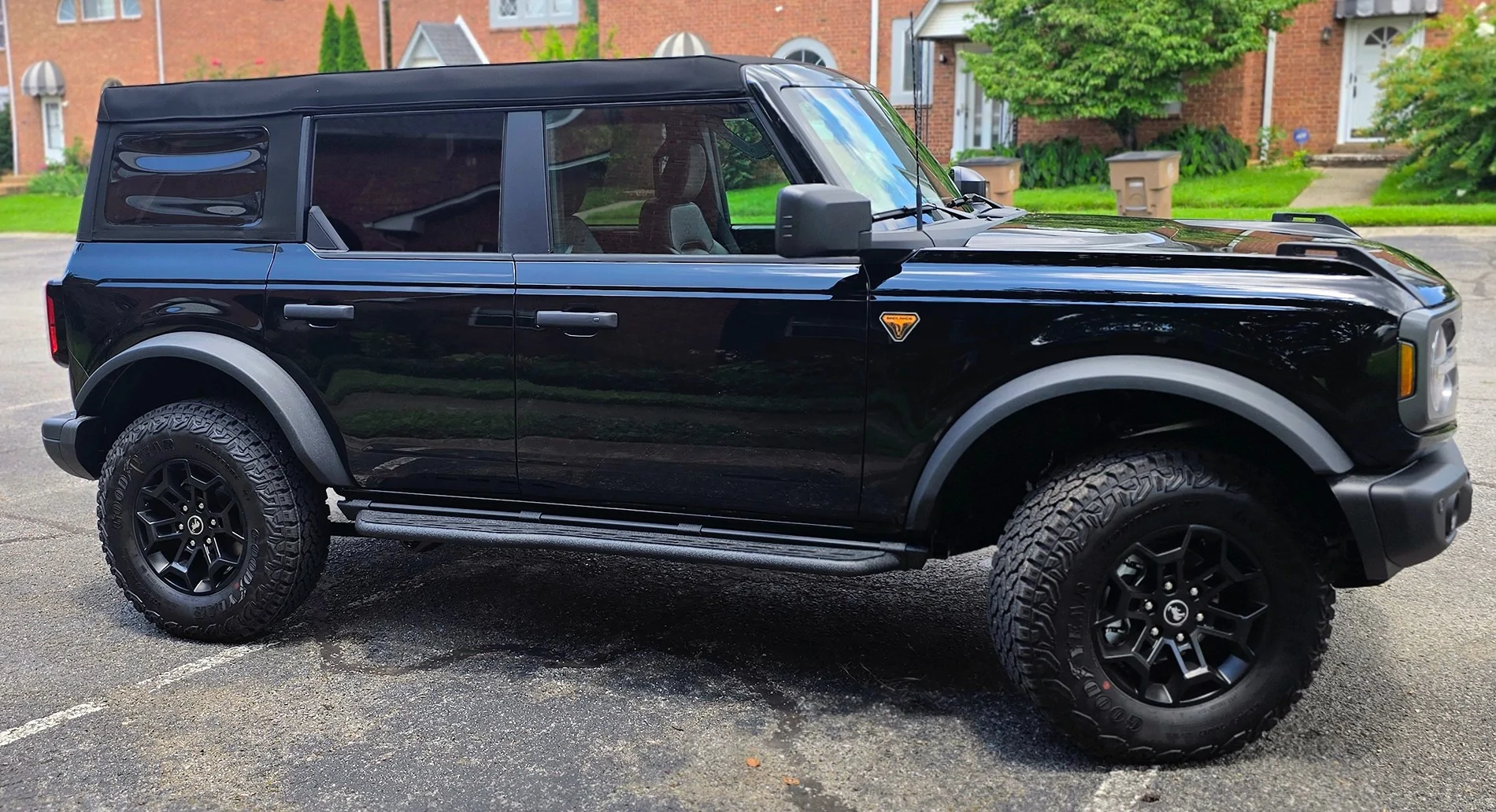

She's finally here!!! 6-8 weeks that turned into 4 months 😩
I'm considering a full PPF wrap and ceramic coating to keep her this beautiful.
Thoughts, feedback, experiences?
