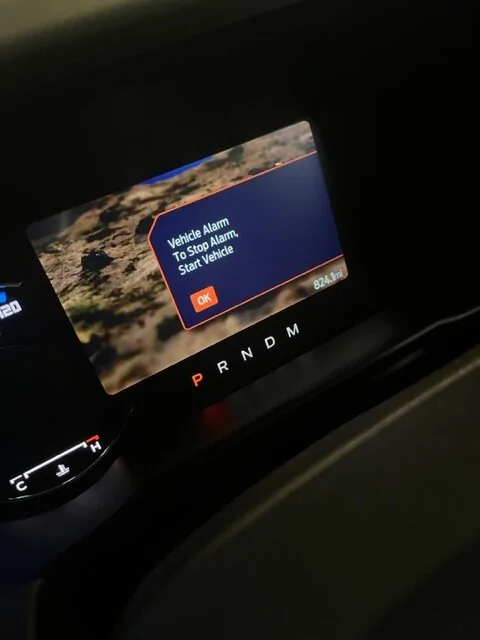

From my understating and testing, if you lock it with the fob (or app), this sets the alarm, and if you then reach in and open door, alarm will sound shortly if you don’t start it (or unlock from fob). A message on dash screen pops up "Vehicle Alarm - To Stop Alarm, Start Vehicle".

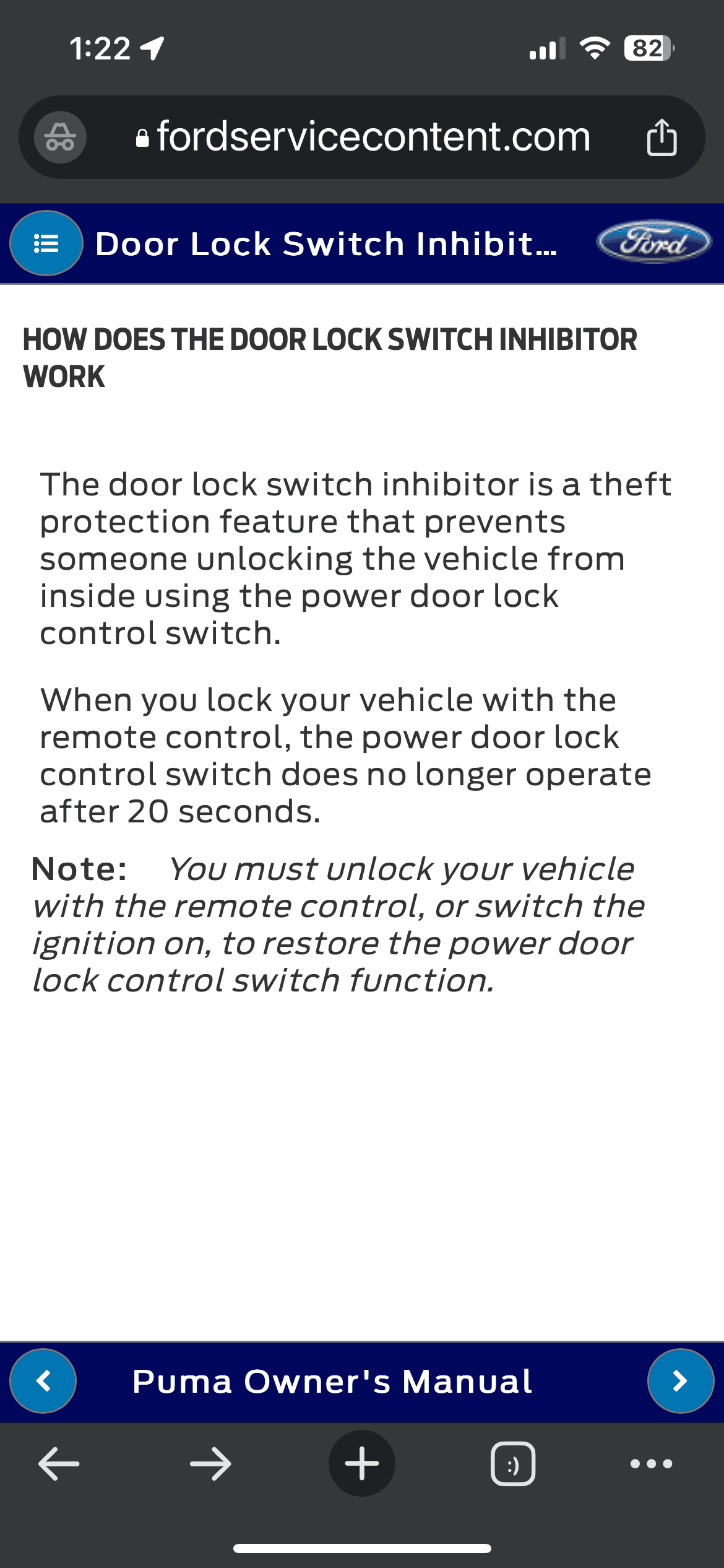

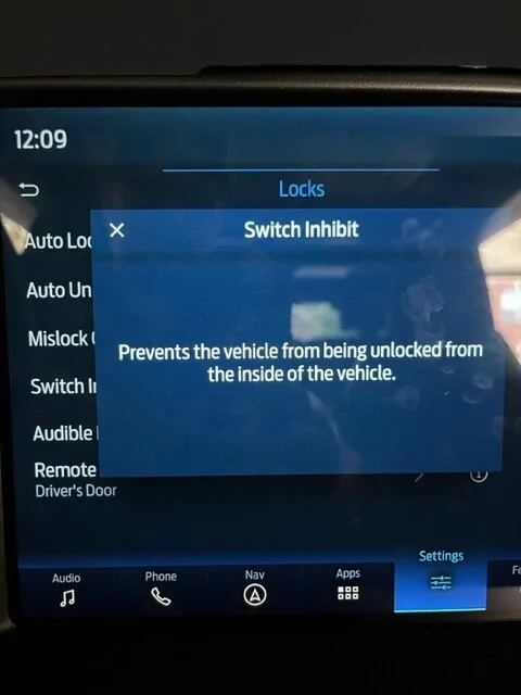

There is also a setting called “switch inhibit”. This is found in settings, vehicle, locks, switch inhibit. (Prevent the vehicle from being unlocked from inside). With this enabled, if the car is locked and someone reaches in to unlock it won’t allow them to. They can still open door from inside, but then alarm will sound.
I tested the switch inhibit by keeping windows down, and then locking car from outside with fob, waiting over 20 seconds, then reaching in. It would not let me unlock the doors with the button on the door (message on screen pops up reading "Switches Inhibited Security mode"). I could open the door with the inside handle, and the alarm warning came on right away stating "Vehicle Alarm - To Stop Alarm, Start Vehicle". The alarm would then sound off shortly if I did not start it our unlock it from the FOB.
I also tested this by sitting in the bronco, and locking doors with the app. waited 20 seconds and tried to hit the unlock button on the driver door. it would not unlock the doors (message on screen pops up reading "Switches Inhibited Security mode"). I reached back and opened one of the back doors, and the alarm horn started going off right away.
I couldn't find any details on the switch inhibit in the bronco manual, but it pops up in another manual (pic attached) when googling for it. Also a dealer did a brief video on it here from a different vehicle:

Ah, this should be the solution. I either didn’t have switch inhibit enabled in settings or I wasn‘t waiting the required ~20 seconds post locking for it to kick in. With this, it should make the rear trunk with a security enclosure much more useful (as long as I remember to lock the vehicle). Thanks!
