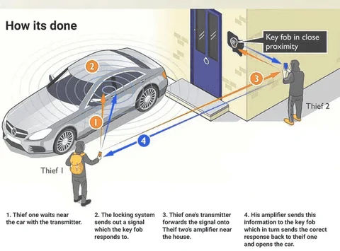

Key fobs are matched to the car, and they talk back and forth to the car in a way that's different every time. A thief can't simply record the conversation and play it back. You can't clone a key.
What thieves do do is use a radio booster to extend the range of your key in your house so the car thinks it's right there, and opens up. The RFID pouches and boxes stop the radio snooping and thieves are back to square one again.
Lifeliberty is right, the radio signals are weak and the booster has a very limited range.
Top end, very new tech is starting to use timestamps on the conversation between key and car. If there is a delay, like from a radio relay booster 50 feet away, it protects.
To augment what PlayTime is stating, current scanners are now using VLA repeater-booster technology with a 1200 feet range. This is effective for attacking individual Fobs against a single vehicle far away and apart (the Lambo sitting in a long driveway). It is less effective at public garages and streets where there are more vehicles to identify which random fob activated it.
The timestamp technology is not broad market technology. Most cars on the road are using the older radio relay tech, which is now relatively easy to hack.
So, the faraday bags/boxes are a decent protection if you are concerned. To be highly effective, it would have to encapsulate your fob 100% of the time, even while using it to drive. But that would interfere with many car's fob presence queries. So, there are trade offs.
Keep in mind this is cold war era radio technology slowly being updated to modern cars. Either enough people have to complain (aka class action lawsuits), enough money lost by insurance companies, or enough vehicle buyers rejecting cars, before the automotive industry will speed things up. It has taken Tesla 17 human deaths to admit there might be a problem with their self-drive software.
