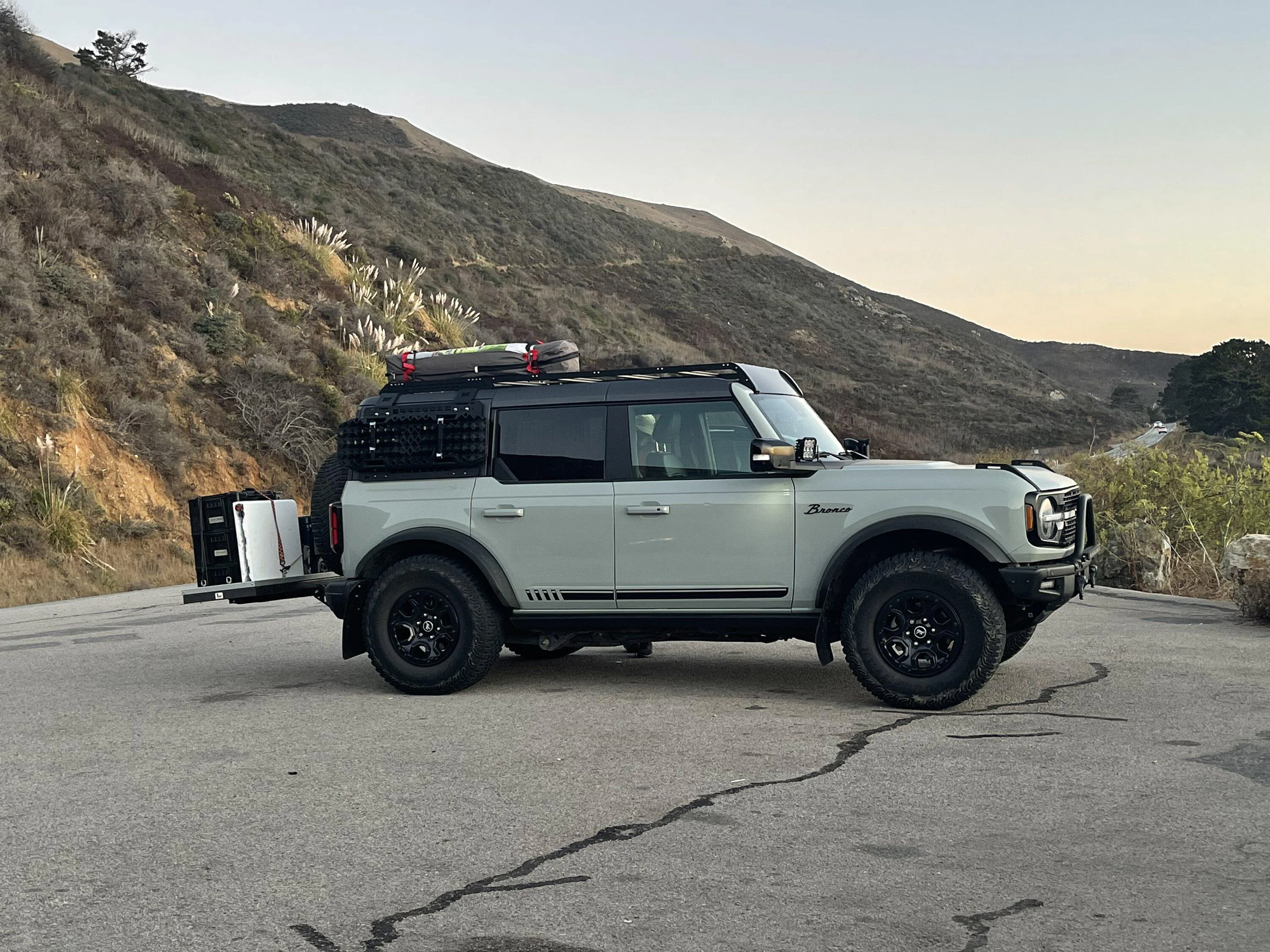

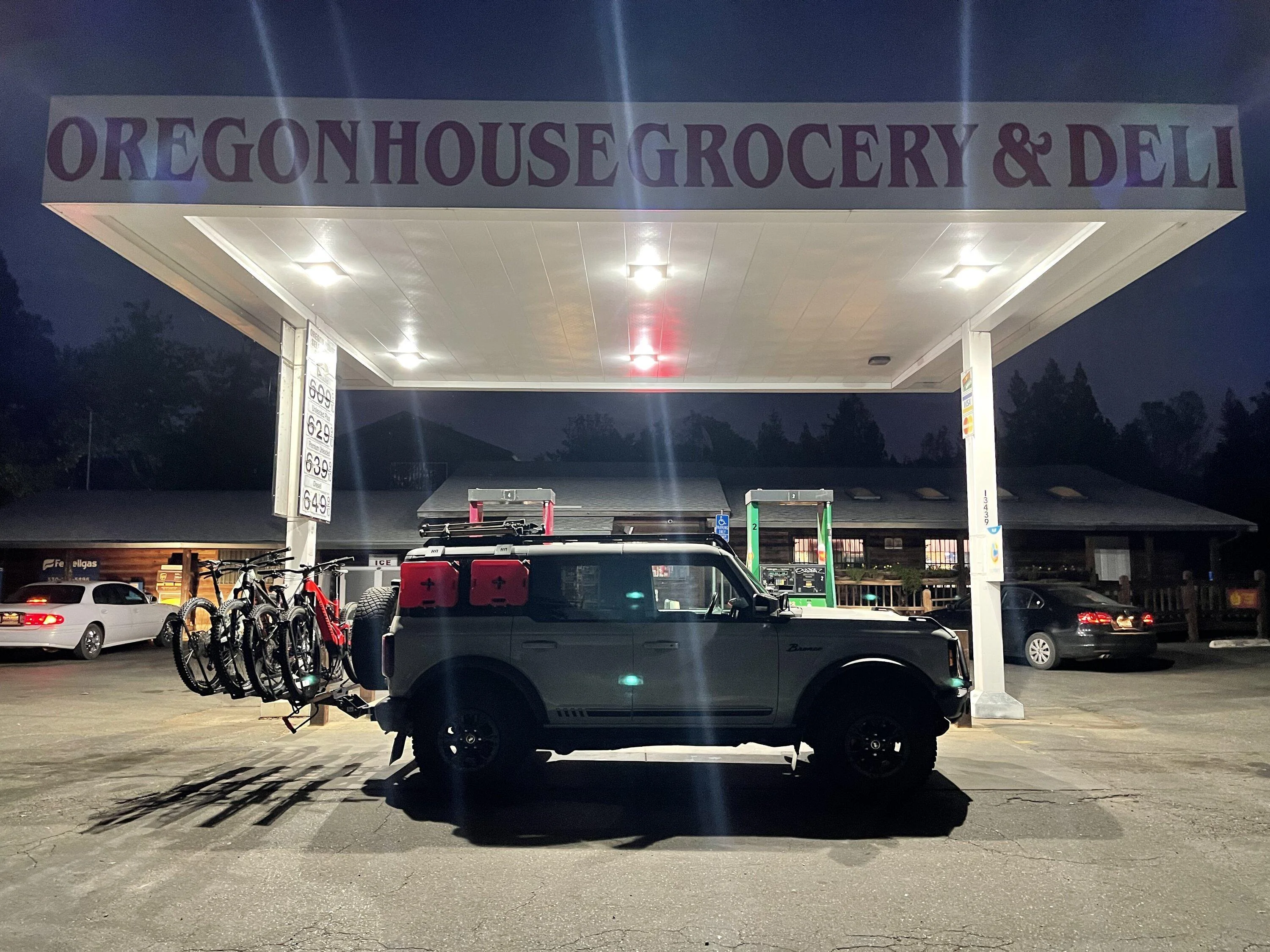

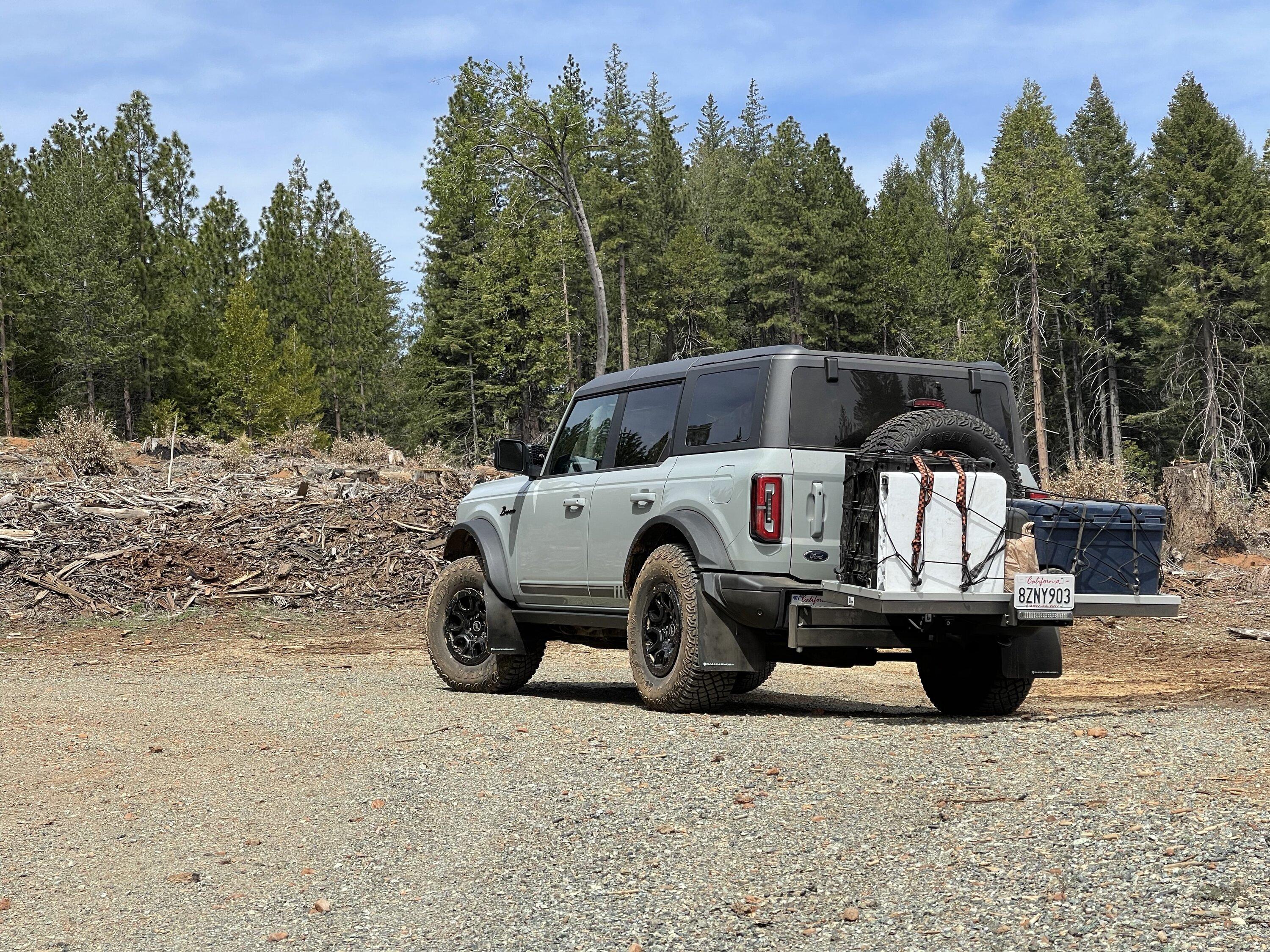

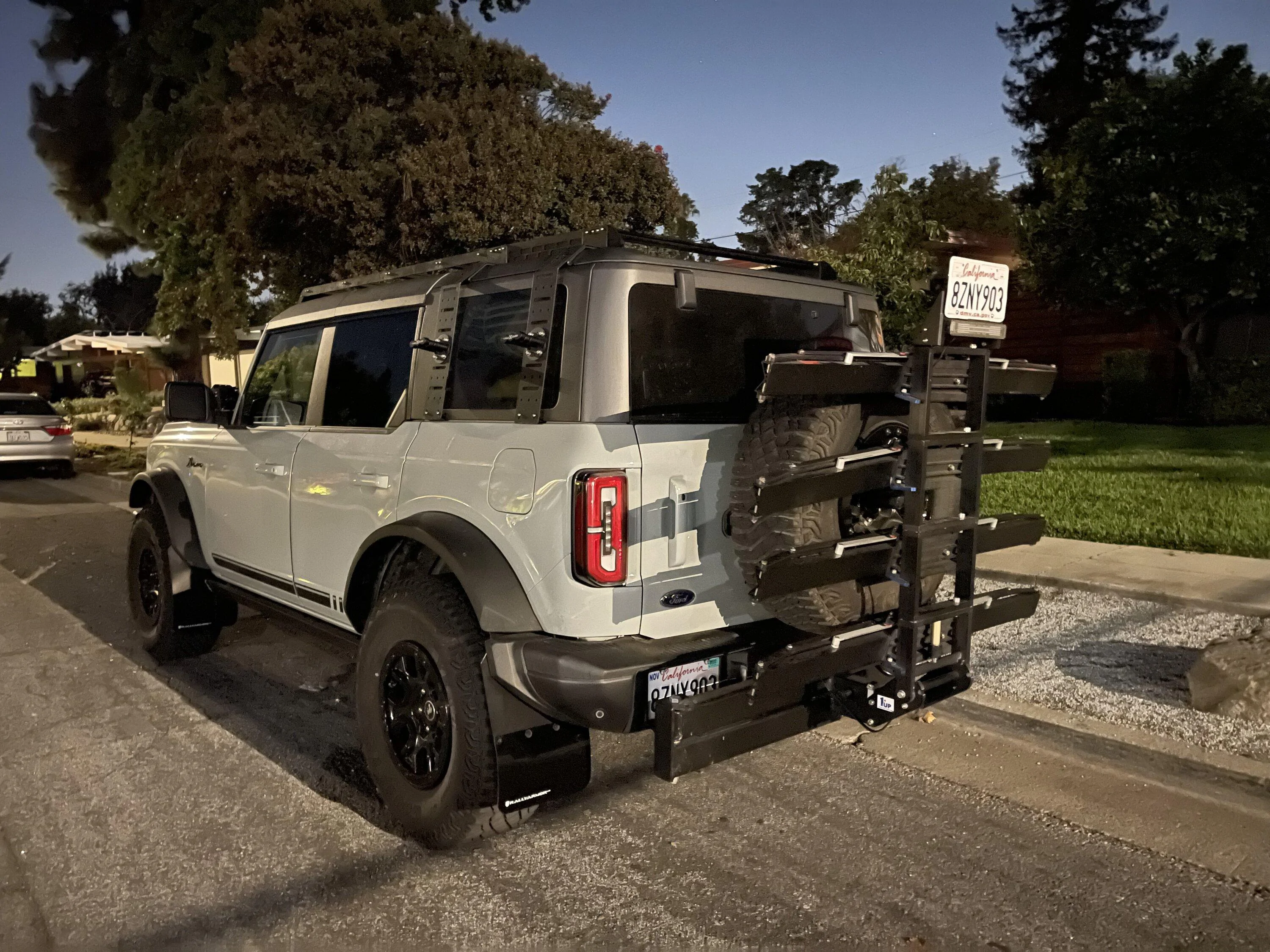

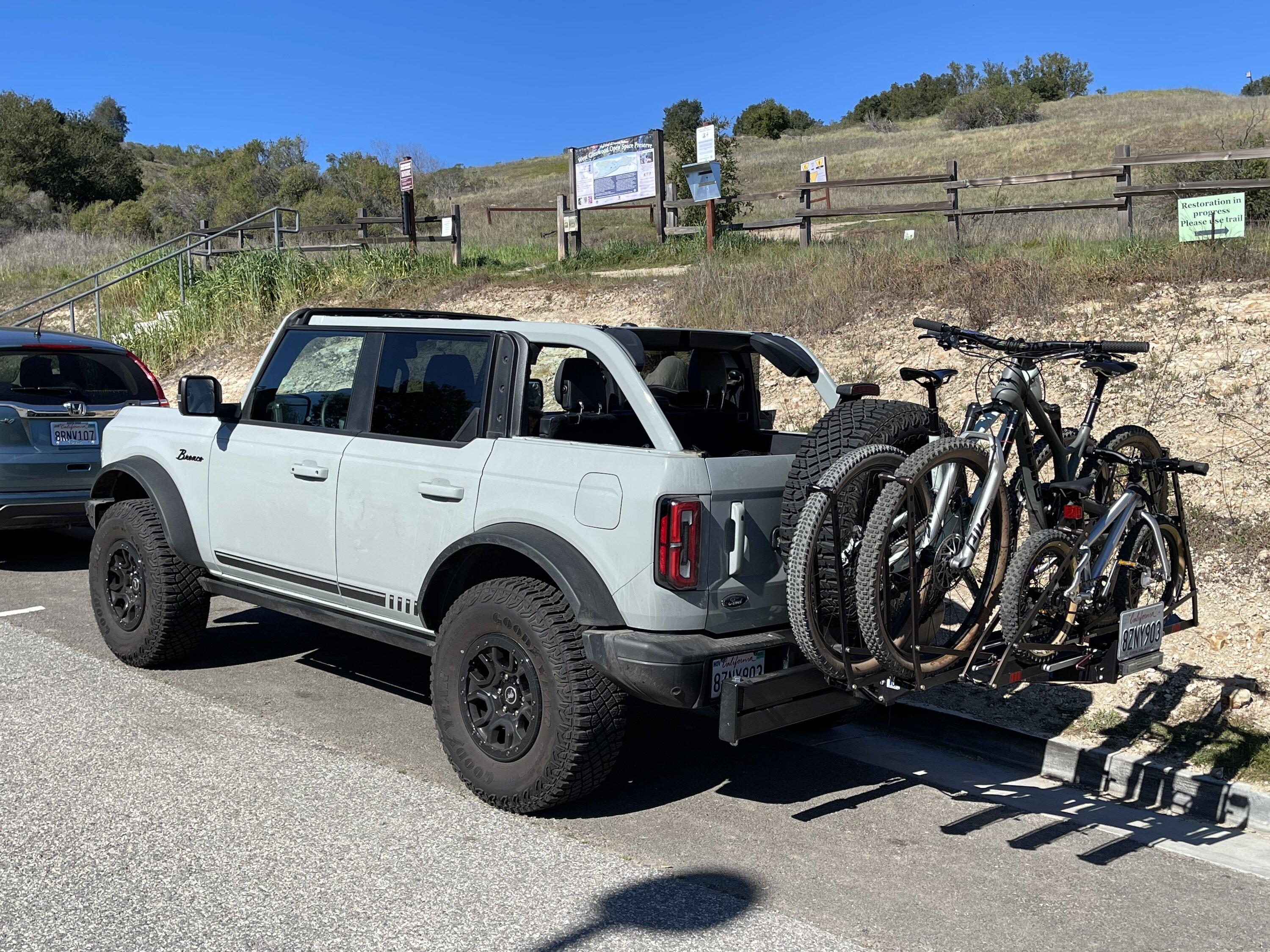

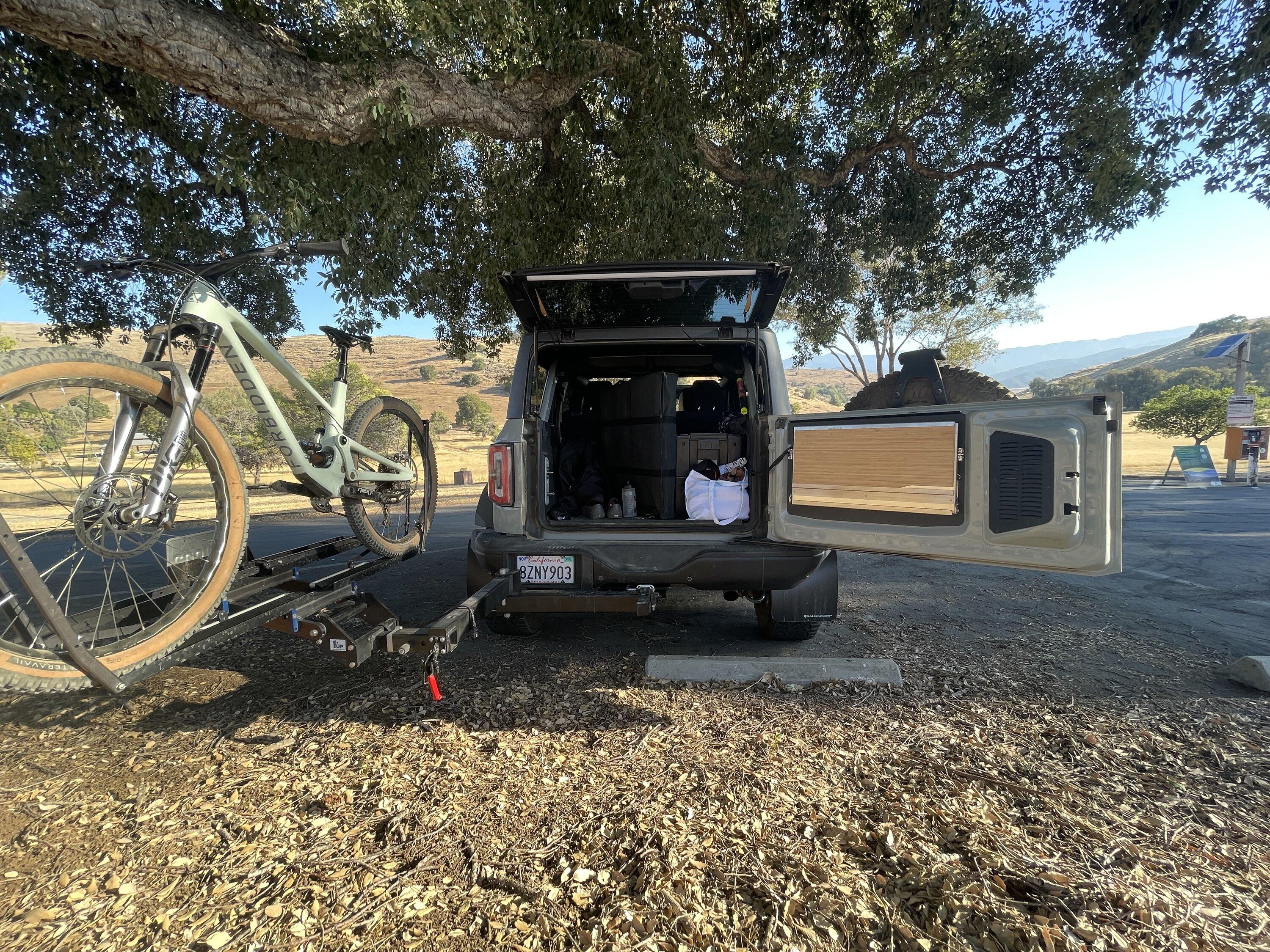

Iā€™ve been running a gen 1 Rack Attach with both a 1up bike rack (up to 4 trays) and a 1up cargo tray. I have the anti wobble insert and I also picked up an addition stabilizer clamp to further lock down the Rack Attach to the hitch. I also picked up a spacer for the spare mount which spaces the tire off the back a few inches and makes it possible to remove the vertical pin that secures the Rack Attach. Spacing the tire off the back in order to access the Rack Attach pin is an absolute must. I also have the license plate mount and lighting package for it which solves the issue with the Rack Attach blocking the OEM plate location.
I went with this setup because I assumed it would be the most stable and bombproof route possible. It took a long time and was expensive to get the whole setup dialed in. My results overall with the rack have been mixed, but generally off the mark from my expectations. Being able to swing the rack away from the truck is a game changer though - simply fantastic.
When I have more than 2 bikes on this setup (each bike around 30 lbs), it starts to bounce in ways that give me a lot of anxiety. Recently I took a trip to Downieville with 4 bikes, one of which was an eBike. Total weight of the rack setup plus bikes was 280lbs, so well below the 350lb max tongue weight of the Bronco (but the effect of the cantilevered weight/leverage is a wild card). The whole time I was terrified of hitting bumps on the highway (let alone dirt roads/off-road) because of the insane amount of bounce (Iā€™d say 5-8ā€ of vertical bounce. Iā€™ve heard of 1up rack receiver shafts snapping due to this sort of bounce (itā€™s aluminum). From what I can tell, the source of the bounce is the mechanism on the 1up rack that lets you tilt the rack upward - thereā€™s a spring loaded bar that fits into a receptacle and thereā€™s quite a bit of amount of play between the mating interfaces. I donā€™t think thereā€™s anything I can do about this - itā€™s a design issue. I think this same issue also causes the cargo tray to droop / angle backward slightly when loaded up, which you can see in the pics.
Also, when looking at the rack from the back itā€™s angled to the side drivers side slightly. I believe that the Rack Attach causes this because of its massive weight out the side twisting/torquing on the hitch/shafts..
In general I donā€™t think the engineering and manufacturing quality the Rack Attach is up to par with the rest of the 1up rack. Itā€™s a bit crude and very heavy.
I will say that generally this setup works great most of the time, looks fantastic, and has been super versatile. I donā€™t know that any other setup out there would be better with respect to the issues Iā€™ve experienced. TBH I feel like receiver hitches/interfaces for bike racks and cargo trays could use some fresh thinking but thatā€™s another conversation.
Feel free to ā€˜bounceā€™ any questions off me.

With 2 bikes thereā€™s a bit of bounce but it isnā€™t much of a concern. Aside from the bounce in the rack, the hitch clamp I added definitely helps with the stability overall. Hereā€™s a link to the one I picked up:
Trimax THC200 Univeral Anti-Rattle Clamp Fits 2" Hitch https://a.co/d/eHQYKPA
Ford Bronco Rakattach 2.0 vs Kuat Pivot V2 20647AC7-4C1C-45E1-820D-BA5B662FD9F7
I noticed in this picture you don't have the black "lock nut" on the gold colored bar screwed down. That should take up the slack from the spring loaded bar in to the receptacle that you mention. You may already be doing that when the rack is down, but that's something to look at if you haven't already.

Thanks for the tip. Yes, I fasten that nut down when I have the bikes on, but it doesnā€™t take out the vertical slop between the spring loaded bar and the slot it nests into, unfortunately.
