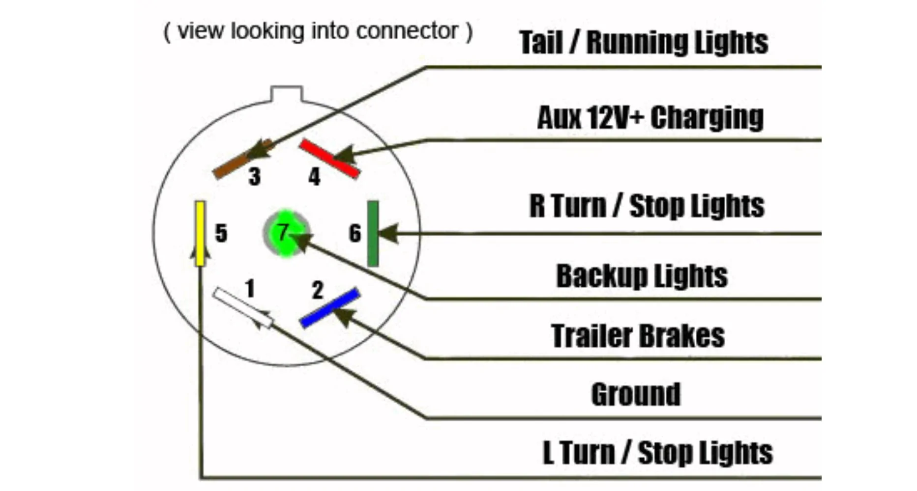

For those that question the difference from 4 pin to 7 pin.
12v
Trailer Brakes
Back up lights (will actuate reverse solenoid if trailer is equipped)

To kind of recap what other people have mentioned as well,
Adding a hitch in a 4-pin after the fact is relatively easy. However, nobody has been able to add the 7-pin harness afterwards and get it successfully to work with ANY brake controller.
There are a couple folks much smarter than me that seem close.
And before you just dismiss needing 7 pins, You may want to check the state laws on trailer weight requirements for anywhere you plan on traveling. In addition, if you plan on towing any trailer that needs anything other than basic turn signals and brake lights, you're going to need the 7-pin.
Some examples: trailers with hydraulic brakes that use the reverse light to bypass or trailers that need 12V for accessories, etc.
