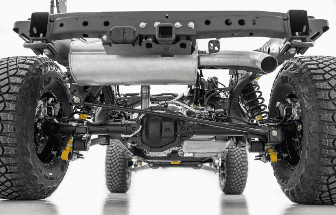

Correct, Bronco has a 2" receiver but it doesn't have ClassIII tow capacity. I saw some pics from the Buena Vista, CO event and it is 4 bolts on the center of the rearmost frame CROSSMEMBER https://www.bronco6g.com/forum/thre...st-q-a-with-photos-by-imissmy1996bronco.5262/. That is not a ClassIII hitch, however there sure seems potential for a ClassIII by Ford or aftermarket.

Yep, that's the "naked" pic, shows the ClassII 4-bolt on the rearmost crossmember. Shows the rear suspension, shows the towhooks bolted to the framerails where a ClassIII hitch can be bolted, shows the factory 4/7 pin.
That setup can be modified to 5000lbs, but those skinny rear coils will need to be thick HD coils and a frame-mounted hitch. Stronger rear shocks.
A real tow package is doable.

So do we think the Factory Tow package will be something heavier duty than that 4 bolt attachment? AND would that mean it would hang down more as a result?
No. Everything We’ve seen and heard from Ford so far is that it will be a 2”, Class II hitch, as seen in the picture of the frame above, with a 3,500lb limit.
It was asked whether that rating might be increased by launch, and the answer from Ford was “no.”
Of course, as with everything, I’m not going to totally believe anything until B&P comes out, but that’s what we know thus far.
OH .. so the pick IS the tow package? So without that $600 you don't even get a hitch?
Crap... gotta have a hitch.. wonder how long before Aftermarket comes up with a solid one bolted to the frame...

This is a can of worms that has been debated and discussed in depth for a while here.
Basically, yes, it seems that the $600 gets you the receiver and the wiring harness (4 and 7 pin, in their defense). No brake controller, no extra cooling, brakes, springs, etc. Just the receiver and harness. There is “trailer sway control” that is accessible through the dash controls, but it seems that it is standard on all trims, separate from the tow package. Many people feel that $600 is a lot for just the receiver and harness, and can save money going aftermarket.
Some people have decided to Save their $600 and invest in an aftermarket unit when it comes available. Because the Bronco is based on the next gen Ranger platform, which can tow Considerably more, they figure that it will be a trivial matter and minimal investment to instal an aftermarket receiver that attaches to the longitudinal frame rails (where those tow hooks are) and would be able to handle a higher load... and also adding more rigid springs, additional load spreading equipment, sway bars, etc etc etc.. all in the effort to push the limit beyond 3,500lbs...
All that said, the Bronco is still only *rated* for 3,500lbs (and there are a lot of factors that go into that rating, not just the receiver), so I would caution anyone to go above that rating unless they know full well what they are doing.
