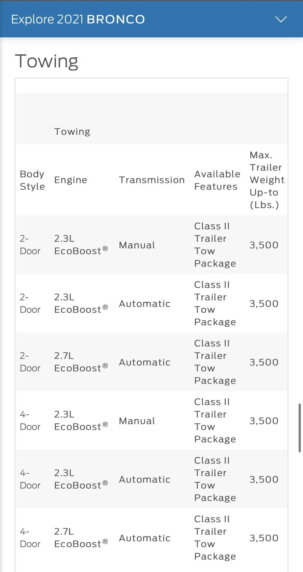

Basically, yes, it seems that the $600 gets you the receiver and the wiring harness (4 and 7 pin, in their defense). No brake controller, no extra cooling, brakes, springs, etc. Just the receiver and harness. There is “trailer sway control” that is accessible through the dash controls, but it seems that it is standard on all trims, separate from the tow package. Many people feel that $600 is a lot for just the receiver and harness, and can save money going aftermarket.
Some people have decided to Save their $600 and invest in an aftermarket unit when it comes available. Because the Bronco is based on the next gen Ranger platform, which can tow Considerably more, they figure that it will be a trivial matter and minimal investment to instal an aftermarket receiver that attaches to the longitudinal frame rails (where those tow hooks are) and would be able to handle a higher load... and also adding more rigid springs, additional load spreading equipment, sway bars, etc etc etc.. all in the effort to push the limit beyond 3,500lbs...
All that said, the Bronco is still only *rated* for 3,500lbs (and there are a lot of factors that go into that rating, not just the receiver), so I would caution anyone to go above that rating unless they know full well what they are doing.

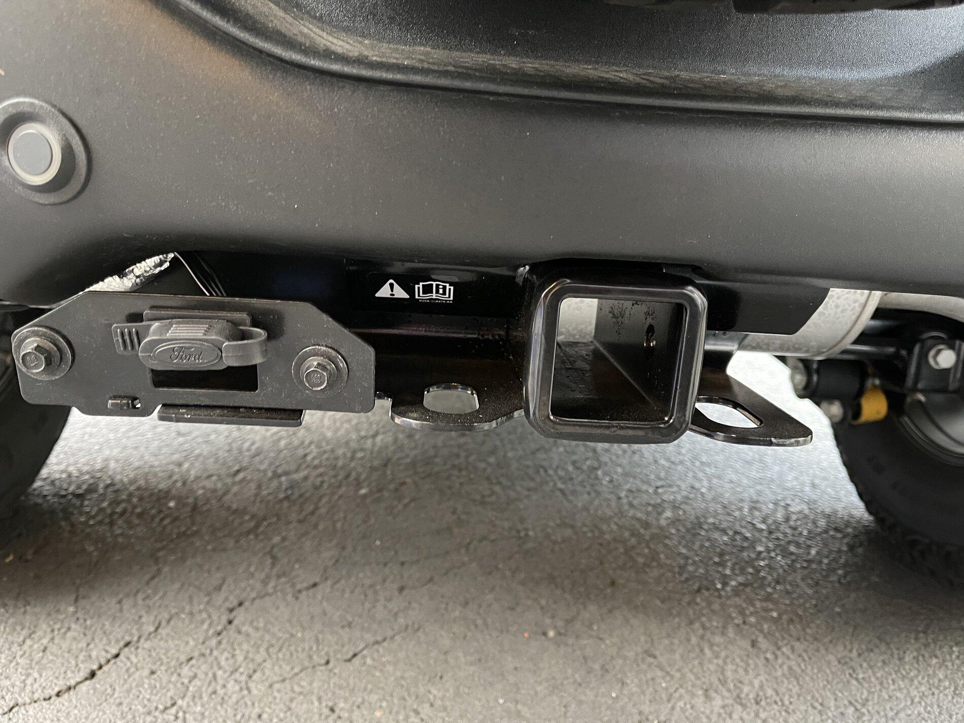

Negative. Class II
The only reason the OEM lists as a Class 2 is the factory tow rating of 3500#. They can’t sell you a hitch rated over the factory specs or they are implying you can tow more. If you look at the OEM hitch itself it’s easily a Class3. Replacing it is a waste of money.
