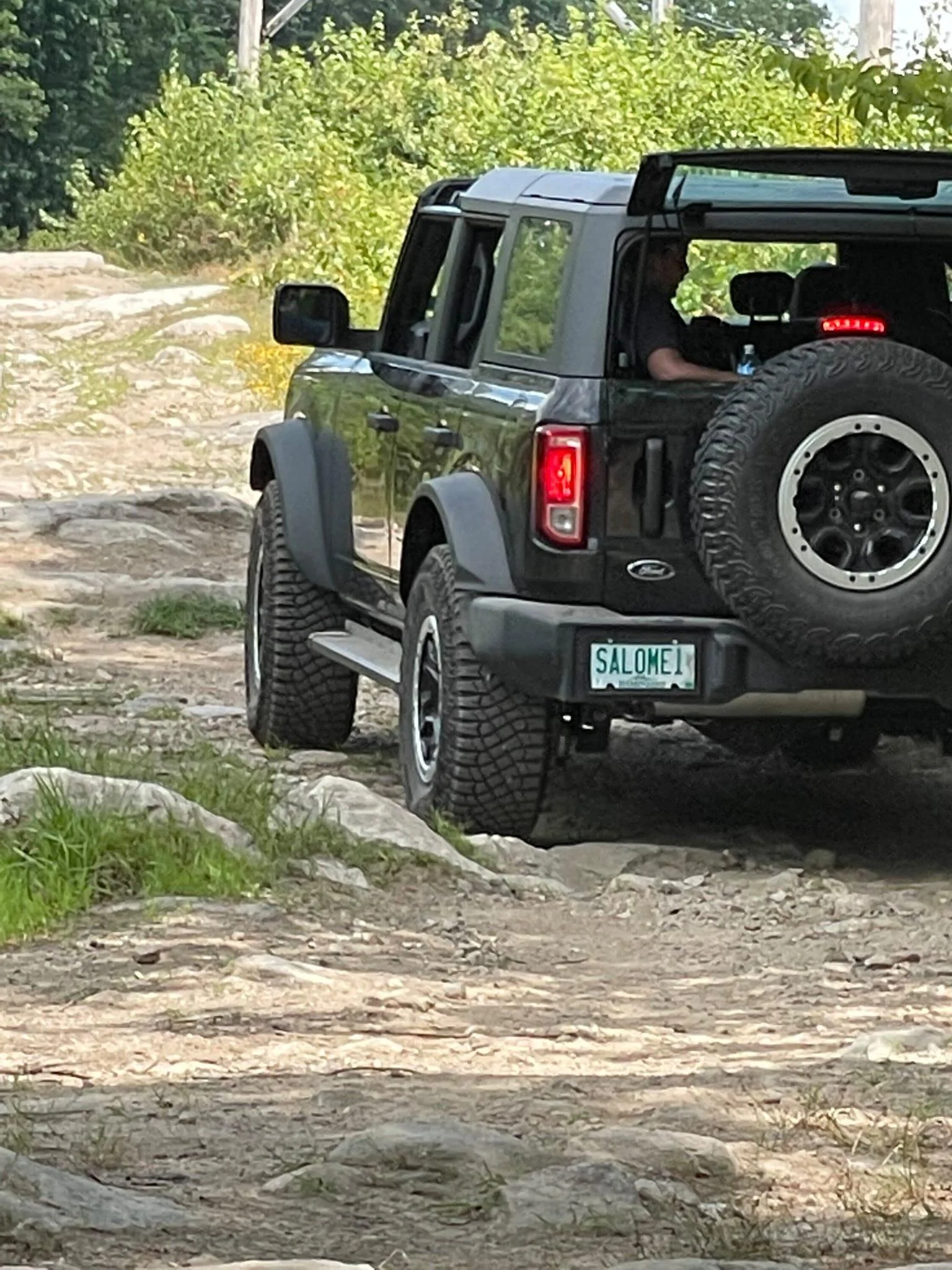

This would be my First and the Last 4x4 so I went with the Base Sasquatch and added running boards for my family. Only did one soft offroading this year and its mostly used for daily chores by my wife as I have travel for work, so far all I got is satisfaction.
at 5508 happy miles....
Ford Bronco Sasquatch seems like alot$ signal-2022-08-06-18-28-13-983-24
