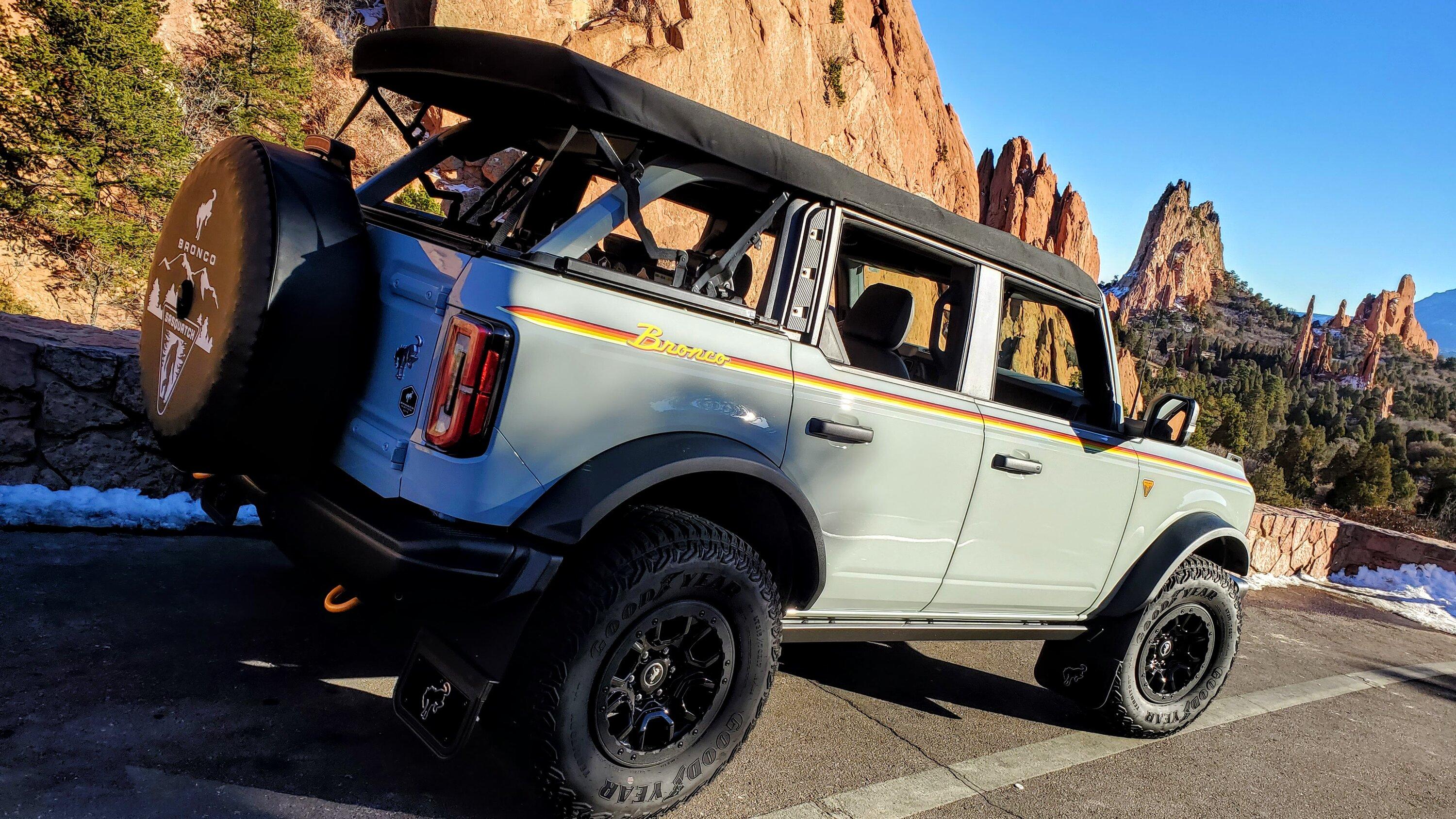

No wavy windows on my soft top! 😂 😂 😂
Ford Bronco 2023 Bronco Soft Top Window Seems Less Wavy D9563894-D826-46AB-96D1-3DE9633C13D4
I went from a 2 Door MIC top to a OBX SAS soft top so I can roll like this all summer. Looking forward to April so I can get Bronco out and start driving it!
