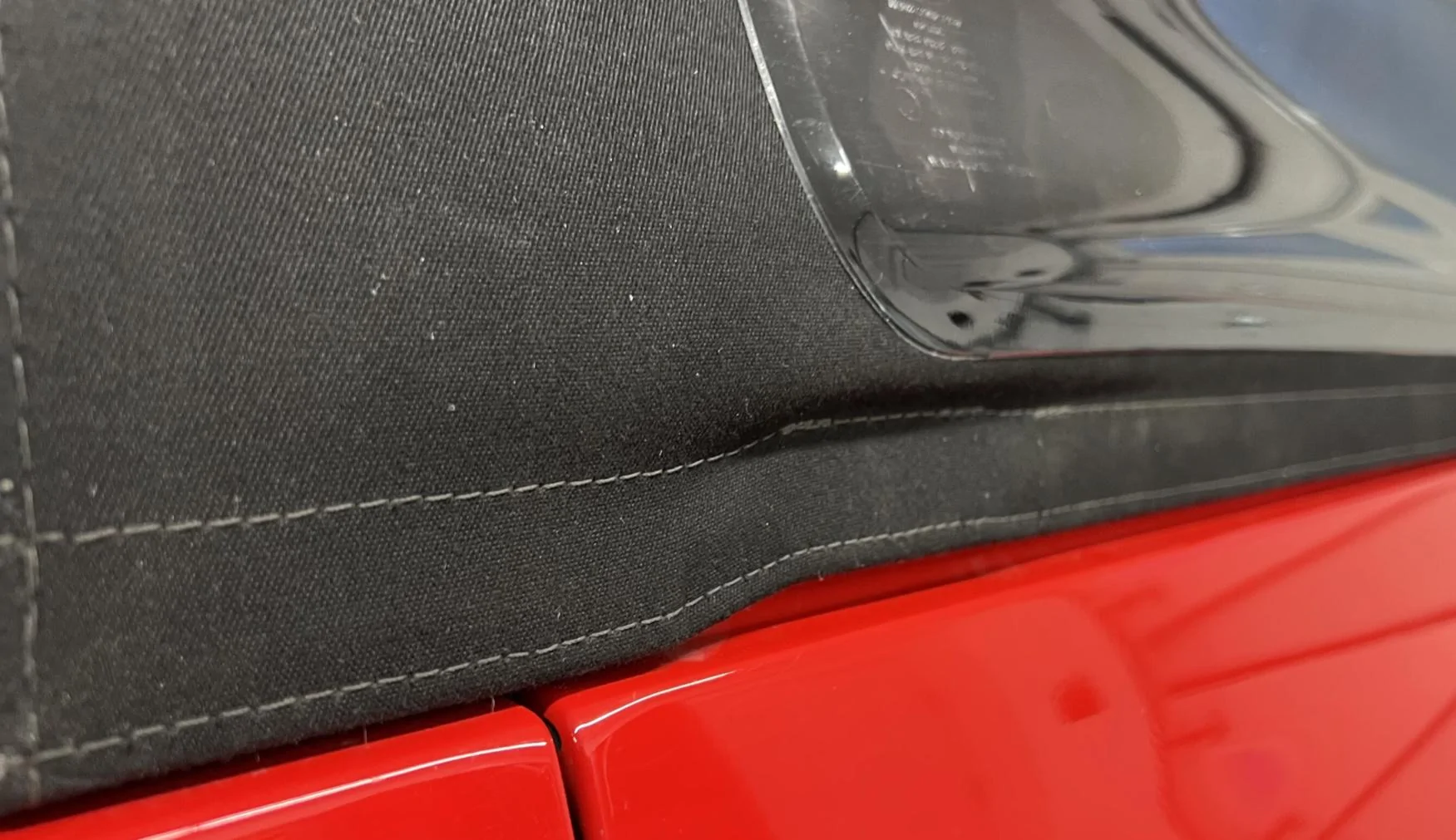

Thank you! 6 pages in and people don’t realize it’s how the windows are attached, not the windows themselves that cause the problem. Well, there was a person on page 5 that mentioned the rails, but still… :ROFLMAO:
It’s 95% the windows themselves. Maybe more. If they had used the same plastic windows used on BesTop tops, there would be zero waves. They’d be completely flat.
This is only 5% of the problem? No way the tracks of the window being at different heights could cause a major problem! Especially not when the higher track is directly under the plastic of the windows and not the fabric part. :ROFLMAO:

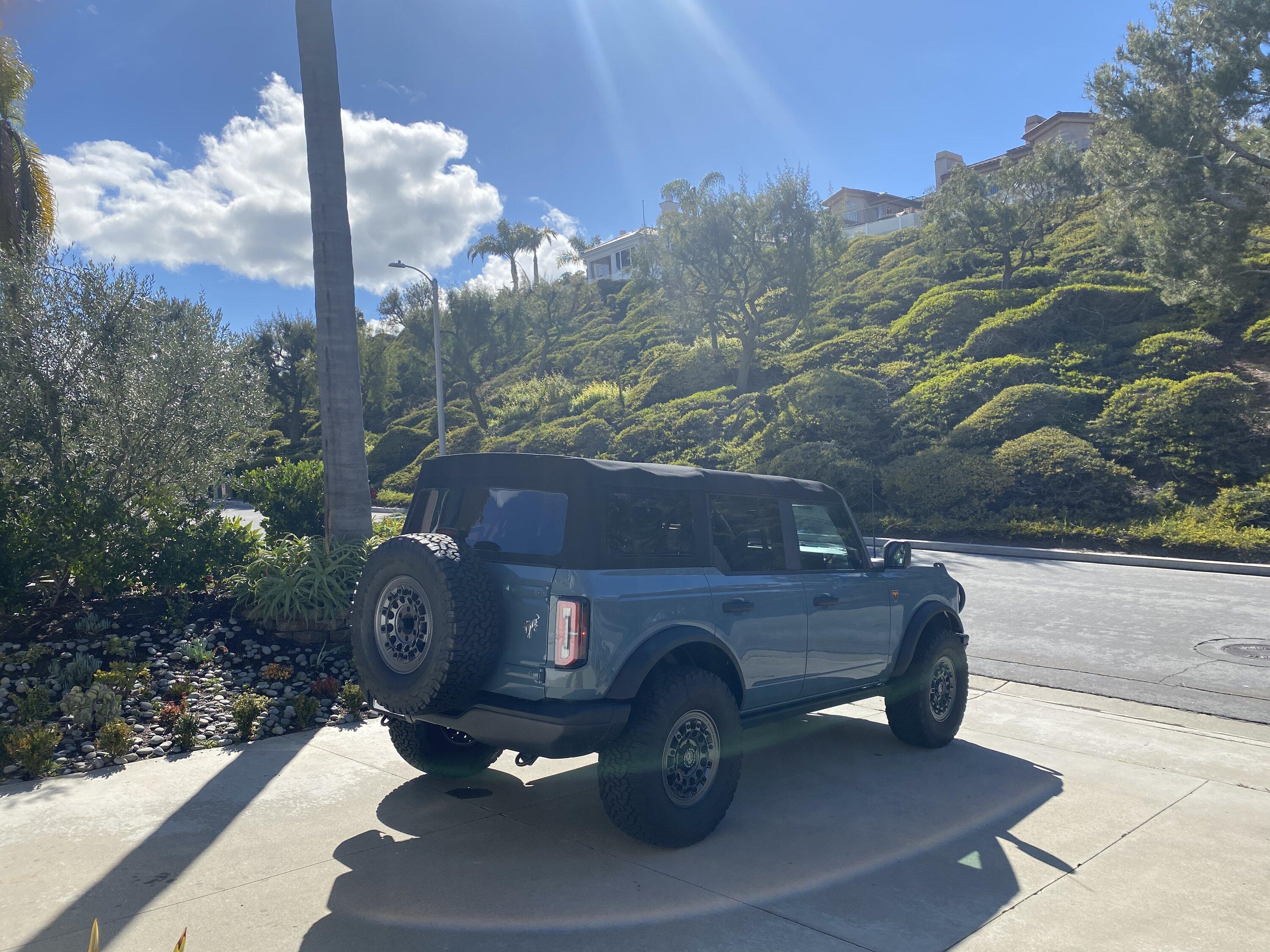

My OBX driver side pretty wrinkle free but one wrinkle passenger side.

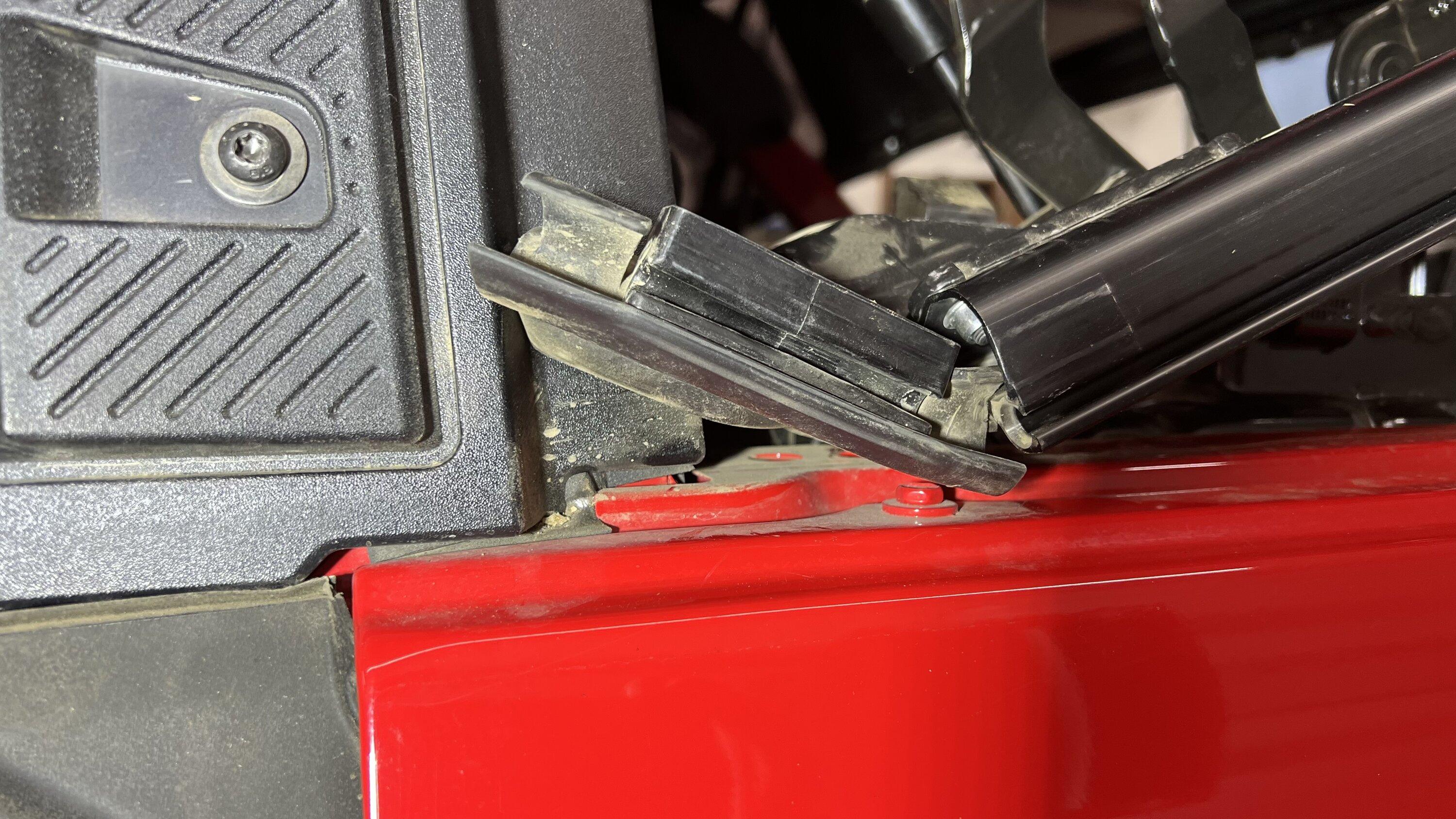

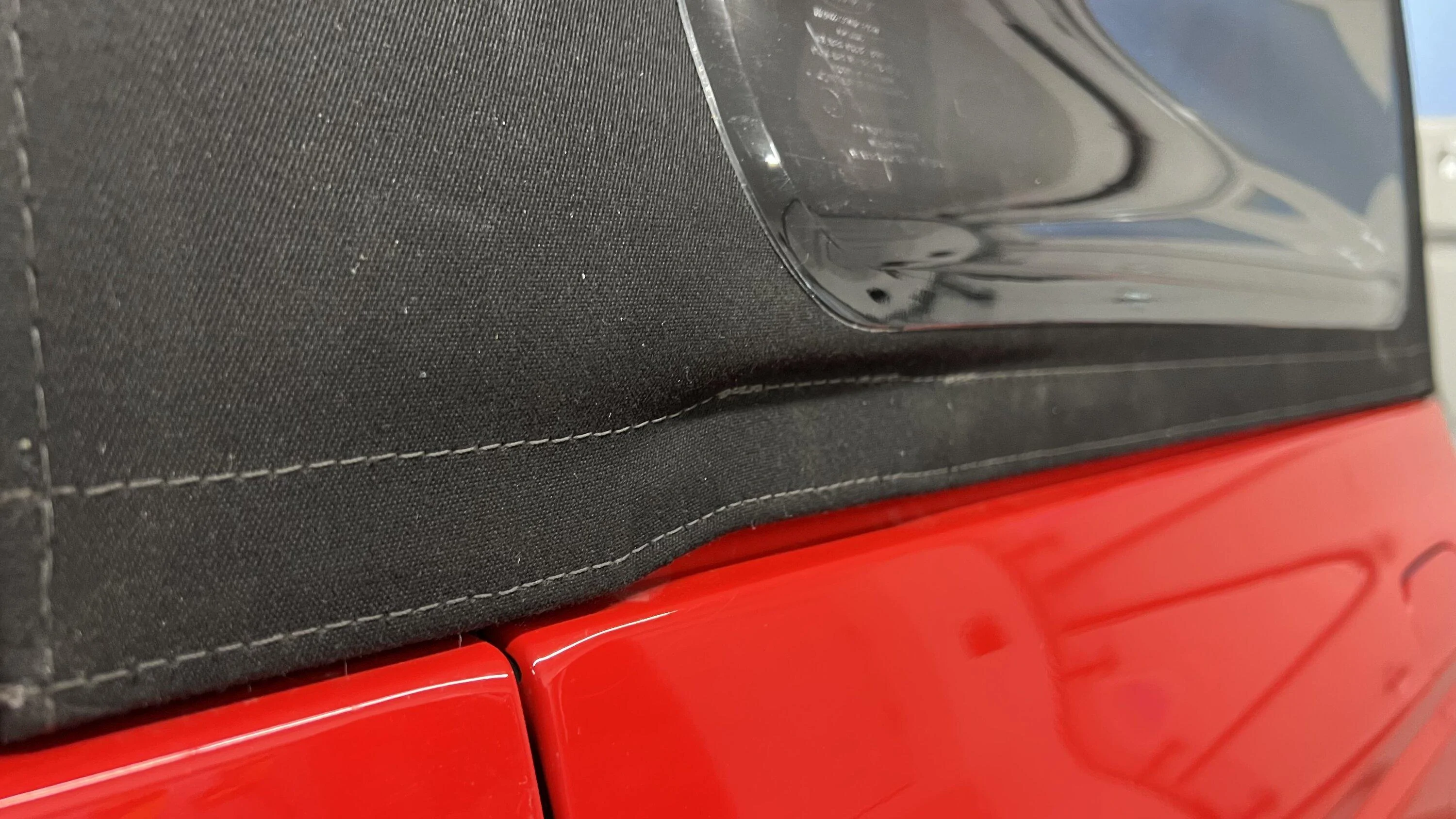

Did this part number change? To me, this is part isn’t designed right, it isn’t lined up with the rest of the rail and is too flexible. Might not be 100% the cause of the wave but it sure isn’t helping. Was considering modding it to move it lower to pull the window tight, leaving it alone for now.
Notice all the dirt under it, it wasn’t sealing either. I adjusted the soft top main bracket, had a little to give to bring the front down but still not enough.

Mine is exactly the same, the driver's side does that lil jump up but my passenger side is straight. I messed with that window after I got my Bronco trying to figure out why it does that.

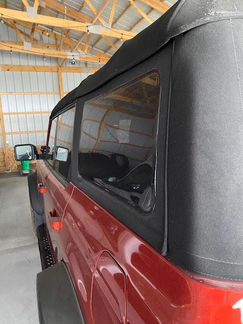

I ran a coax cable along the bottom of the side window and the frame to increase the tension to get rid of the wrinkles
