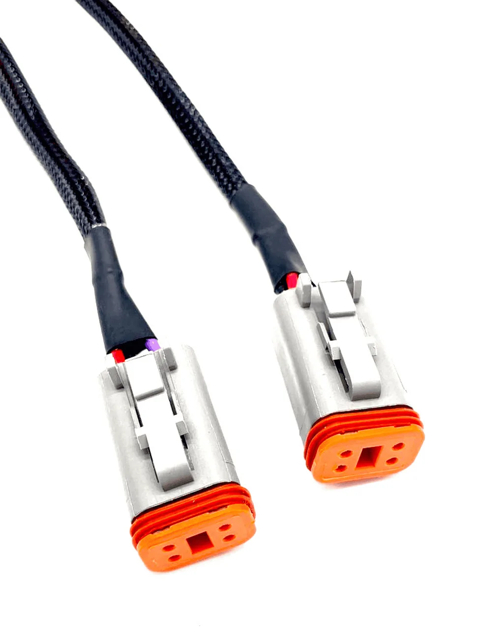

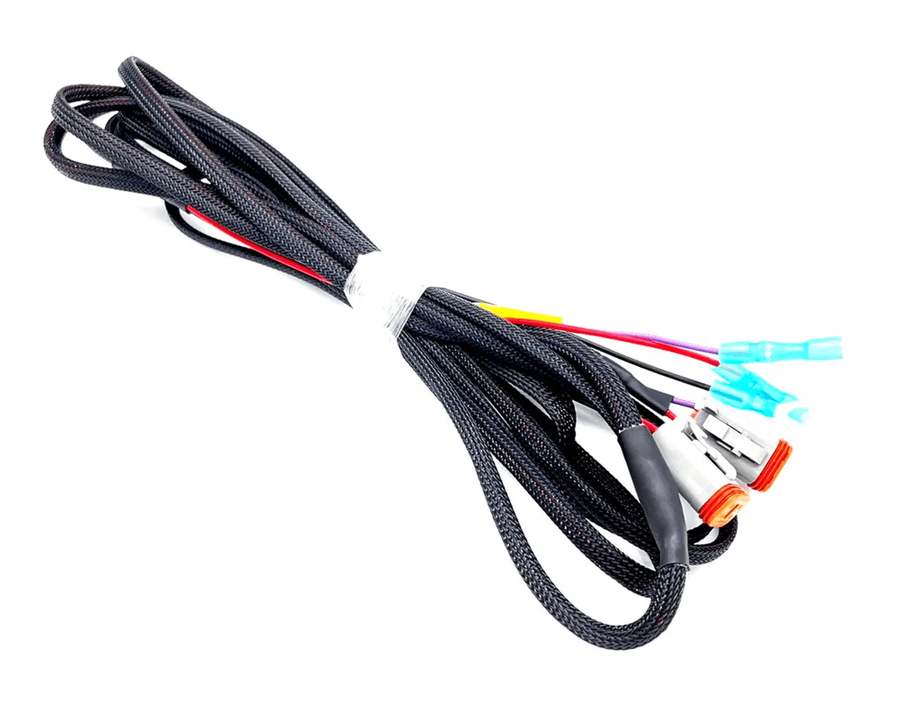

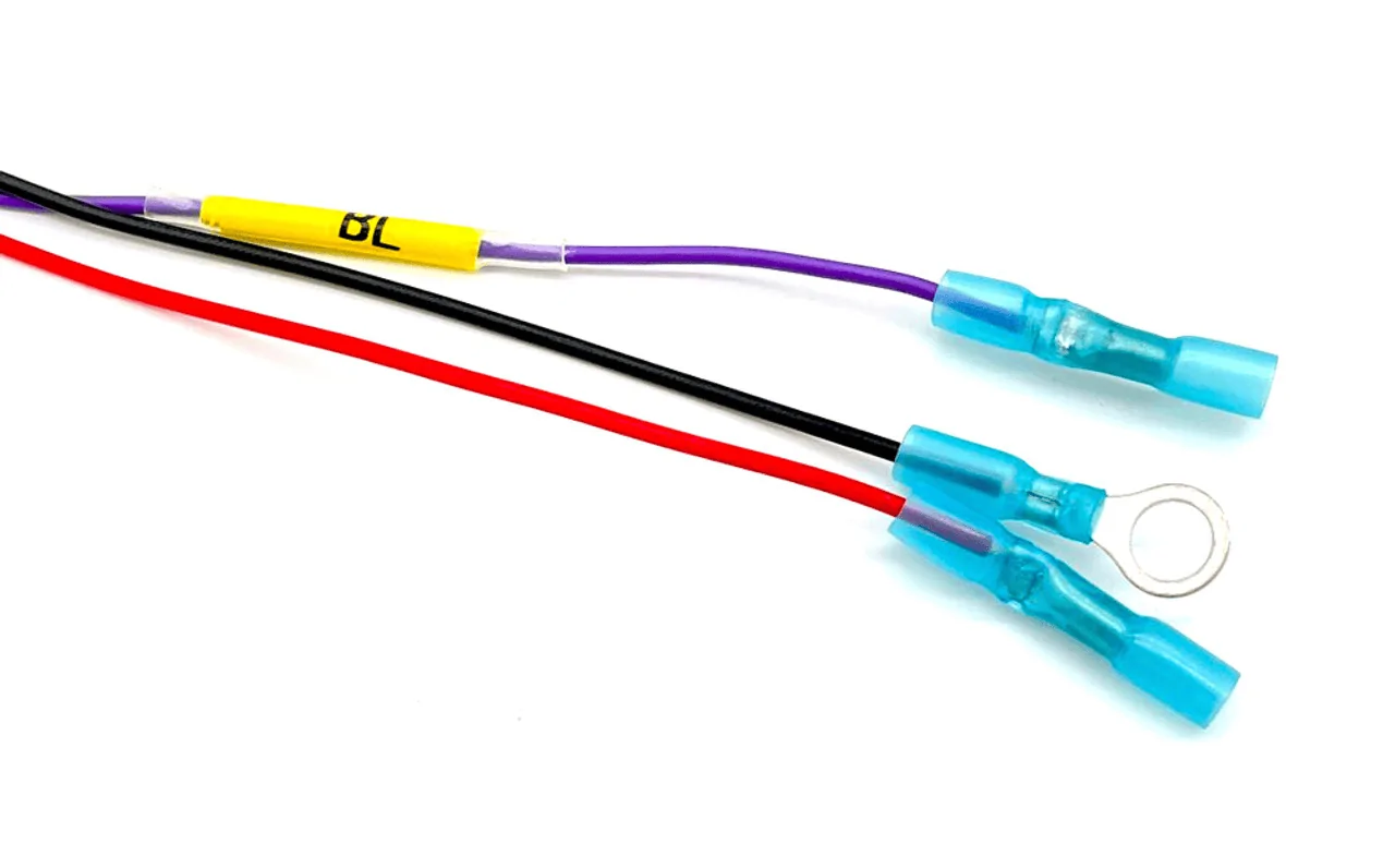

If you had ordered from us we provide a nice and clean upfitter harness. Really slick. We also include it free at no additional cost
https://www.4x4truckleds.com/diode-dynamics-stage-series-ss3-ditch-light-kit-for-2021-ford-bronco/
The harness Diode includes with their a-pillar kit is universal. It's a switched and upfitter style harness. Unplug the switch and plug the upfitter one in. It pulls power from the battery but I've never had a relay fall out.. This allows them to sell these to both styles of trucks. It's a lot of EXTRA wiring though of course since it's a relay harness (which is not required on trucks with upfitters).
They do that because it's easier to sell and it's pretty much standard for all their a-pillar kits. They just change brackets out for different trucks but the lights/harness stay the same).
We focus on Broncos specifically and all of our kits are specific to Broncos or F150s or other trucks... we have tons of harnesses that we've designed for various vehicles to make it as simple as possible.
Next time you need lighting or accessories, check out our website
Ford Bronco SS3 Diode Dynamics Ditch lights. 1706627046304
Ford Bronco SS3 Diode Dynamics Ditch lights. 1706627050588
Ford Bronco SS3 Diode Dynamics Ditch lights. 1706627054526

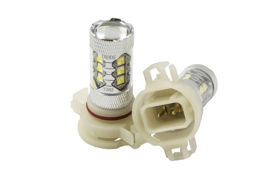

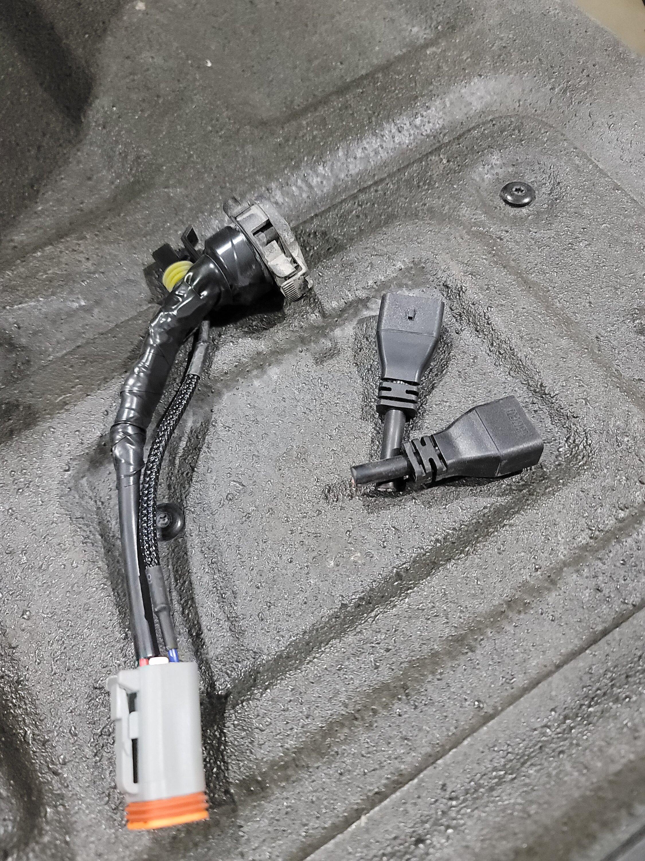

I just went through this with a vehicle-specific SS3 Pro kit DD7031 for my LWN. I probably have 14 different sets of Diode Dynamics lights, so I'm very experienced with their product line.
The "5202" OEM fog light plug supplied with DD's harness was absolute trash. In no universe would it seal the plug and hold it at all. Even with tape, it would have pushed out or vibrated loose.
I had to raid and chop the expensive Morimoto 2-Stroke 3.0 LEDs I was replacing for a 5202 connector that actually fit and held.
Ford Bronco SS3 Diode Dynamics Ditch lights. 20240112_180629[1]
This is unusual, because DD knows exactly what style plug to use for a 5202 as their SLF OEM replacement fog light LED uses the correct connector, the same way that the old XML2 5202 LED did prior to it's discontinuance.
Ford Bronco SS3 Diode Dynamics Ditch lights. 1706655560310

In Diode Dynamcis defense, 5202 is a TERRRRRRRRRRIBLE bulb size. It's not their fault. It's just TERRIBLE to work with. I've personally gone through 3 different kinds over the course of our own CrystaLux LED bulbs and every single batch had a slightly different style. They are HORRIBLE. Worst bulb in the history of automotive bulbs if you ask me. They just DON'T work right.
Those are popular on the Mopar vehicles, especially the fogs. They ALWAYS come loose. No matter what brand.
