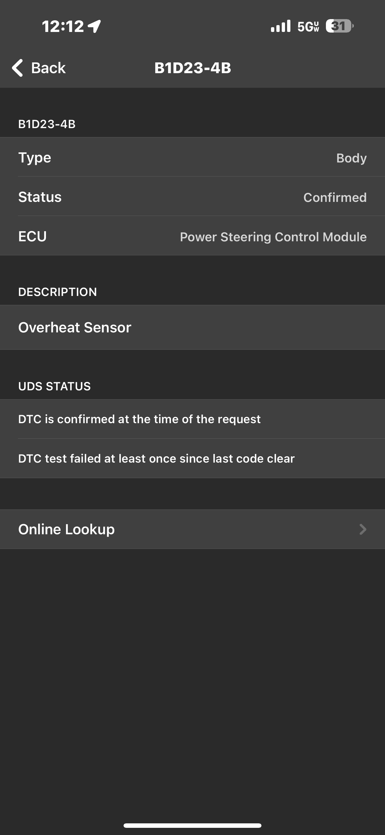

I think you are absolutely right. Just pulled codes. I didn’t get any dash lights while it was happening, but I have an overheated steering box code.
Ford Bronco Steering impossible while off-camber EEAB882A-9925-4BD3-8F4B-D5031EFF946F
My best guess right now is my power steering over heated due to over working it on the 9 rated trail. The larger tires/lift are likely causing it to work harder than normal due to increased friction against the bushing and maybe even the housing, as BroncBuster has found in extreme use cases.
This leads me to believe that just doing the BroncBuster stuff isn’t going to entirely fix this..

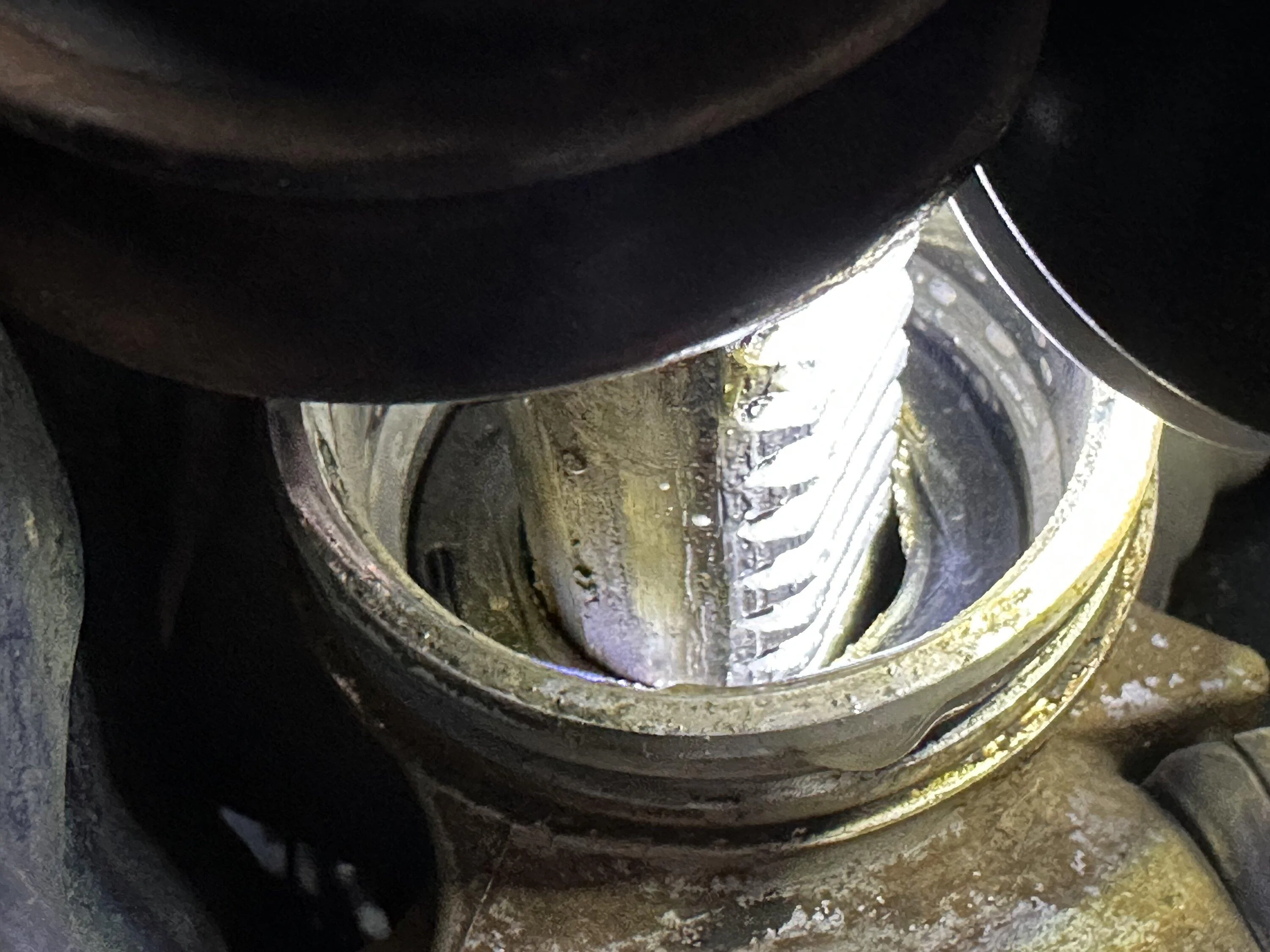

Yep. Pic 3 is one of the times steering was nearly impossible in either direction. Normally I would expect overly easy steering when turning downhill and a bit of resistance while turning uphill.
I went out and pulled the steering boot on the driver side and as expected, there is wear on the bushing. It appears the rack is flexing which caused the teeth to engage on the bushing, making turning incredibly difficult. That would explain the behavior.
BroncBuster Is correct in his thoughts behind the bushing replacement, but I guess not all cases present the same. What’s interesting is this problem originally started when I was on the factory 35s, so I’m not sure how much of that wear is recent.
No metal shavings, which is good. Just some contaminants from the factory boot not being completely water tight apparently. That bushing is chewed up near the teeth though.
At that angle not moving that is a lot of weight for that rack to not just turn the wheels but also move the Bronco. Even if it was a box on frame it would be the same without ram assist to help.
