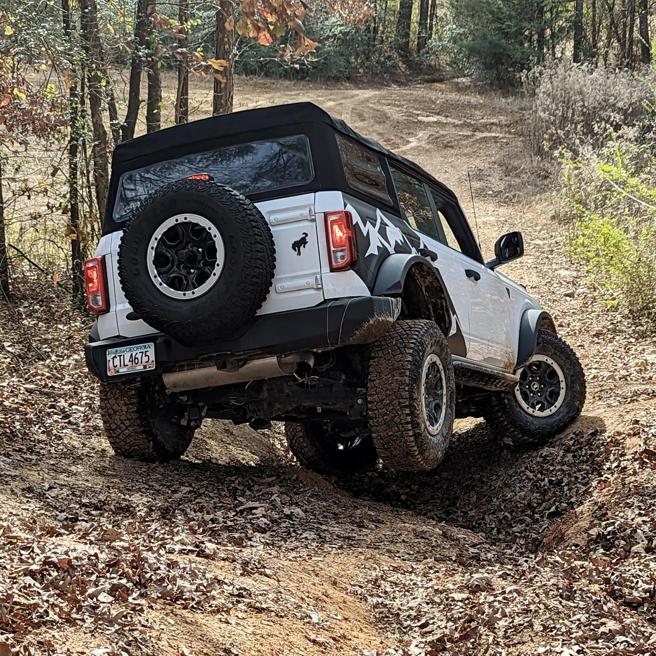

Not sure if it’s the same thing, but my steering locked up the other day going down hill, teetering on my corner tires. I did not fight it, backed up to get the weight off the front passenger tire and it straightened right up and I took a better line
Yes that is it.
In the pic to get the RF tire to turn it would need a awful lot of force. It is just not meant to do it.

Yes that is it.
Bummer. I hope this locked steering & broken racks doesn’t become a widespread thing. My Tacoma (IFS) on a 3” extended travel coil over kit / UCA / whole 9 yards / on 35’s did this kind of move without issue for years. So if this binding issue becomes more common it’s a Ford thing not an IFS thing.
