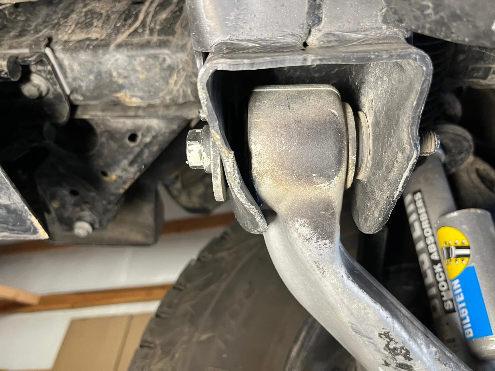

And installed. Not proud of these welds in any capacity. Doesn’t help that I don’t know shit about welding,
meh - the paint coves the welds up nicely ;)

And installed. Not proud of these welds in any capacity. Doesn’t help that I don’t know shit about welding, but to compound the badness whilst laying on my side the sunlight coming through the mask acted as a mirror, so while trying to see what I’m working on all I see is my stupid confused face staring back at me 🤦🏼‍♂️

As someone who has the love hate relationship with this site, reads things, and then worries he too has the issue he read about .... where and how do we check for this?
Seems pretty clear if you know what a lower control arm is and where it is bolted to the frame. Crawl under and you will see.

Well, you can still see the "ears" even with no damage. I presume Dan just want to see the mounts and perhaps look at the Barnes product to reinforce them.
