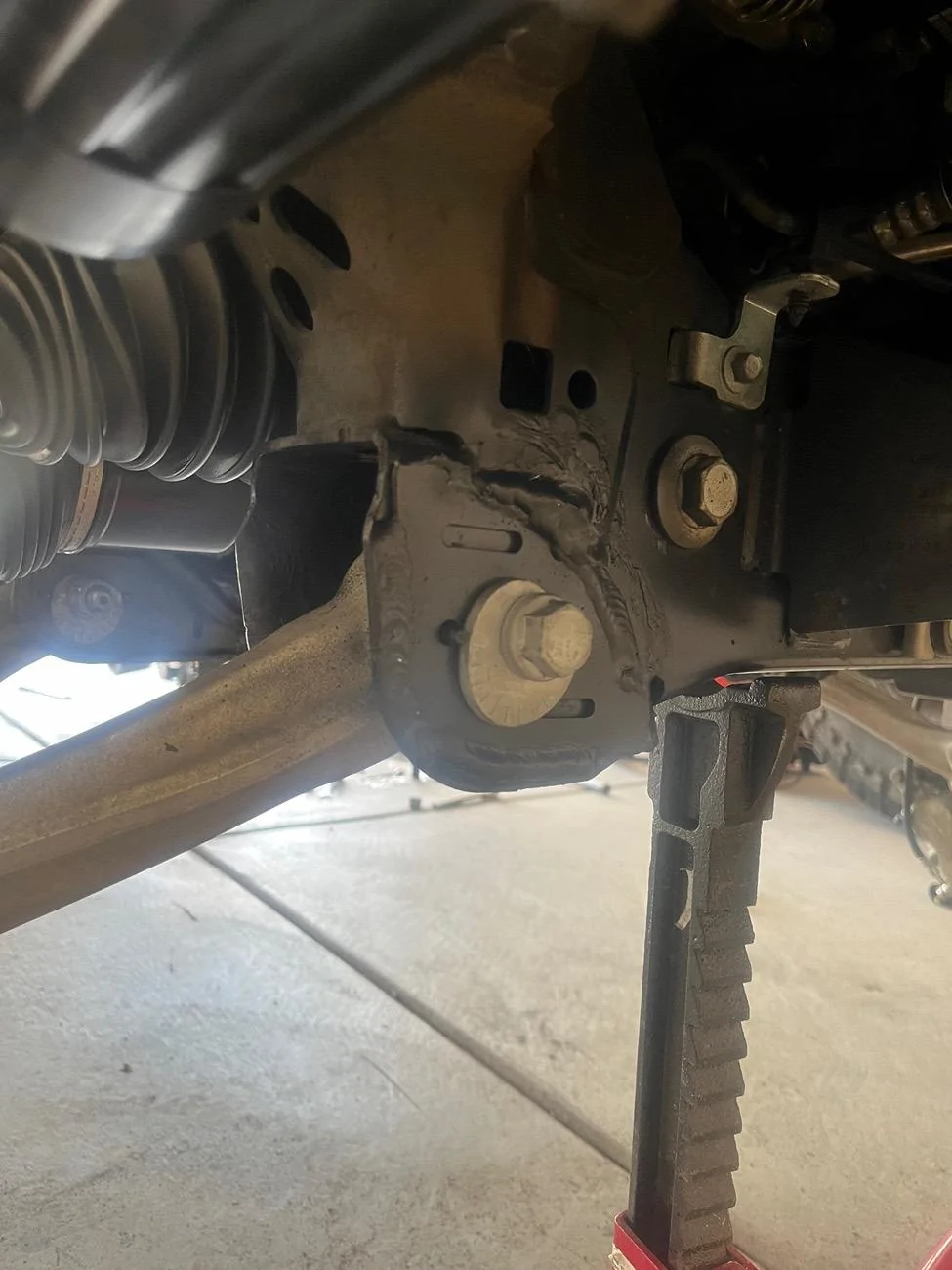

And installed. Not proud of these welds in any capacity. Doesn’t help that I don’t know shit about welding, but to compound the badness whilst laying on my side the sunlight coming through the mask acted as a mirror, so while trying to see what I’m working on all I see is my stupid confused face staring back at me 🤦🏼‍♂️
Does anyone else get super worried about welding on these new rigs and disconnect both battery terminals plus all the ECU connections then keep the ground as close as possible to the work? Might be overkill but I just don’t want to fry something
Curious...did you disassemble and pull the arm or try to slip a given bolt through the reinforcing plate, leave it unseated, weld/grind/paint and then pull everything tight. Just thinking about cooking the bushings if the arms were in place.
I assume you mig welded too, yes? The only better way to do it due to the high strength steel Ford uses would be to tig and minimize the heat affected zone. The key is to minimize excess heat but still obtain adequate fusion.
Pulled the arm for the exact reason you mentioned. Ran the bolt back in to keep alignment and used big clampy style vise grips to snug everything down. Used the old bolts and threw new ones in when we reinstalled the arms.
Did use mig, but more out of convenience and not knowing how to tig 🤷🏼‍♂️

TIG is super easy, find a TIG machine and try it sometime, it won't take long to get the hang of it. The lack of splatter alone makes it so worthwhile. It's way slower than MIG, but I love the control. Surprisingly, I found it easier to manage the heat affected zone with MIG if you have that as a goal.
