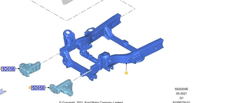

MB3Z-5019-N is going to be about your only option as far as part is concerned, short of the full frame.

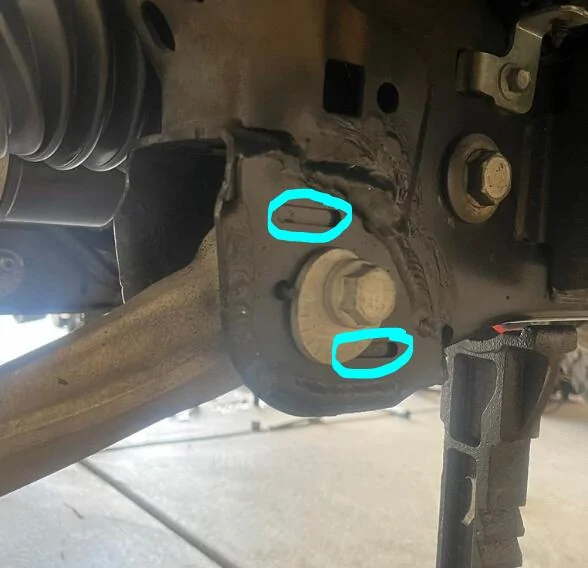

And installed. Not proud of these welds in any capacity. Doesn’t help that I don’t know shit about welding, but to compound the badness whilst laying on my side the sunlight coming through the mask acted as a mirror, so while trying to see what I’m working on all I see is my stupid confused face staring back at me 🤦🏼‍♂️

looks good! dont forget to weld these slots also and grind flush, much of the peel strength comes from those slots.
Awe man. I filled those in on the first one then needed to grind them down so as not interfere with the alignment bolts. Started thinking I was over complicating things by filling those in and didn’t do the rest. 🤦🏼‍♂️
