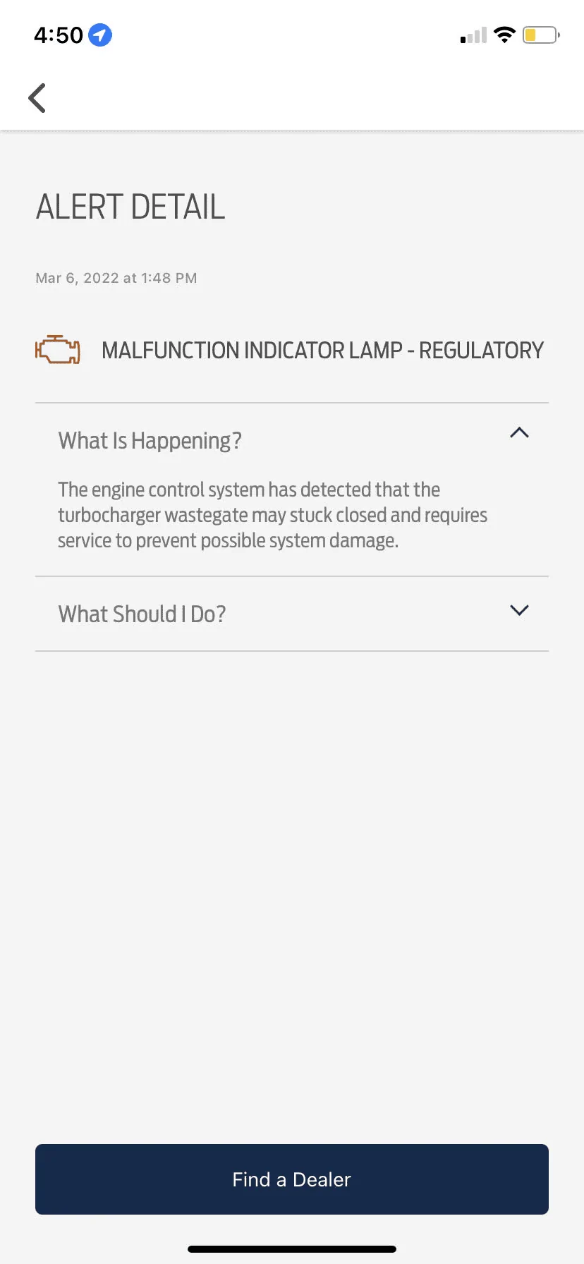

Wastegate stuck closed sounds very possible and also would match the driving symptoms, if a gate is stuck close it would build max boost and blow the motor but it caught it and is now dumping boost and not building any (guessing). Honestly you guys are like the mob grabbing pitchforks for 2.7s when this doesn’t seem to match up to dropping a valve or blowing a motor at all. Besides when most 2.7s go they shut down and cannot be driven home.
Yeah I was able to get it home (about minutes) after the issue started, but haven’t driven it since, and won’t. Hopefully it’s not the blown engine but we’ll see!
You’re probably right. No way the Ford intern would’ve responded with support if it was a blown 2.7.

I had the same error pop up on my Bronco/Ford Pass app this weekend. Took delivery on Saturday and it happened on Sunday, after about 50 miles on the engine. I have a 2.3L Manual Badlands 2-door, non-Sasquatch. @Ford Motor Company
Sorry to hear yours happened day one!! And with the 2.3L! Were you able to get it right back in, or are you playing the waiting game like I am for an appointment?
It’s going in on Thursday
