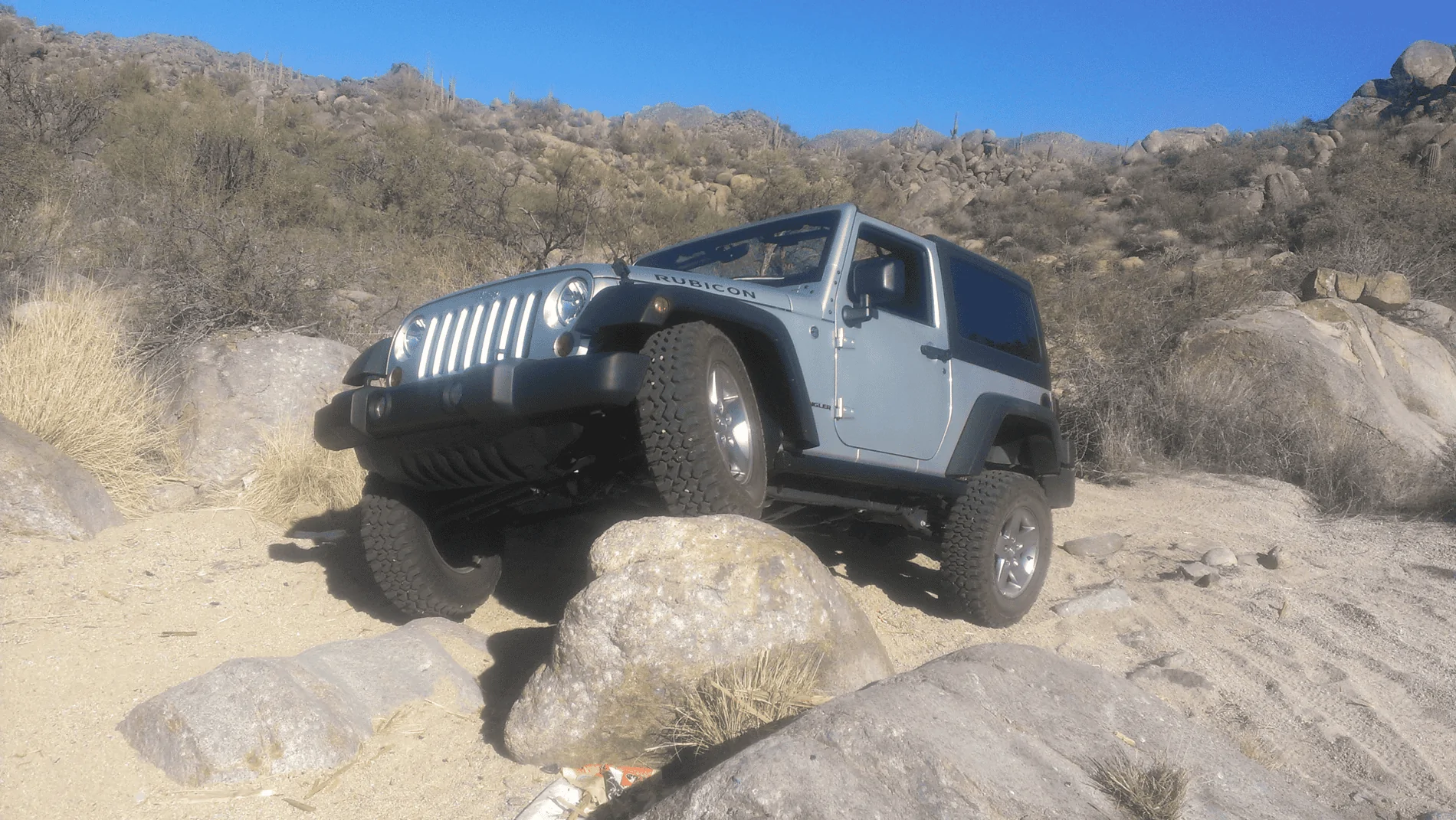

Are you saying that if, let's say, a Honda Civic is a 1 and a Jeep Wrangler is a 10, you'd put something like a 4Runner TRD Pro at a 5?
EDIT: This is talking about stock form, not taking modification potential into account (as that has a separate category)
Yes, 5. 10" of wheel travel is a joke for rock crawling. You're not doing this in a stock rig.
