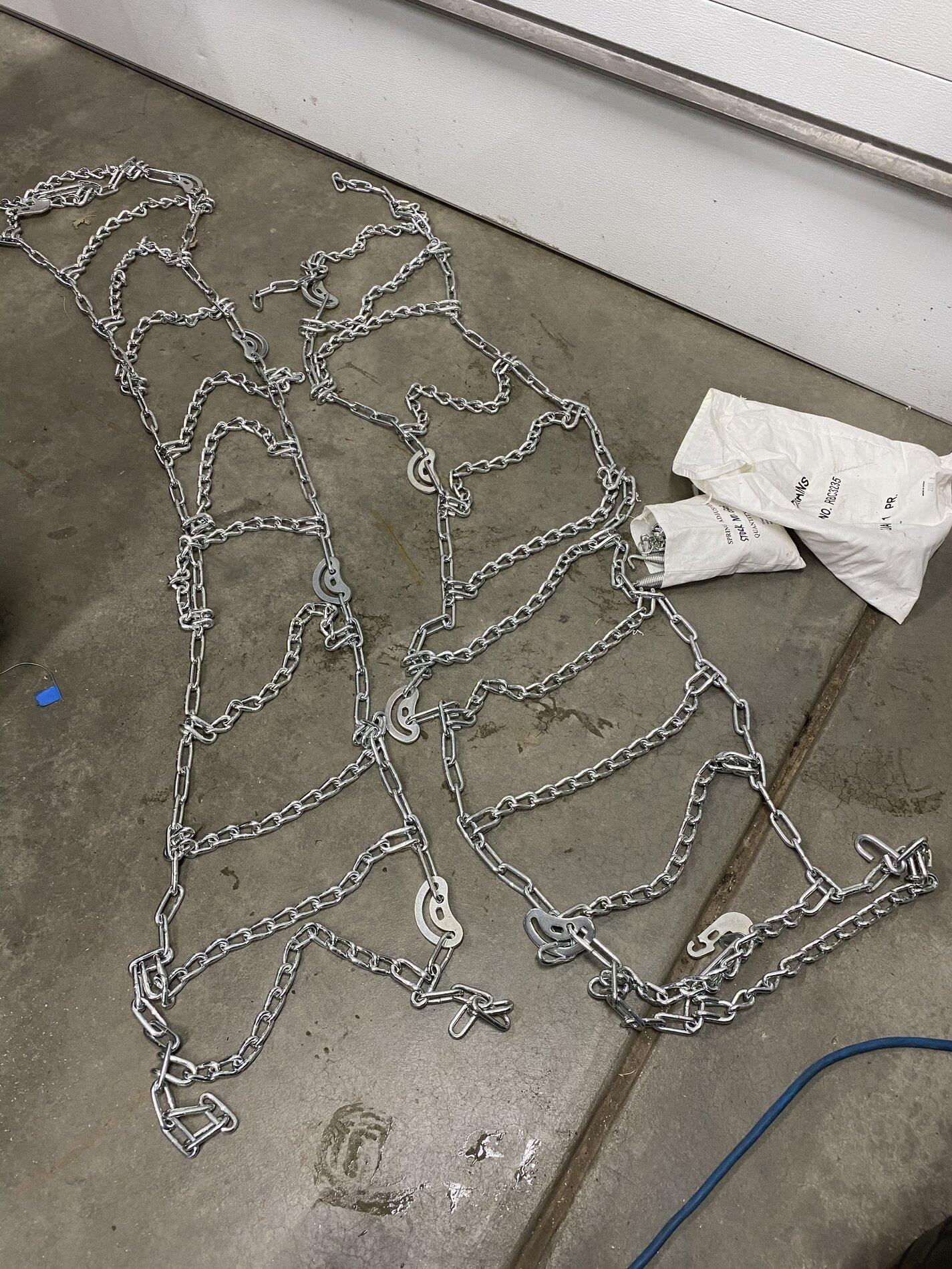

Just picked up the first pair of tire chains for 37” tires. Next set will be v-bars. Tires and wheels will be ordered soon. Probably should decide at some point FE or BL.... :)

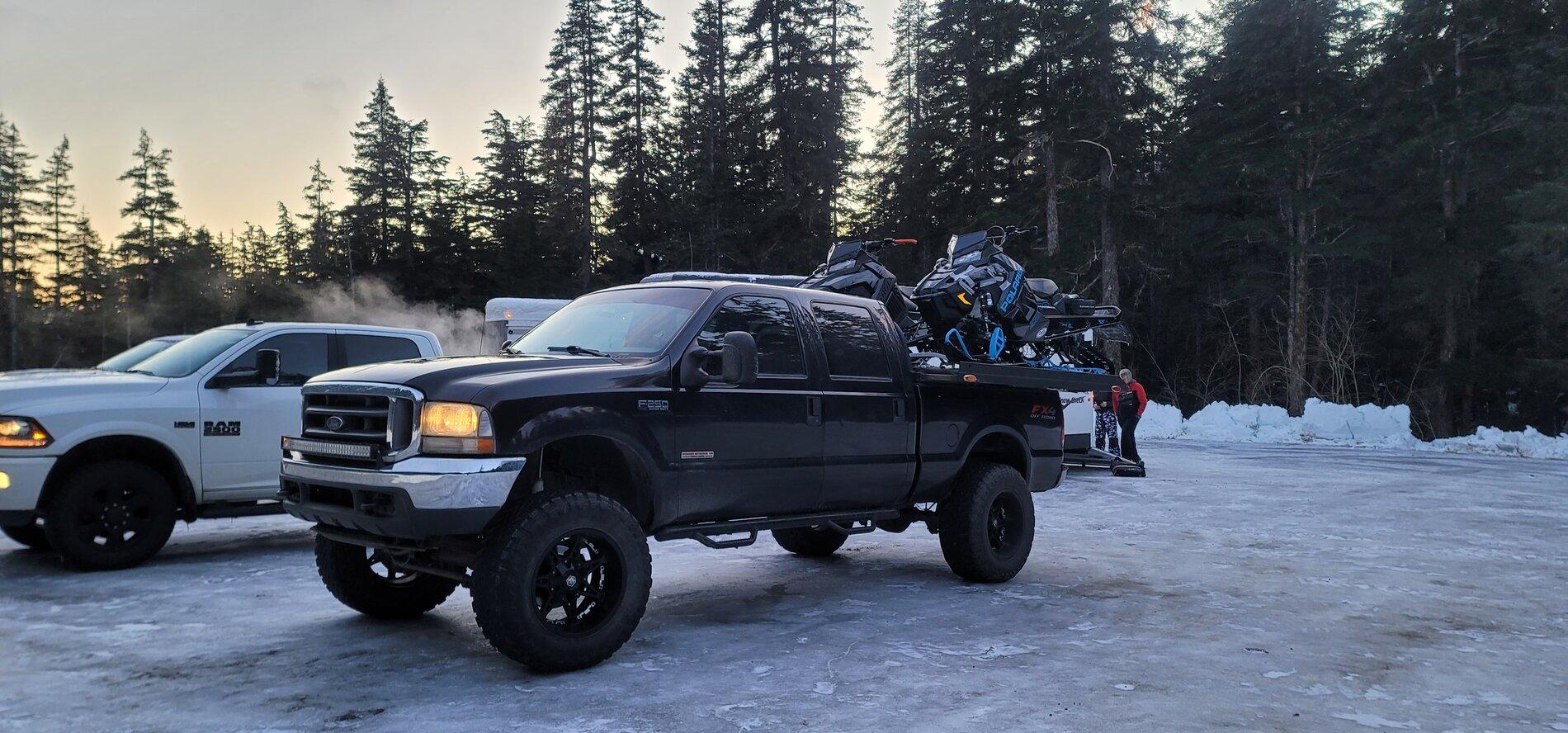

Man wtf are you planning on getting into that you already bought chains. I don't even run studs haha
Ford Bronco Tire chains purchases begun 20201204_154327
I was in Big Bear, CA once and they had a mandatory chain up. Alternatively, I think if you had tires with that snowflake symbol you were exempt, but everyone else needed to put on chains. Think other areas have the same deal if conditions warrant it.

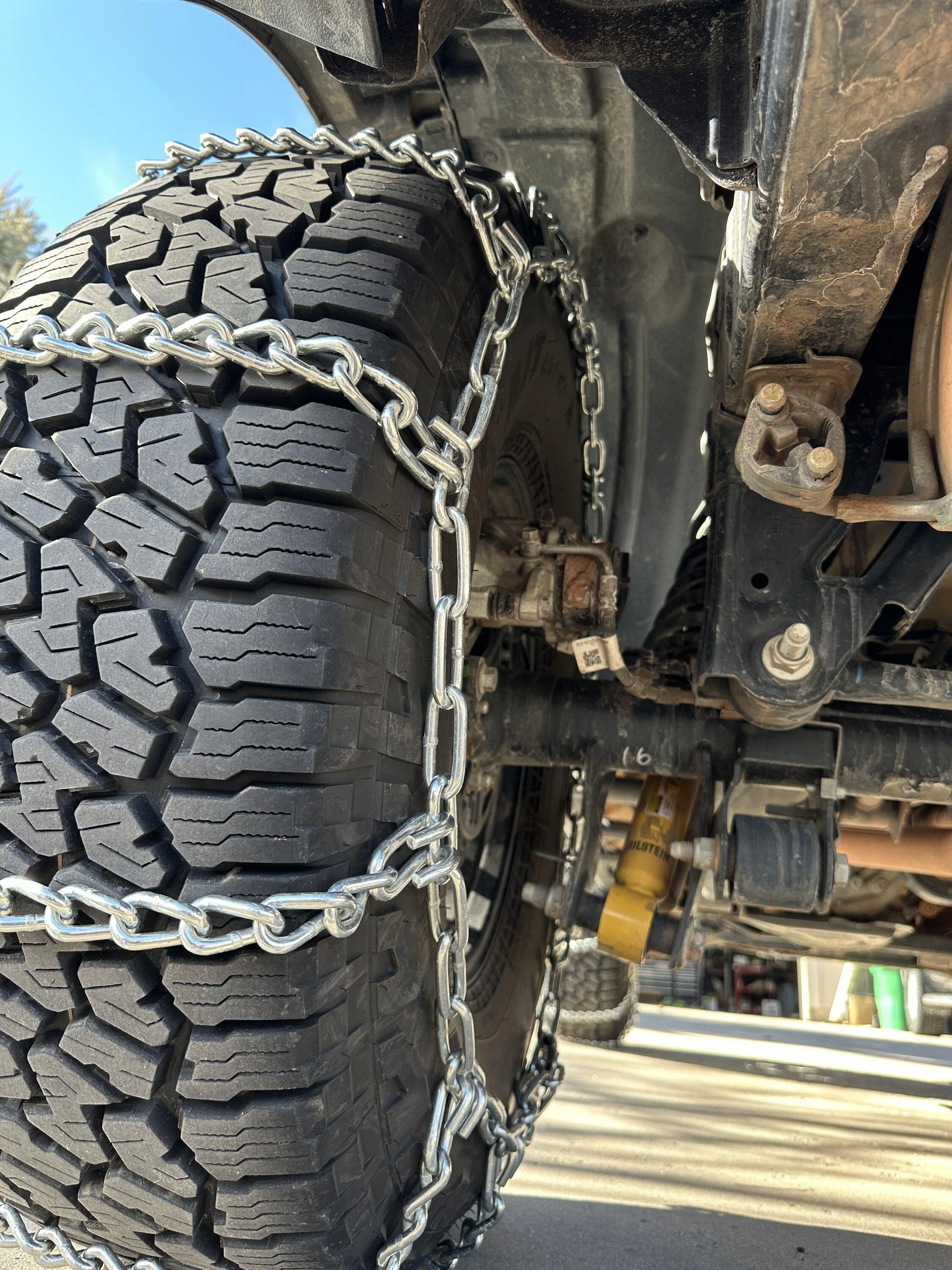

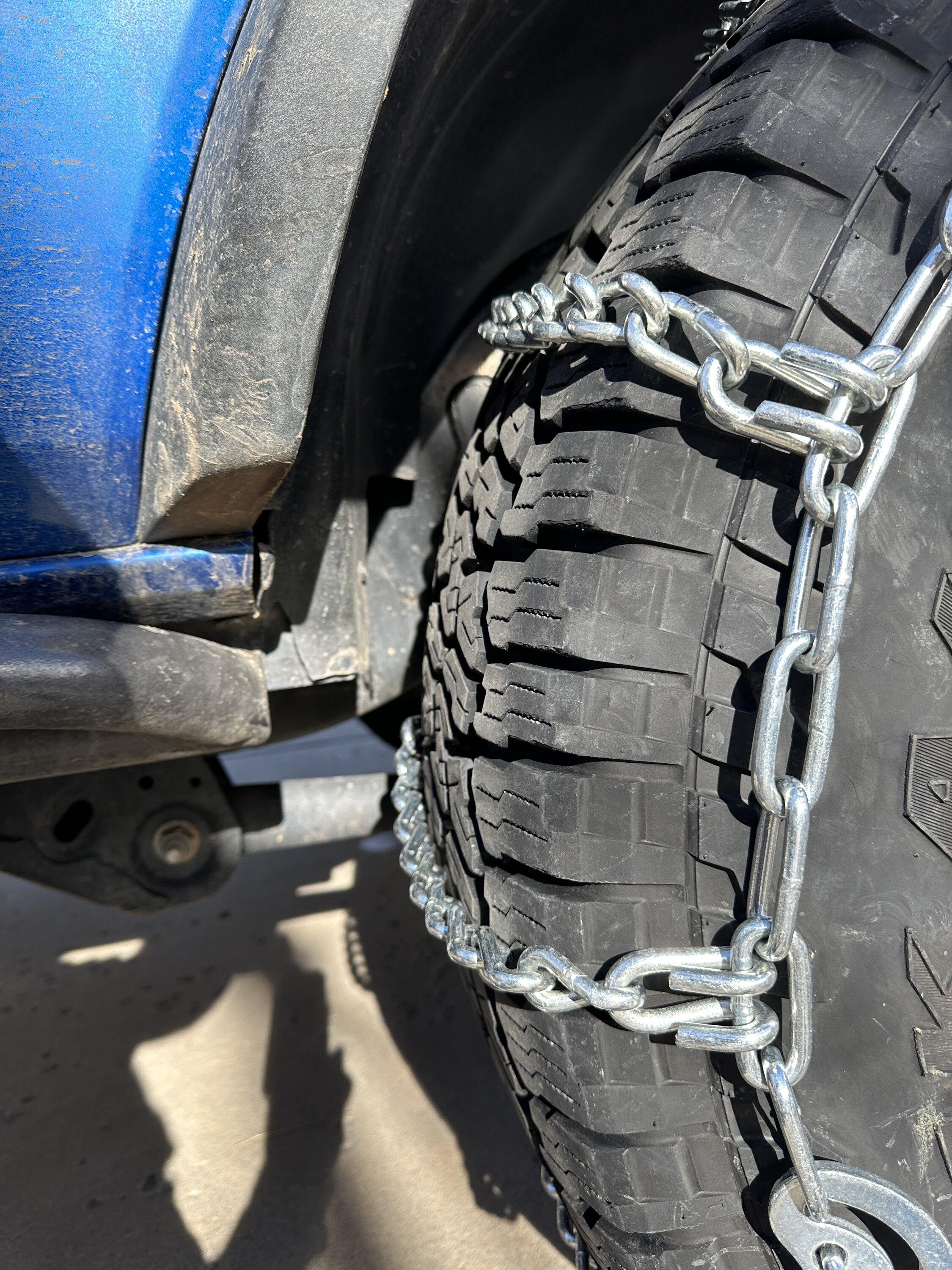

Here are some pictures of the tire chains with an Icon 3" lift and my 37" tires, and Method 0-offset wheels. Plenty of clearance for the chains to the control arms now. A 1.25" spacer would work just as well if keeping the stock wheels or near-stock offset.
Ford Bronco Tire chains purchases begun IMG_3072
The chains will get pretty close at max compression. I am adding an inch of lift to remedy that soon.

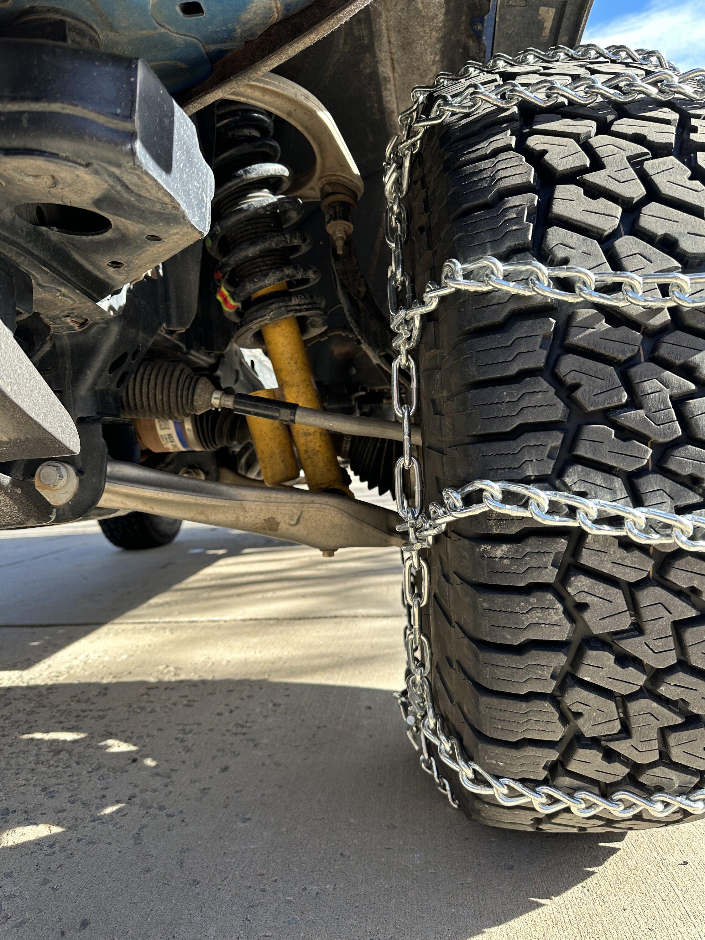

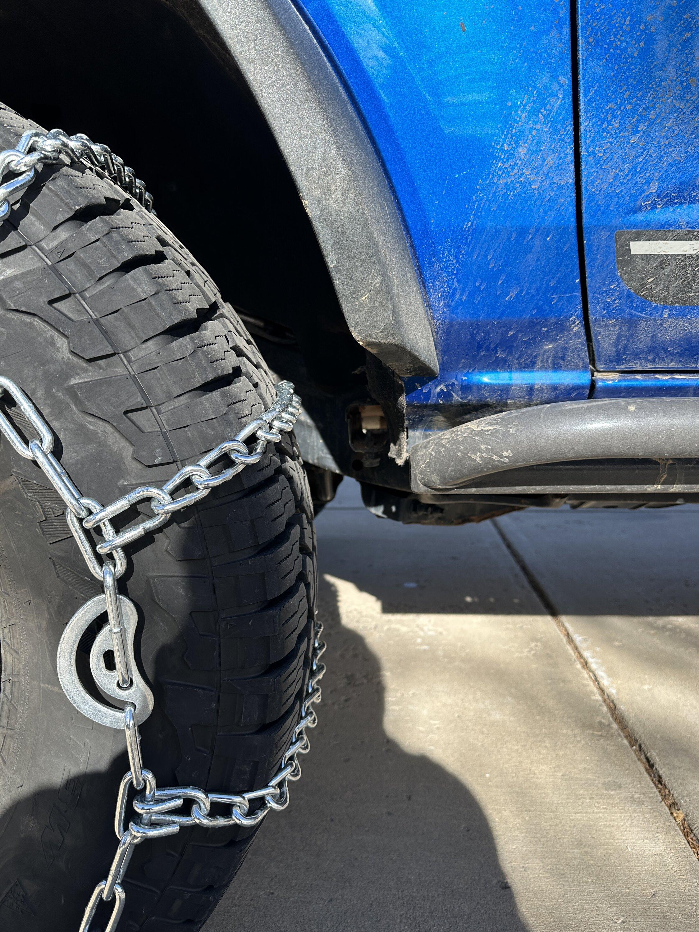

Here are the rear:
