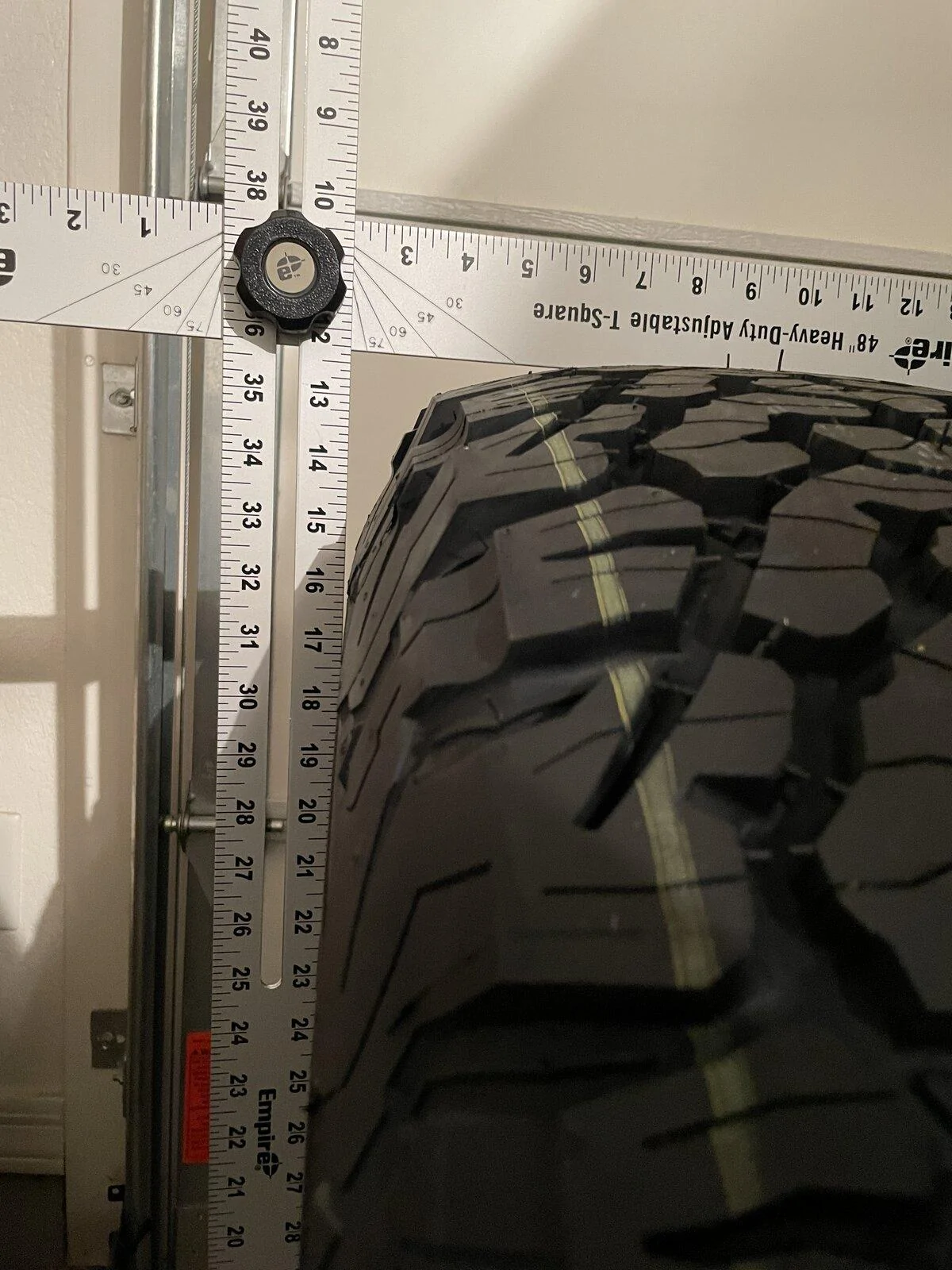

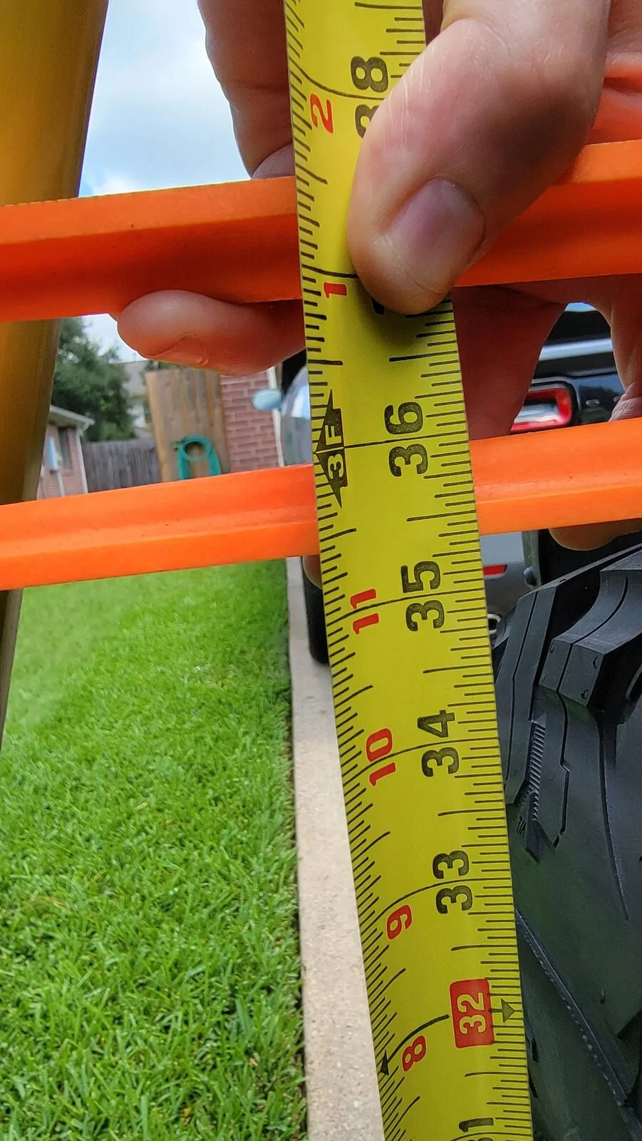

My BFG 37's measure exactly 35.5 inches on the car but I only put 36-38 psi in them, so maybe that make them squish more?

37x12.5x17 BFG KO2's Load Range C on 2019 JLUR that weighed 5700# empty on 17x8.5" wheels.
UNLOADED:
Ford Bronco Tire Size Question w/ K02's K02 - Unloaded (1).JPG
LOADED:
Ford Bronco Tire Size Question w/ K02's K02 - Loaded (1)
UNLOADED:
LOADED:
Ahh maybe loaded is what folks are referring too? That is an inch under rated size. Maybe the side walls being c rated causes more loaded sag than the others.
That would explain everyone saying the are are shorter.
Thanks for those pictures
CarbonSteel
Dec 11, 2020
672
1,095
Colorado Springs
2023 Carbonized Gray
That would explain everyone saying they are shorter.
Keep in mind (and others may have already said this) that no tire matches the advertised size--at least in my experience. With that said, BFG tires are even shorter than most and thus why they are not even close to advertised size.
LRC does allow for more flex, but it was only 3/8" difference between unloaded and loaded or a delta of 3/16" in height. My JLUR was heavy and I thinking that LRD would have had about the same difference.
I went with LRC to keep the unsprung weight down because some of the 37" tires are stupid heavy. Here is a spreadsheet that I did back in 2021 that is likely dated on pricing, but the specs should be the same. The baseline was the 285/70/17 (33") tires that came from the factory on my Rubicon.
