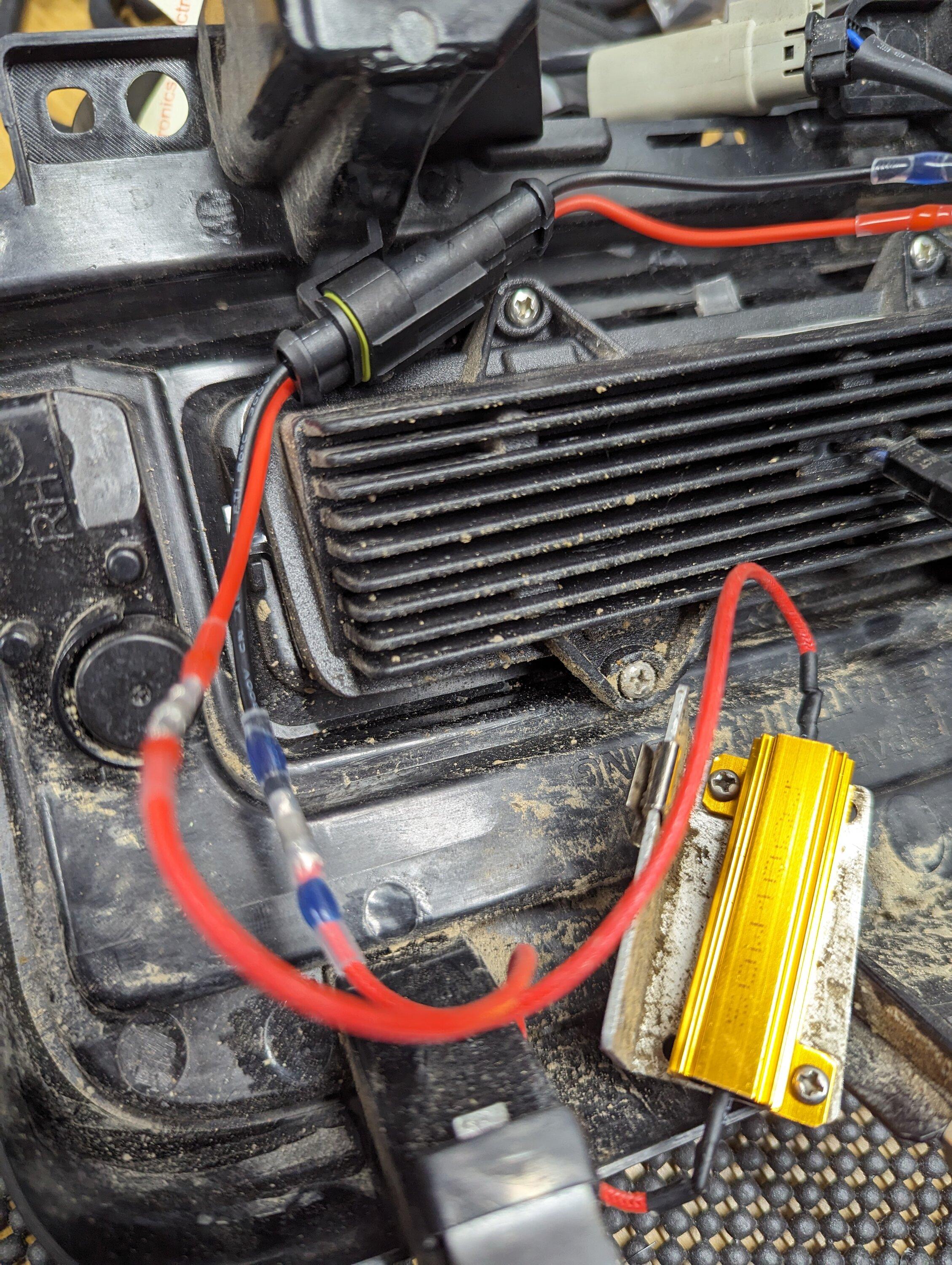

Noticed today driving home from work that I was getting a fast flash on my right turn signal. When I got home everything was working, no lights out. I have Oracle flush mounts, and I read that some people had trouble with corrosion so I pulled it out and the connector for the resistor def had some corrosion. I cleaned it up and went to test it out, and now I'm not getting any turn signal at all. I tested at my trailer wiring and nothing. Tried the OEM tail light and nothing. Tail/brake works. Other side turn works. Just not the right rear turn.

The connector for the resistor (for non LED Broncos) is not sealed. If you have this one, put some dielectric grease on it (or maybe even cut it out and use a better connector).

Ok. Checked it out a little more today. I couldn't find a short in any of my wiring or in the harness for the tail light.
I think the code clearing when I removed the trailer wiring was just coincidence.
When I was poking around today the code came back with nothing plugged in at all.
I replaced the Oracle LED tail with the OEM, and today eventually the code went away and the fast flashing stopped and I had a turn signal again. Hooking the trailer pig-tail back up did not cause any issue and it was still working.
So...new question.
Could just having the tail light unhooked trigger the code I was getting? I wasn't having that issue until I started unhooking everything to check the resistor.
I was getting B12848 Right Rear Turn Indicator
Short to ground
I'm used to diagnosing this stuff with a multimeter and spare fuses. This modern stuff is new for me lol.

I ended up getting a similar resistor from Amazon and cut the old one out and redid the wiring with a better connector. Everything is working properly ATM. I'll keep an eye on it but hopefully the short was just me being sloppy with the probes.
The original resistor was what failed. I'll probably reach out to Oracle and see what they say.
