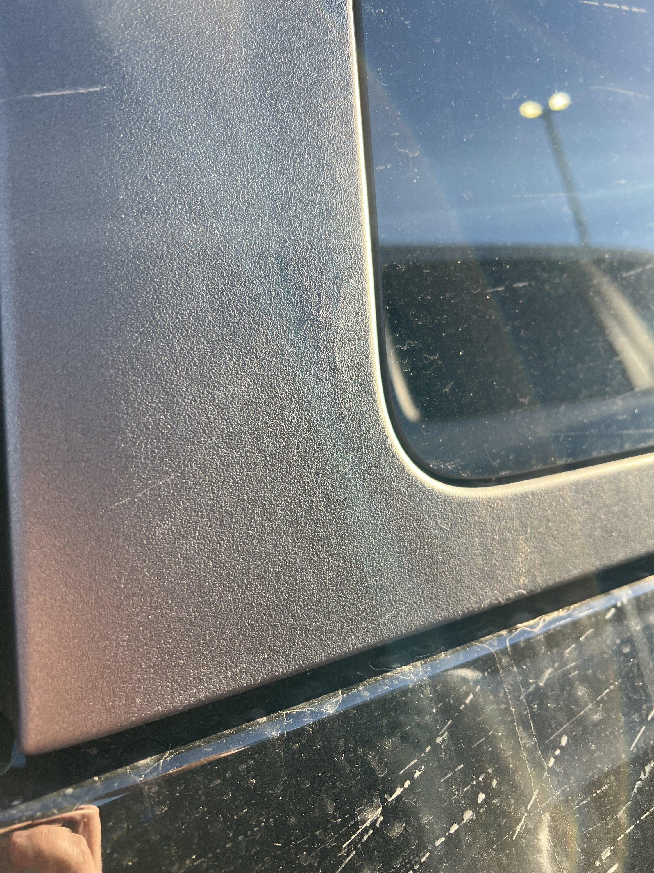

Looks like my wife’s 23 OBX we got 4 weeks ago has started cracking. Taking it to the dealer Saturday so they can get pics and report it.
Ford just updated their bronco top GSB the other day. It now says that cracks like this ARE a warrantable issue. So you shouldn’t have any issues getting it covered.

That looks like above the window. First Ive seen up there. Nice to see change for 23 :LOL:
Thats great info for those of us who got denied before, thank you.
Any theories here why some are cracking and some are not (not yet anyway)???
Ive looked at least a dozen closely in person, and have yet to find one with at least the hairline cracks under the window. About half have cracks like the pic above, but at the lower corners.

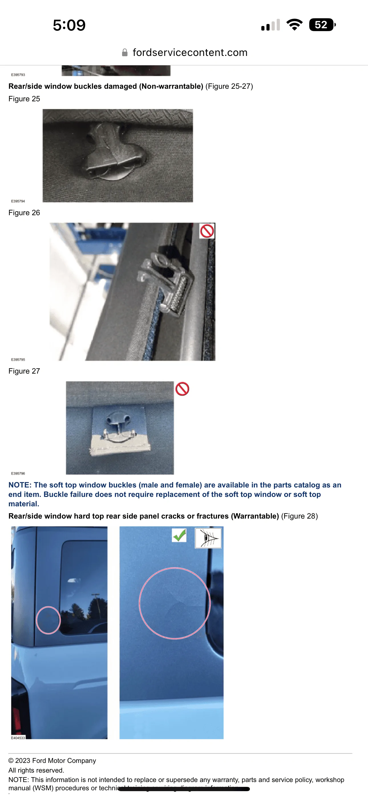

No problem. Here’s a screen shot of the newest revision just in case they ever try and deny it again
Thanks for that. I'm taking delivery any day and half expect to have some cracks in the first couple of months. You would think Ford would be eager to cover these under warranty as they can charge the cost back to Webasto.

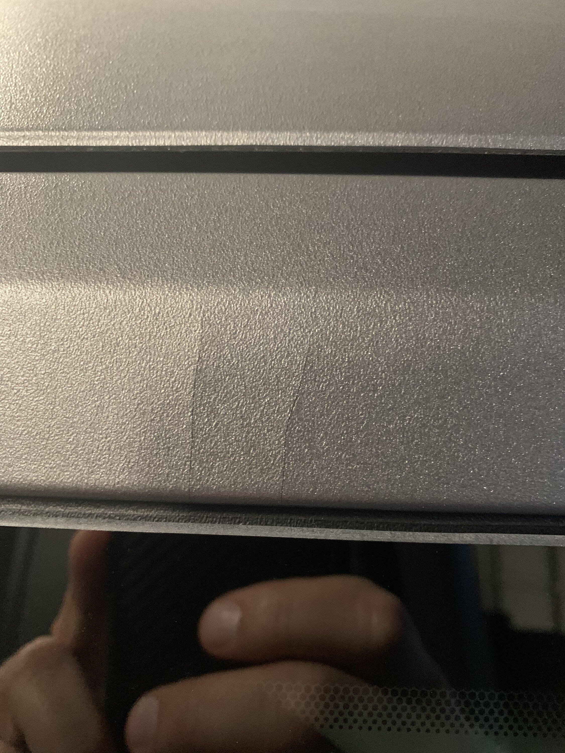

Looks like my 2022 hardtop just started cracking recently. It was built in September of 2022. In addition to the cracking I just notice the overall quality of the hardtop is pretty poor. Either that or I’m just being too picky haha.
Nope. Those edges look like 💩. Welcome to the club.
