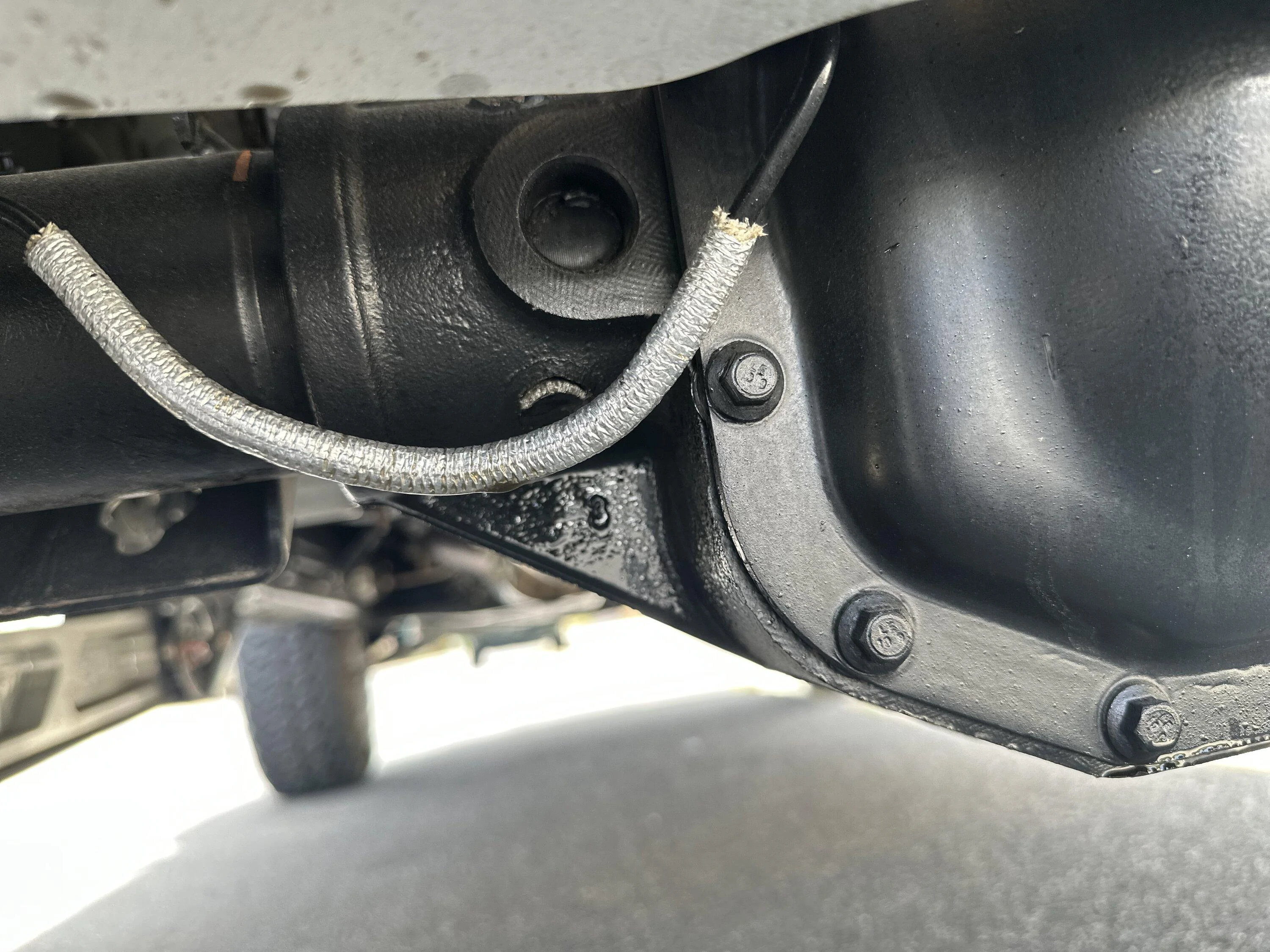

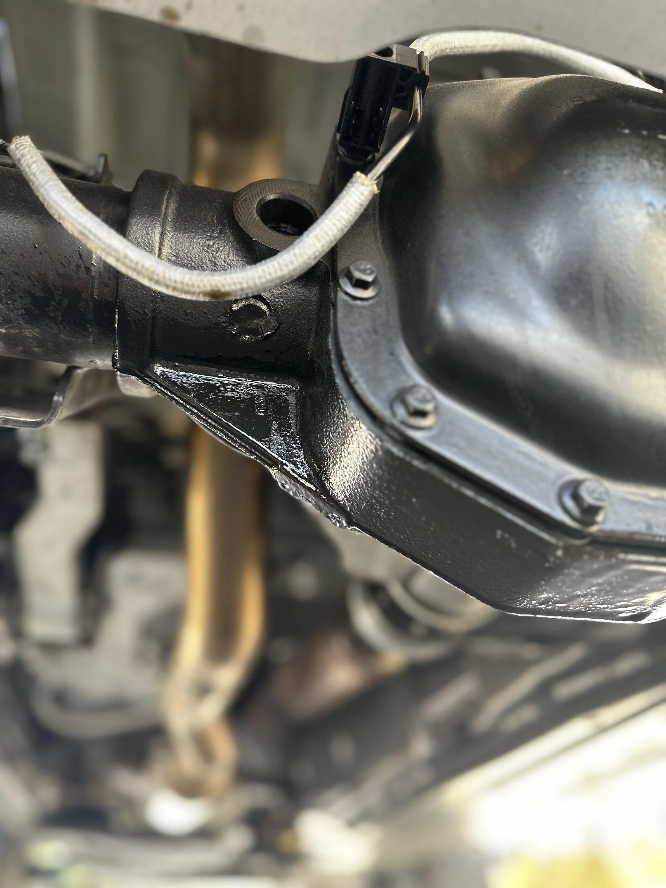

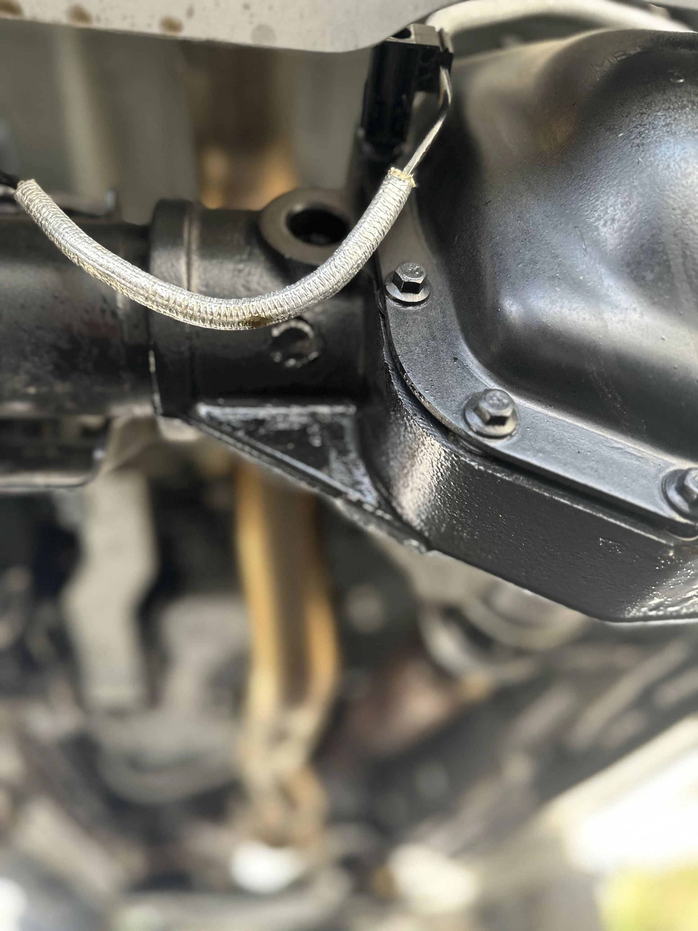

I am revising this post to clarify Ford is replacing the axle under warranty. The axle tube and plug weld issue is a warranty gray area and can go either way.

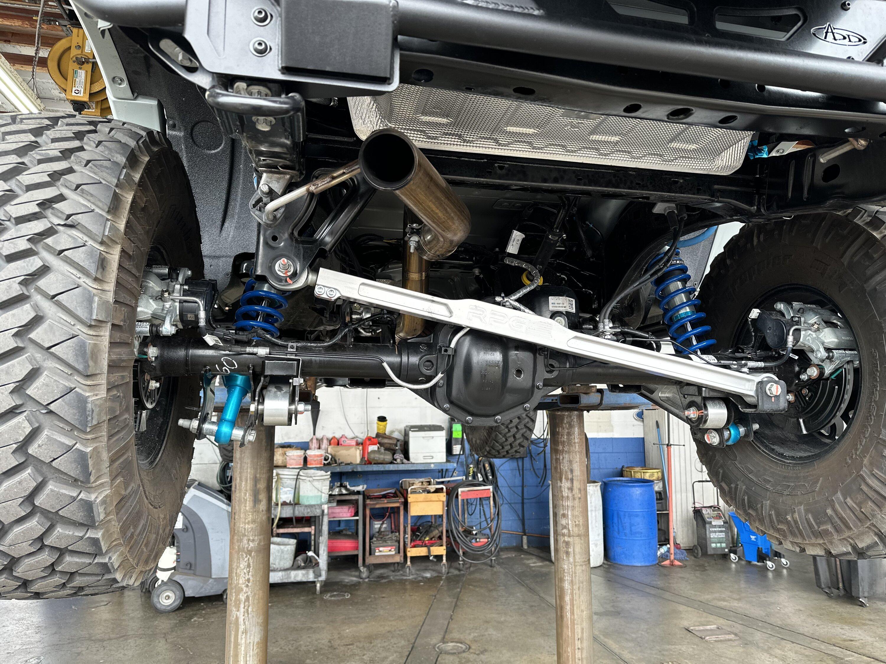

I’m on the fence with what I want to do. Assuming warranty doesn’t cover it, what kind of options are available so I’m not doing this all over again in a few months? I wasn’t even driving the truck hard. I was hard on my 4Runner and never had a single problem with it and it was supercharged.

Perfect time for a Dana 60 install!
Just kidding. Bummer for you, OP.
These plug welds now seem to be an area of concern.
i am wondering if the 4 link suspension during a high or low obstacle twist of axle vs body is causing a twisting of the left tube vs the right tube and the weak points are the plug welds or now the tubes themselves ,easy to duplicate in shop by removing 1 of the 4 link end bolts and lift 1 side to see if hole still lines up

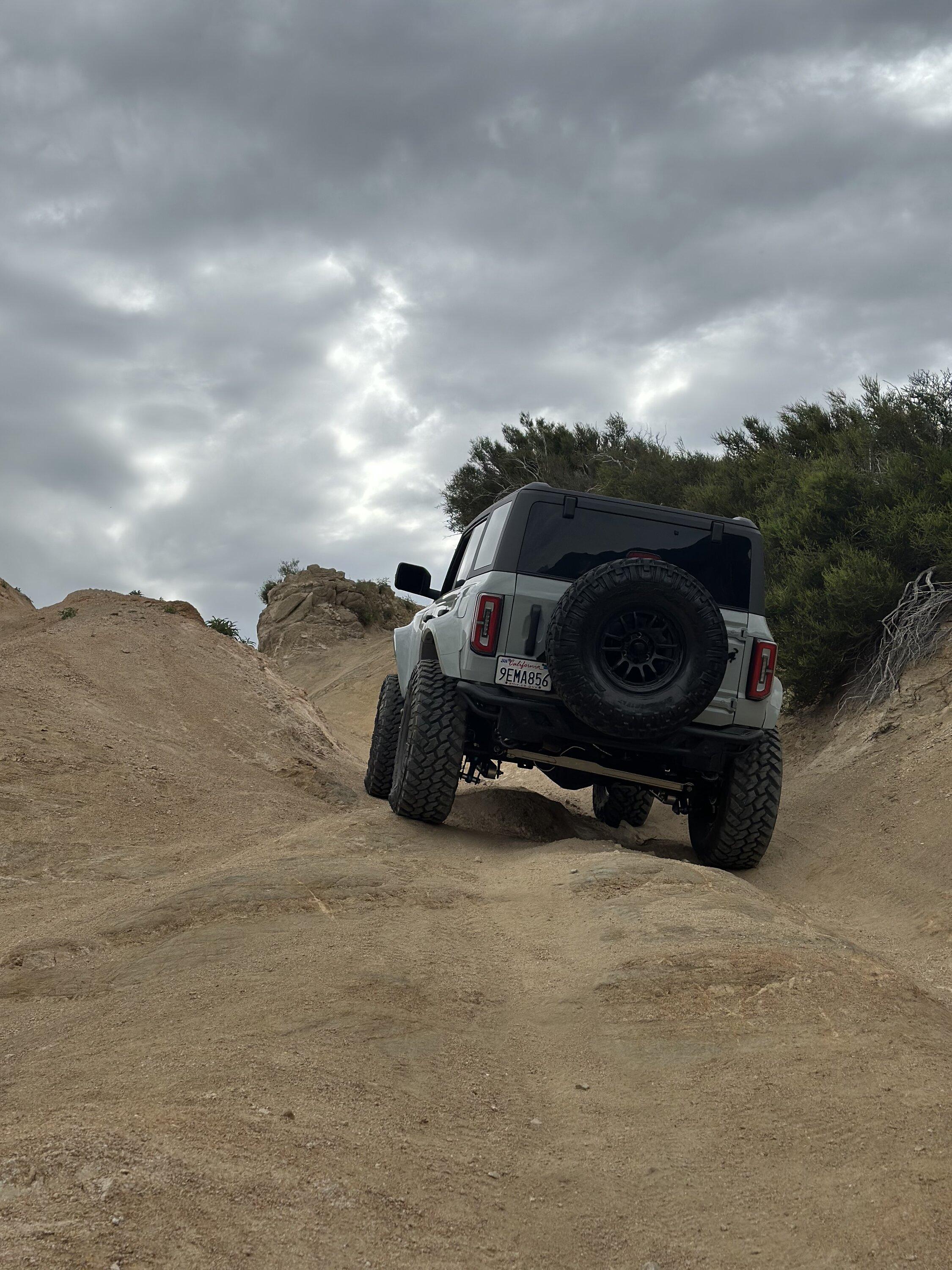

I’ve had a few other people say the same and it just doesn’t make sense why this happened. Here’s some trail photos. Nothing a Prius couldn’t handle.

I agree 37's are not the problem . . Plug weld should never shear. They are not doing something correct ,not enough heat ,dirty oily metal ,wrong wire ,ect .But I still say it'a binding in suspension geometry.
Hey is that Pilot Rock?
No I think it's Dana quality control issues.
