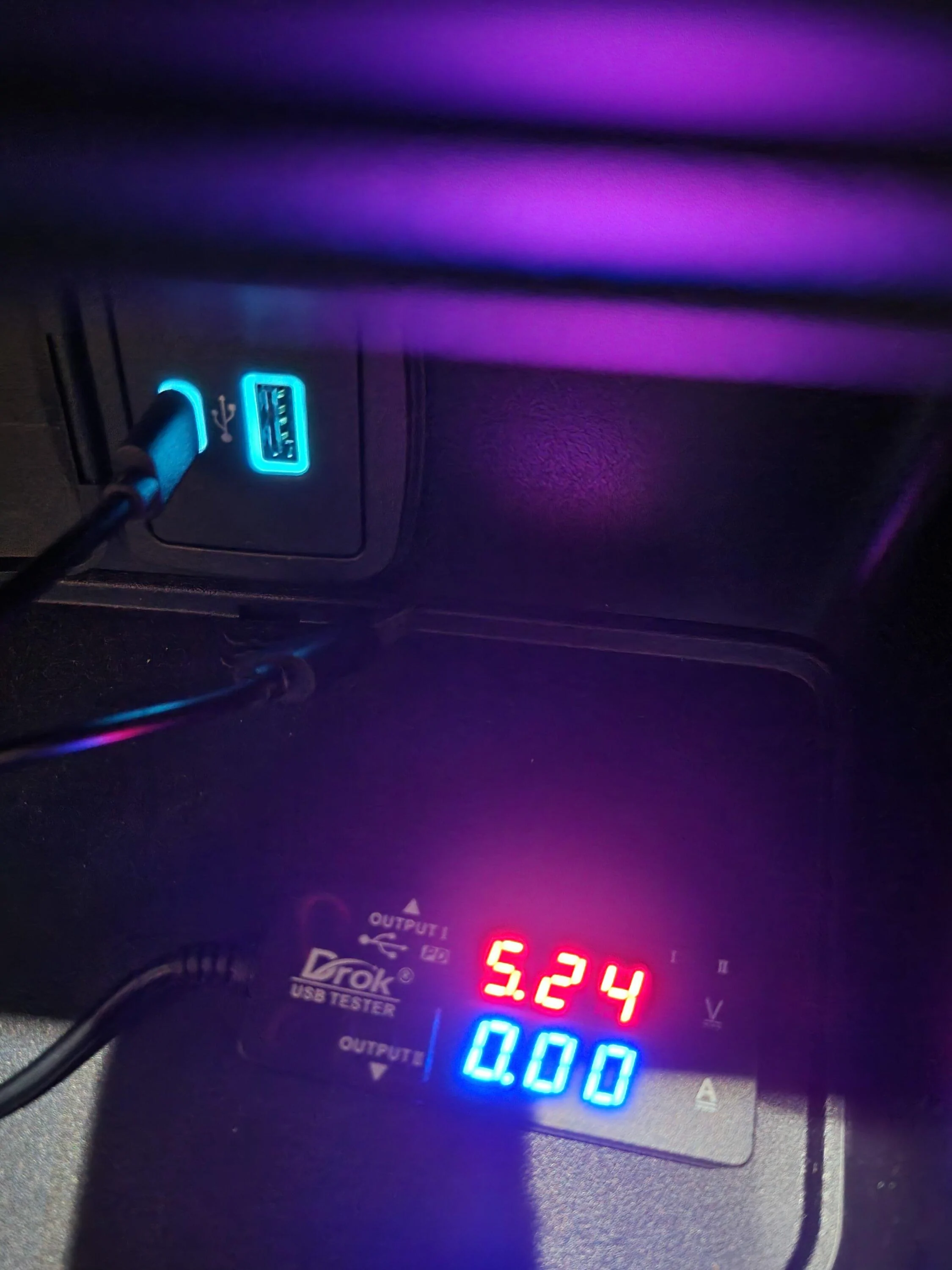

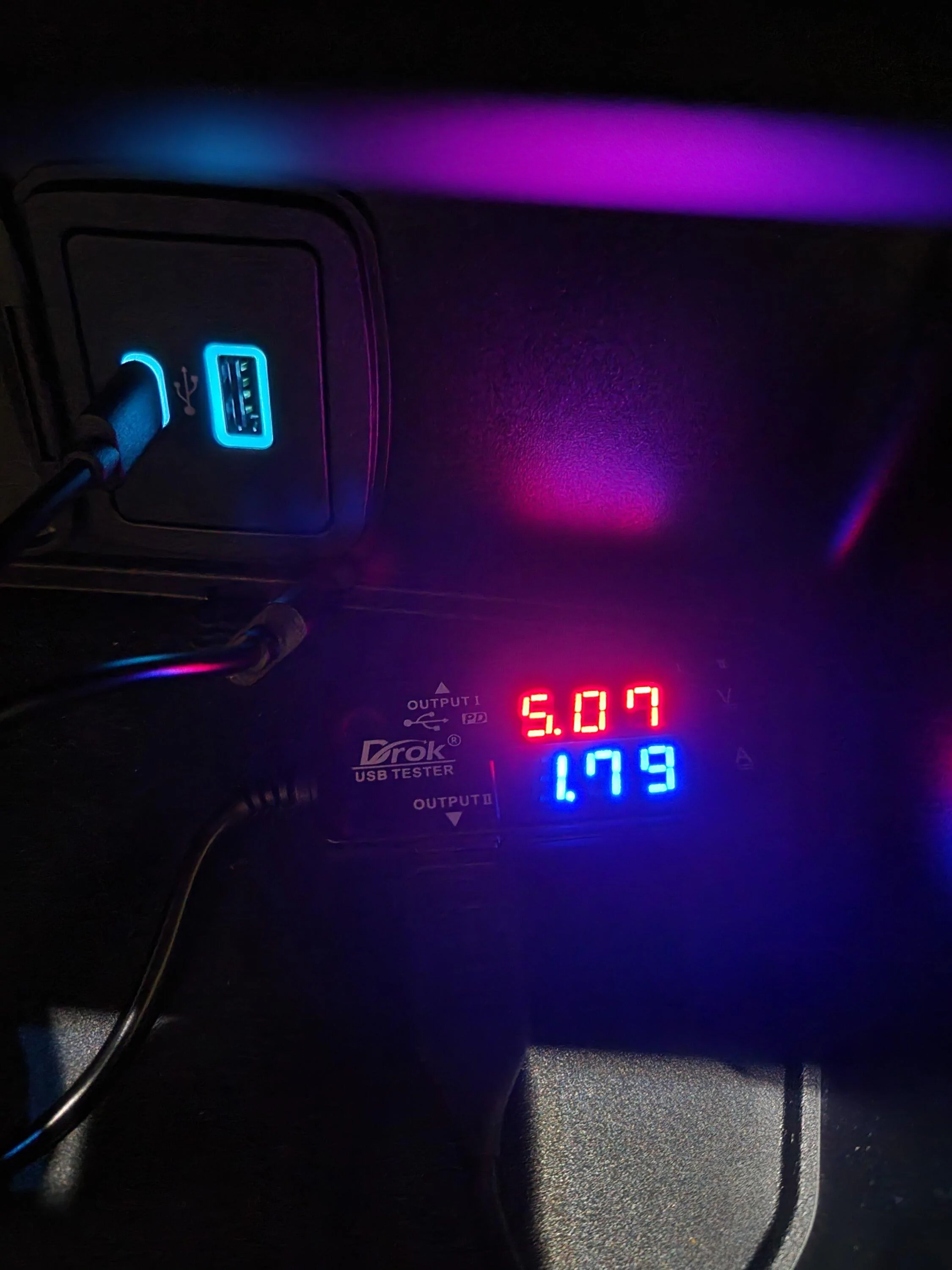

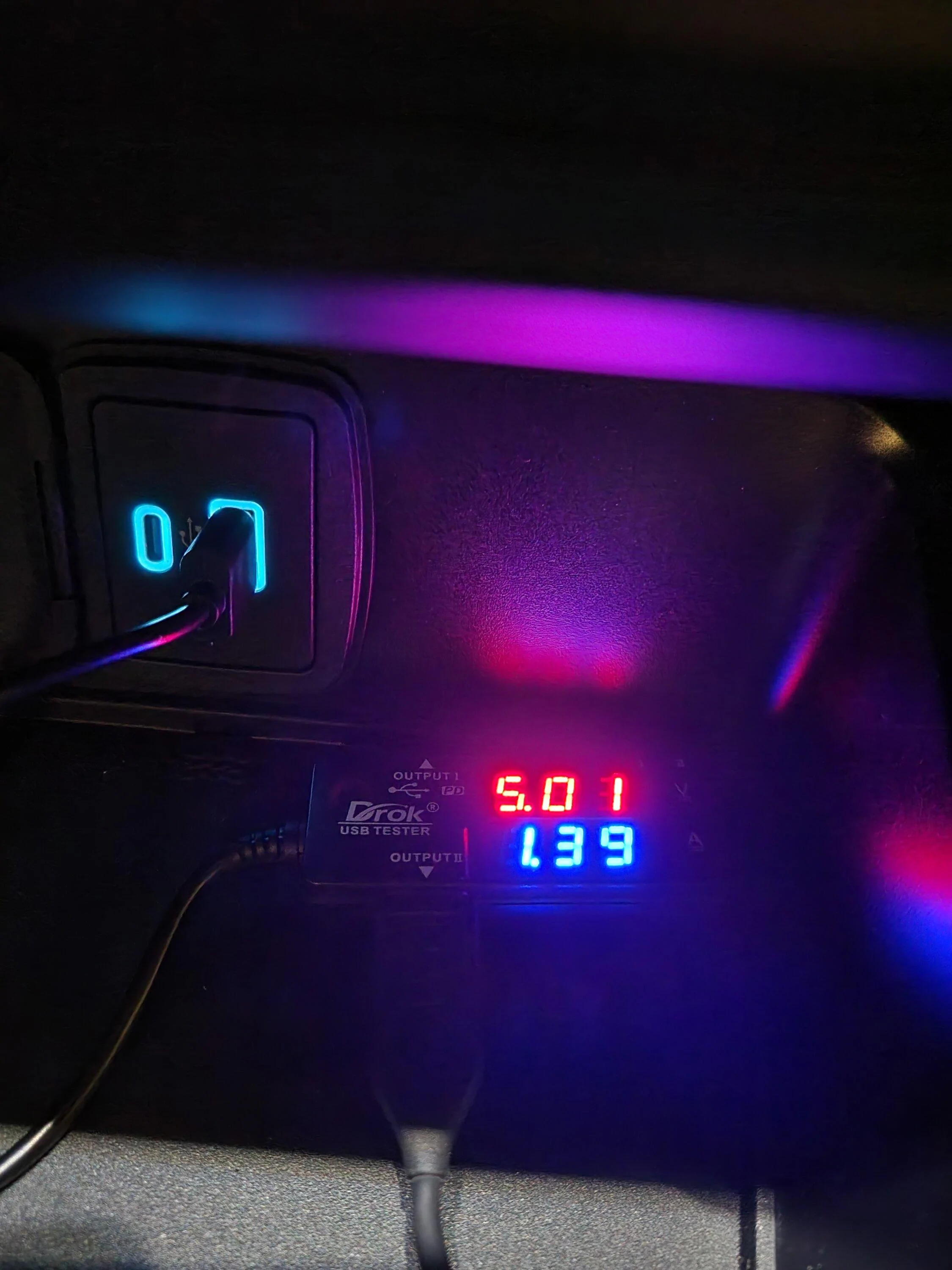

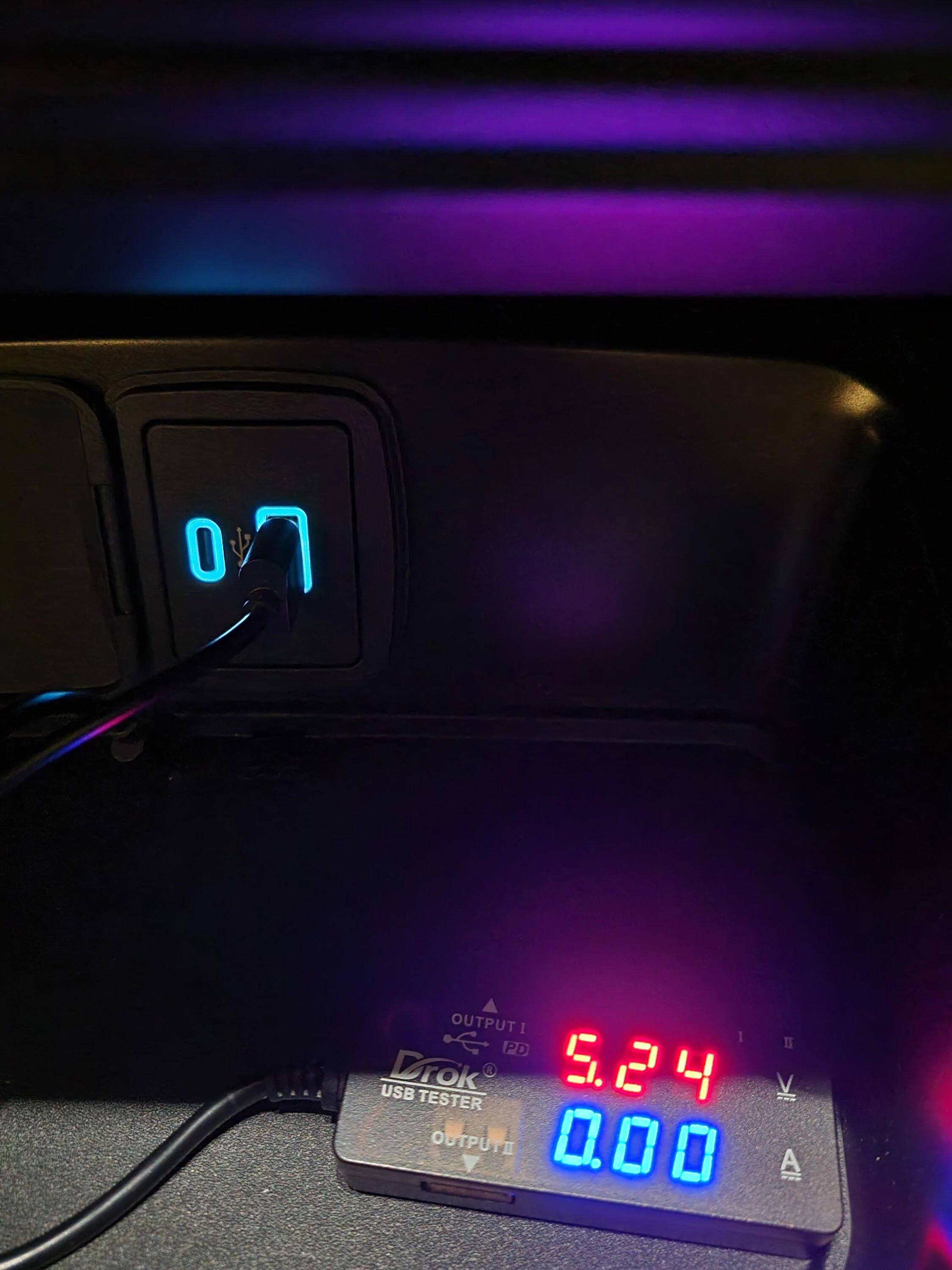

New member here! It only took over 2 years to get my Bronco.
Did a couple of measurements with a USB meter on the lower center console and on ports behind center console at the rear seats, and my Samsung Galaxy S21. Quick charge enabled on the phone with about 50% battery - no quick charge on the USB ports!
Measured USB type A and type C with a few different cables with repeated results.
USB type A charging current 1.39A @ 5V
USB type C charging current 1.79A @ 5V
Hope this helps others!

Thank you, this confirms C is slightly stronger amperage, and i will use that port for my setup
