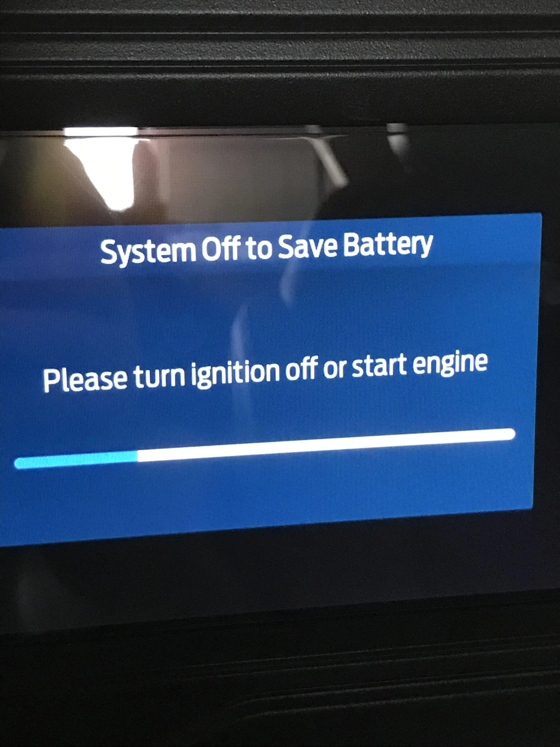

The last couple of times we turn off the Bronco we get this on screen.
Mid package with push button start stop.
Any ideas what it means? Or Why it shows up?

Check your battery connections. I had a loose one and it did this amongst other errors.

Thanks for pointing me in the right direction.

I just got that today. About 6 hours before that there's a low battery message in Fordpass.
I hadn't driven it for about 48hrs.

It looks like it means its turning the system off to save your battery. 🙂
Turn it on, let the alternator charge the battery up, then turn it off again.

I have not driven very much lately. So will check all connections and take an Easter drive.

Drive charging made it go away.

Is yours a daily driver or does it sit for a few days in between?
Our was sitting for a while and I did remember a couple afternoons of work that had doors open until the lights timed out.
