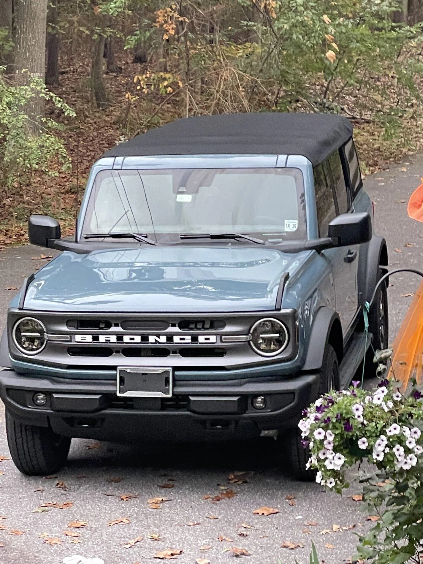

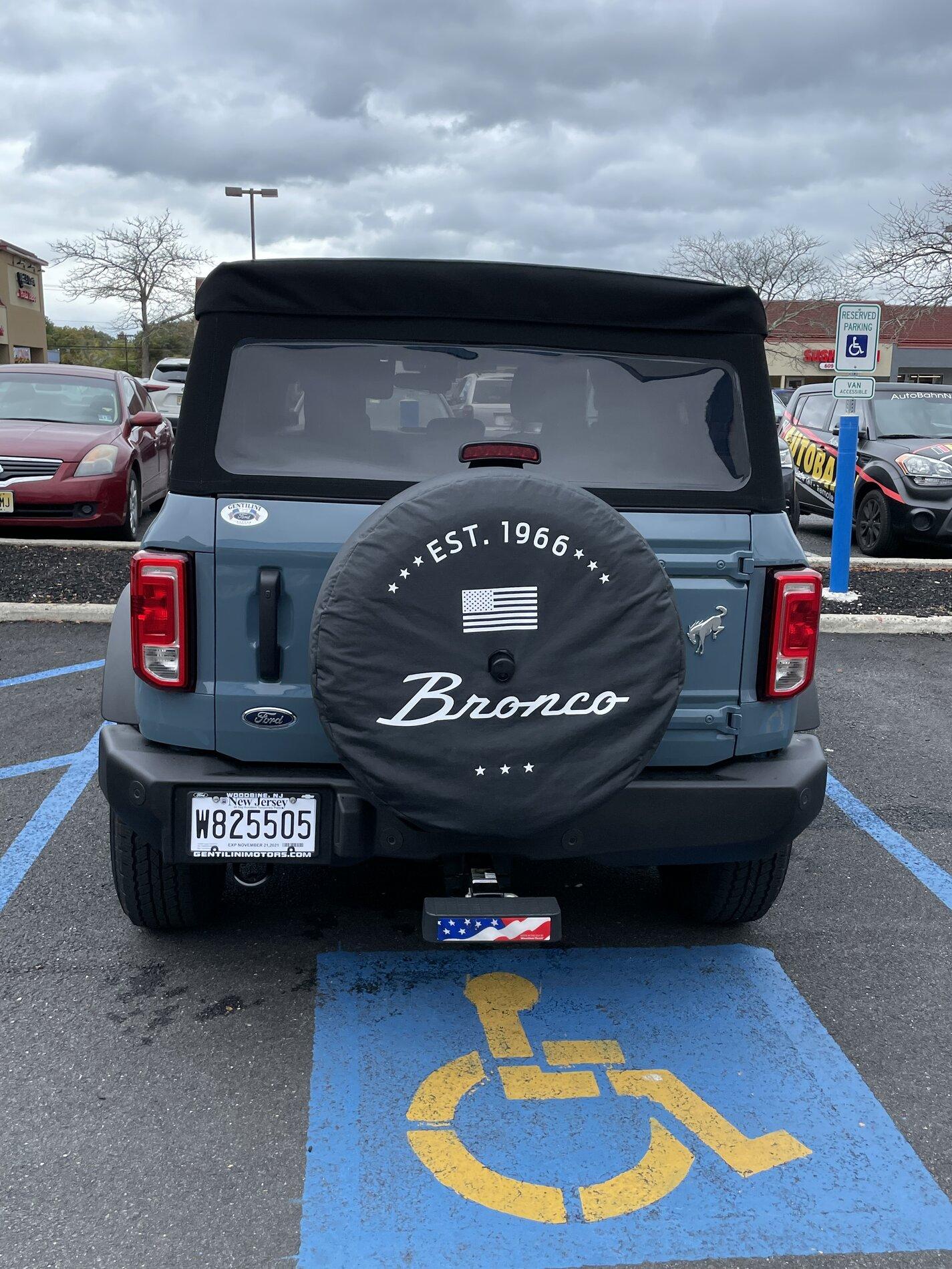

I have 2600 miles on my big bend 4 door with the 2.3. I love it. Plenty of go and 22+ mpg. I owned a 150 with the 2.7 and never had a problem in 78k miles. If you want more pickup you can go to premium gas. It makes a difference but imhop it’s not worth the extra $.30-40 cents a gallon. The mileage with either grade is about the same. Ford says if you take the 2.3 off-road a lot you may want t use the premium but my setup is all I need. i Am very pleased with the 2.3/and if I ordered another bronco I’d have the 2.3. I did drive one with the 2.7 so I can compare them.

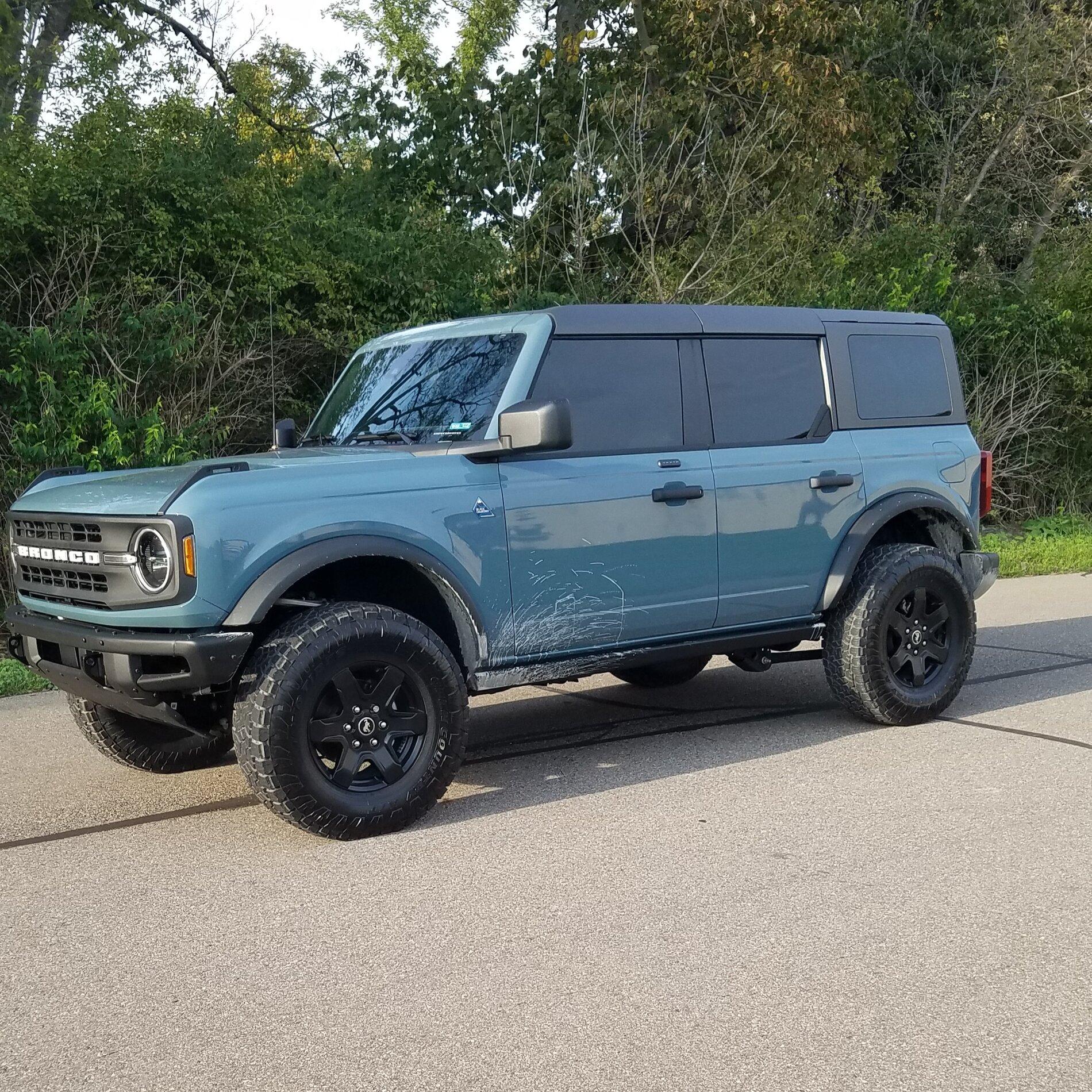

Before picking up my Bronco I had a ~500hp Wrangler with a 3.6T. Coming from that, I though I would be bored with the 2.3 in my Bronco. However I can say I'm quite content with my 4dr BD 2.3 MT after putting a little over 3000 miles on it. Surprisingly "zippy" and fun to drive, don't regret not going with the 2.7 one bit. The 7sp/2.3 combo is a blast to beat on around town. I have 34s and the 4.46. The gearing is quite a bit taller that I'm used to, I would have prefered the 4.7 or a tad more.
The rpms are only around 2.3k @ 80 in 6th. With the horrible aerodynamics, 6th typically requires around 4-5lbs of boost to maintain 80, while 5th is generally at 0-1psi. I think highway milage would actually increase a bit with highway gearing. If it allowed it to run 6th without any boost being used.
I think it's funny that people think that 2.7 torque is "required" for offroading. That's what 4Low is for, 2.3 is plenty with all that gearing.
Wranglers did fine offroad for decades with a lethargic 4cyl. That's exactly what the 2sp transfercase is for.
Excessive torque output when crawling typically leads to higher rate of drivetrain failure out on the trail.
