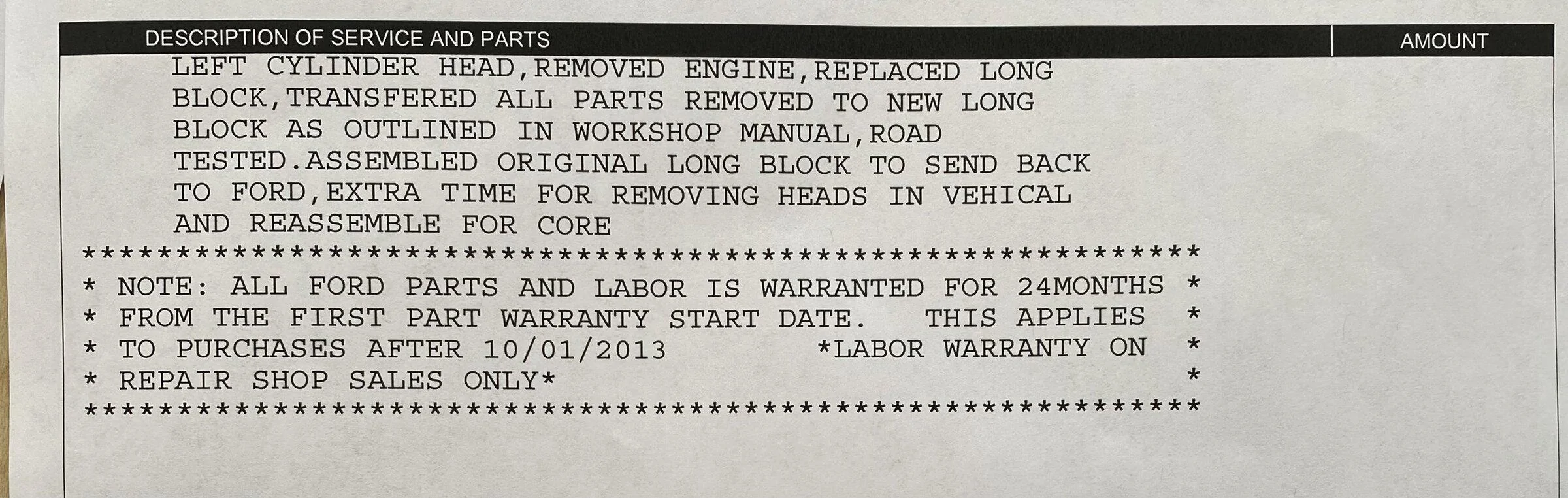

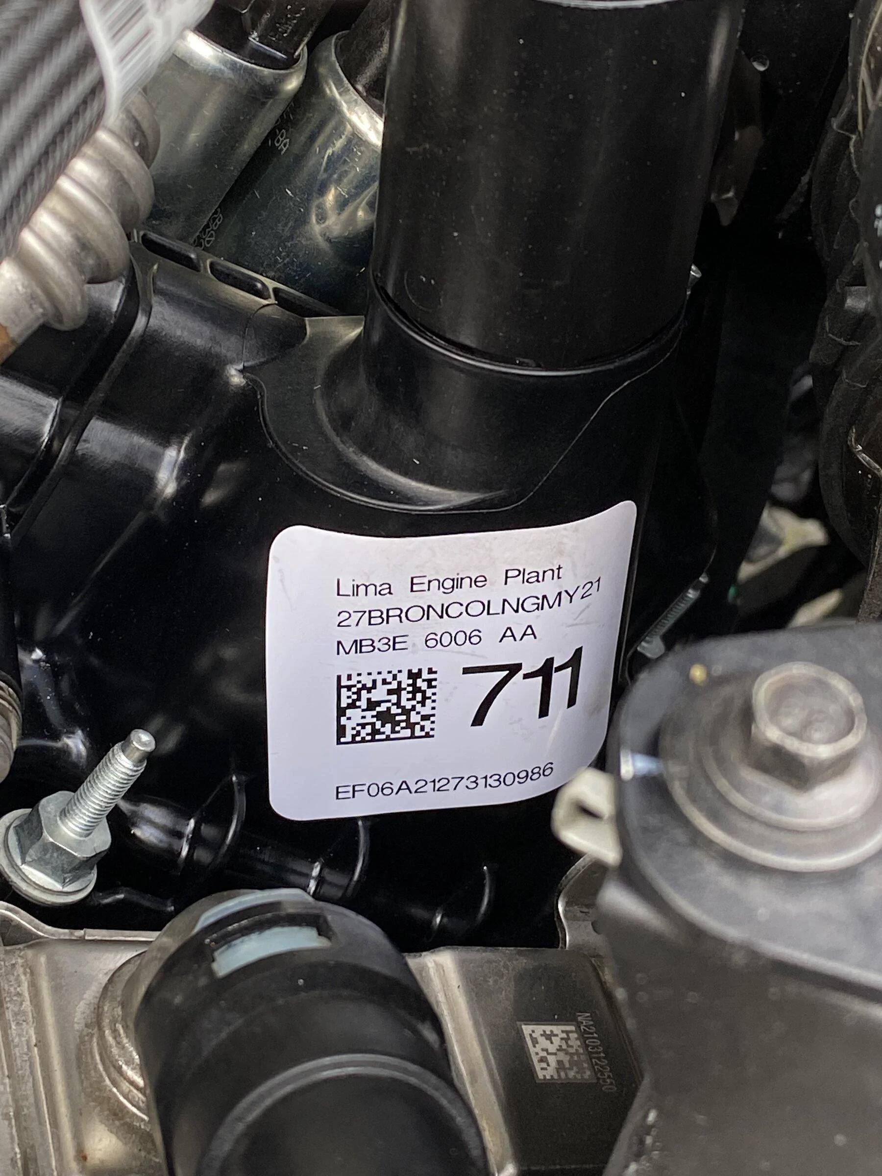

I got my Bronco back today. Engine is Julian 21273 MB3E 6006AA. Took 31 hours total and everything seems to be ok. Still the only one that had a failure at my dealer. Not sure what I can ask from Ford as restitution since I purchased the maintenance plan and the extended warranty when I bought it.
So your replacement engine is only warrantied for only 24 months???

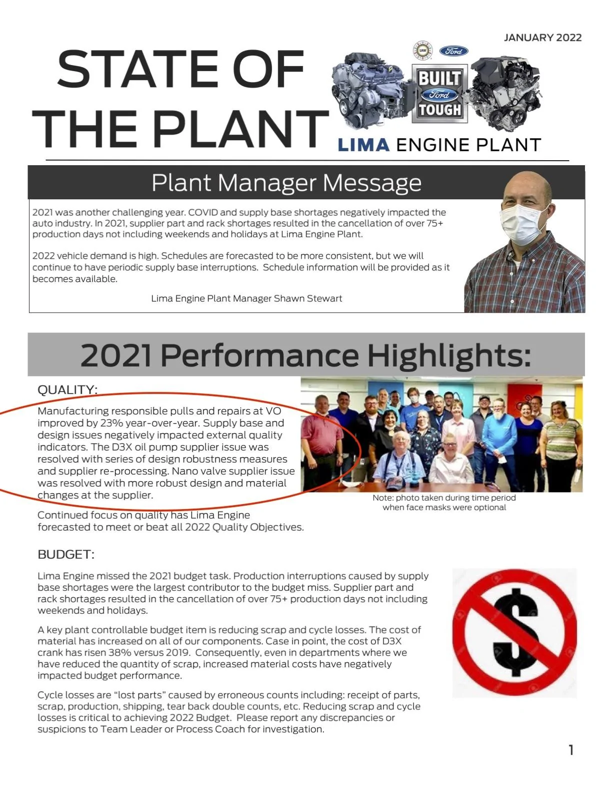

Actually, the smoking gun is that Ford published the fact that Lima plant employees identified the issue that was causing problems with reliability issues external to the plant that were being tracked.
No that's only if it had been a customer pay job. Warranty repairs are warranteed by the the fact that the entire vehicle is still under warranty

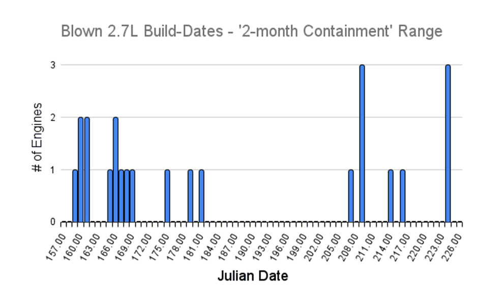

I'm having users who haven't seen a failure yet record their julian date and mileage. I made a histogram on those engine julian dates.
I think the thing I take from the small data set is that the 30 day gap in failures is likely due to a pause or reduction in engine production rather than "good parts" cycling in.
42 people have recorded their "good engines" vs. the 33 failures.
So were running 55% running/45% failed roughly... LOL! Who wants those odds?
I am still convinced that my Bronco is on borrowed time.
I don't agree. We don't know if that is related in any way to these failures. In fact we have no way of knowing if the less "robust" Nano valves ever made it into customer engines. We also don't know that they are Bronco engines, as 2.7L F-150 engines are made at the same plant. I think it is a stretch to extrapolate a sentence from a corporate morale newsletter as a definitive explanation of why Bronco engines are blowing up.

You don't think this Lima Newsletter is big ? isn't this first Ford confirmation of defective valves ? Before this we only had five rumor posts by Jay3630 back in Oct. And hundreds of blown engines w dropped valves, but still wondering if they were really caused by bad springs, or keepers, and so forth. Now we finally have Ford confirmation of bad valves - both design & materials -
January '22 - Lima Plant Newsletter - § Quality, page-1
- 'Nano valve supplier issue was resolved with more robust design and material changes at the supplier.'
- 'Supply base and design issues negatively impacted external quality indicators.'
Yeah....I assume "external quality indicators" = Broncos towed back to dealers.
And the more I look at the failure date graphic below, the more I think the date void (which is July 2021) indicates that Lima was producing 2.7s for vehicles OTHER than Bronco. That is supported by VictoryLights' tracking of no-problem Broncos, which has an almost identical date void pattern.
So, it seems much more likely that ALL bronco 2.7s produced up until the 'fix-date' (December X?) are equally at-risk of needing a tow truck.
