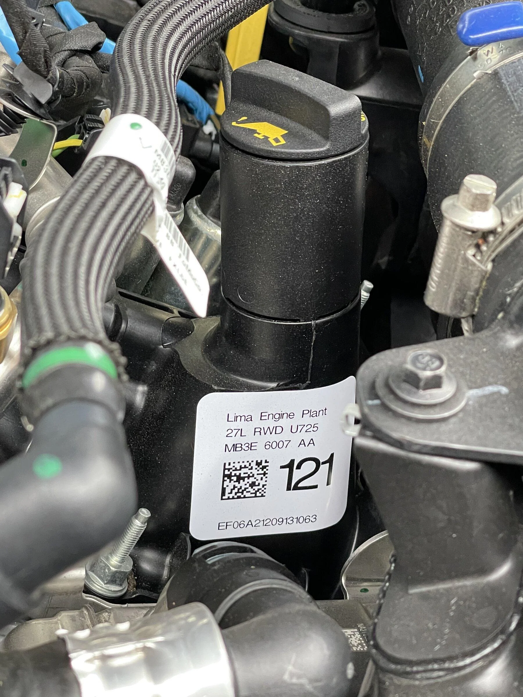

Can anyone tell me if they heard ticking from what I believe is the exhaust area before failure? I just took a picture of my engine build it it does not bode well for me. Looks like I’m a 209. I have about 1300 miles and no issue yet besides the ticking noise.
No.
