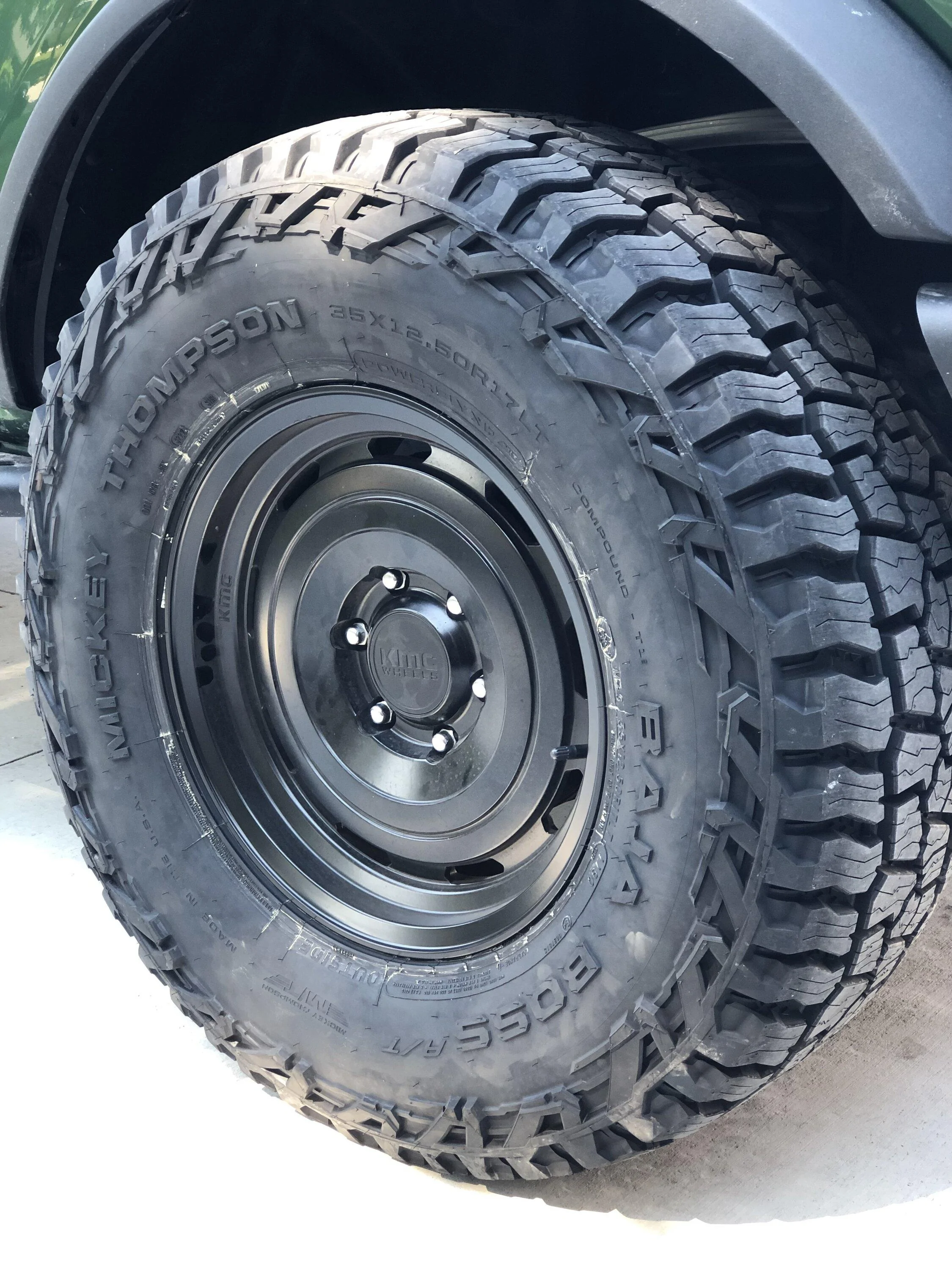

Out of curiosity, is there an advantage to powder coating the beadlock rings as opposed to getting a trim ring kit?
im sure both work
The rings that come with the factory wheels are just for looks.
I wanted them a specific color
Thats why i went with powder

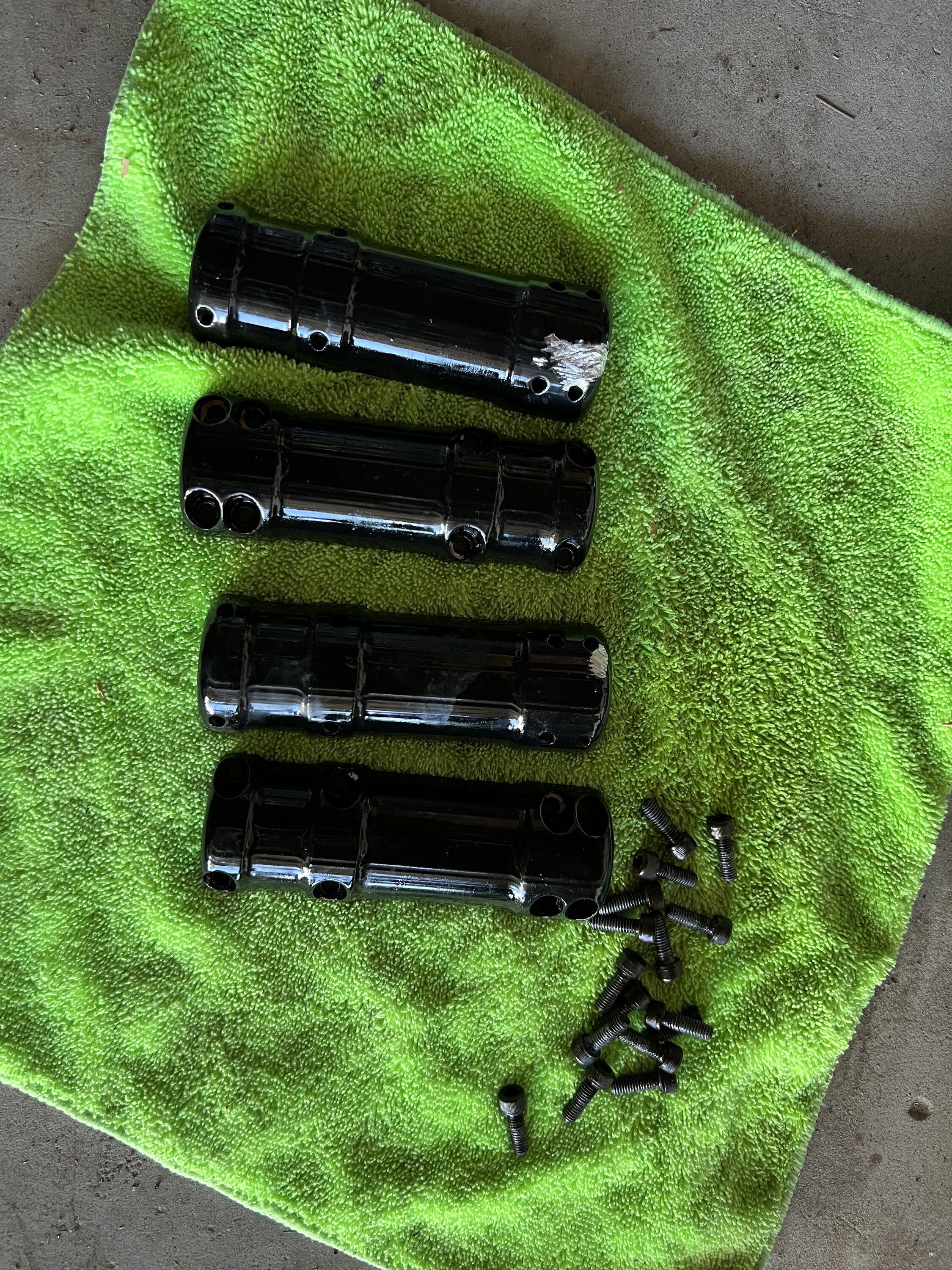

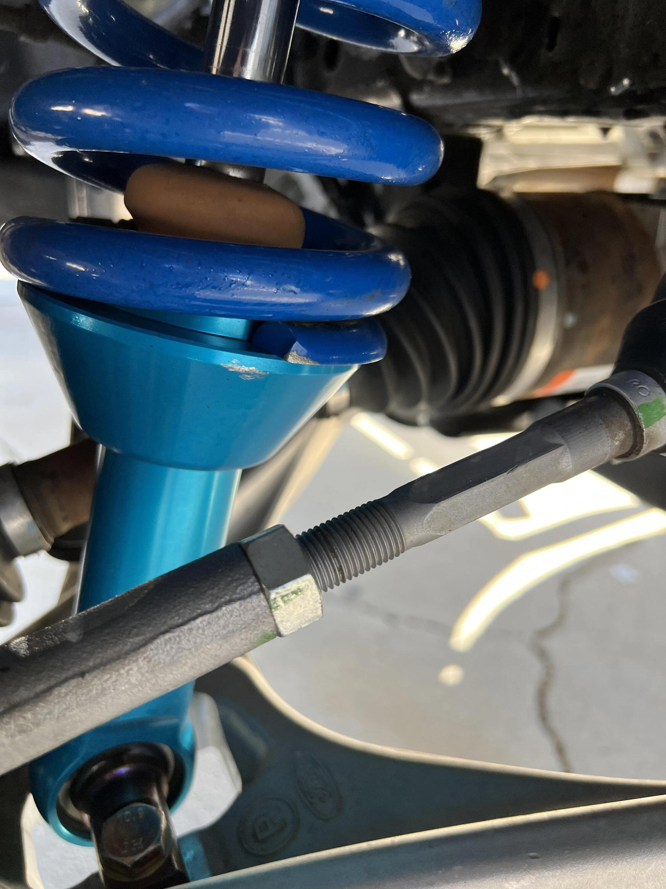

About the zerk location.
i did notice that my kid chaos tie rod braces are rubbing on the bottom of the spring cup.
going to check that in the morning as well.
will probably have to go with the thread in type to make sure they clear
rock jock just contacted me and can run the zerks facing up, they will clear

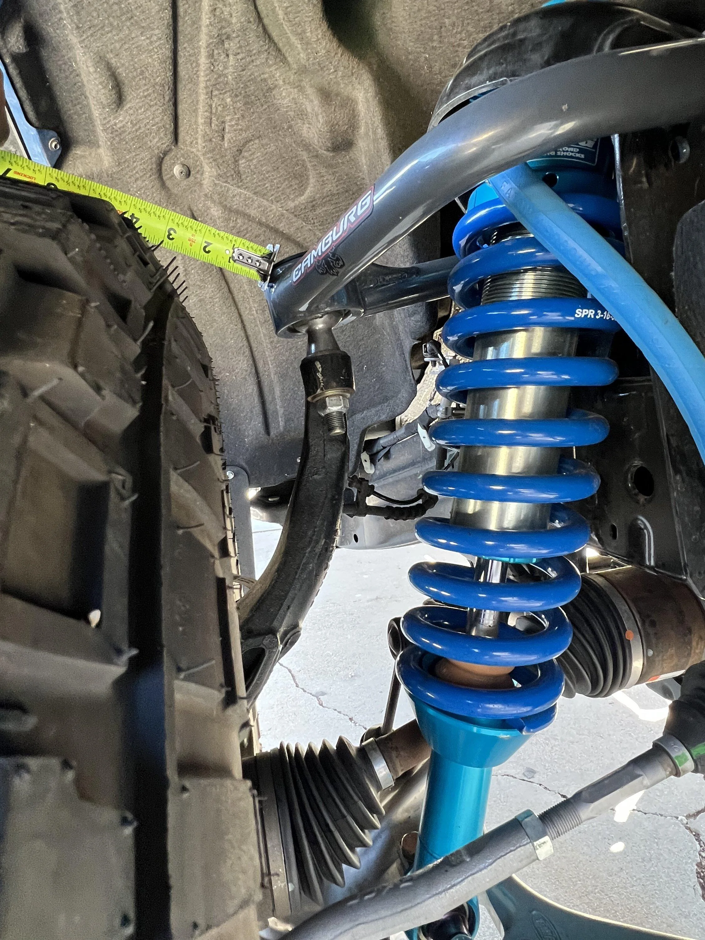

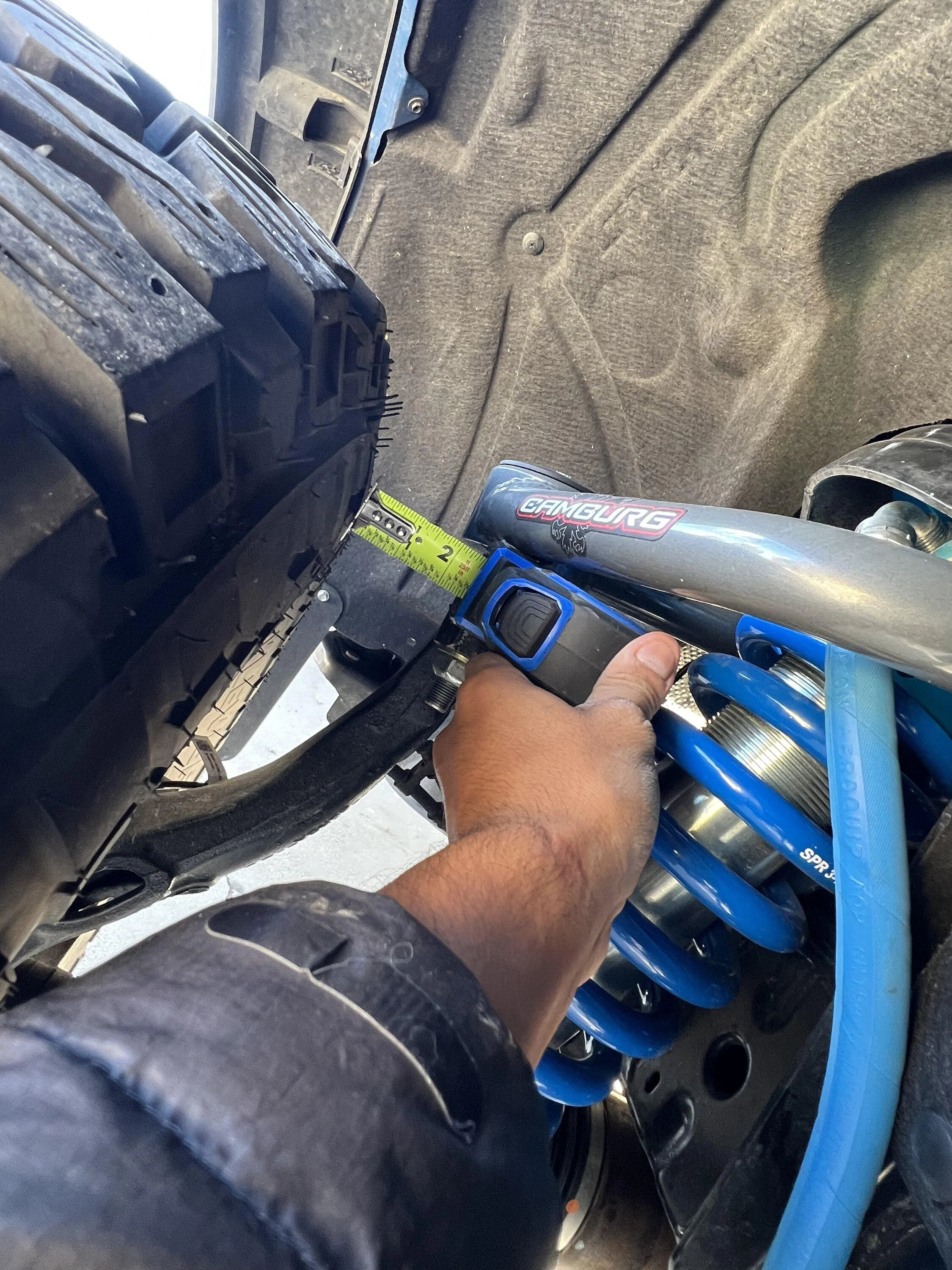

I didn’t intended to get new wheels with this build, I have a set of KMC 720 Roswells I bought in 2020 before I had my Bronco and information was still limited. I got the 17x8.5 +18 5.46 Backspacing. At the time a Zero offset was available, but I thought it would be too far out on the stock HOSS 2.0. Now they’re discontinue, and highly sought after.
As I’m reading through the Camburg specs, they state a maximum of 5.00 backspacing. So I’m 1/2” too far in. Do you see where there would be a conflict with the Camburg UCA? I read through most of the other top UCA makers and they all state close to the same 5.00 Max Backspacing. Only RPG claims there’s will work with with OE and Aftermarket.

Here are the pics i promised, you should enough room to run the 18 offset.

Also notice the kid chaos tie rod braces are rubbing into to the kings,
Guessing under spirited driving through the desert.
just removed them and going to install the jks sleeves. Will be much thinner than the bolt on type.
