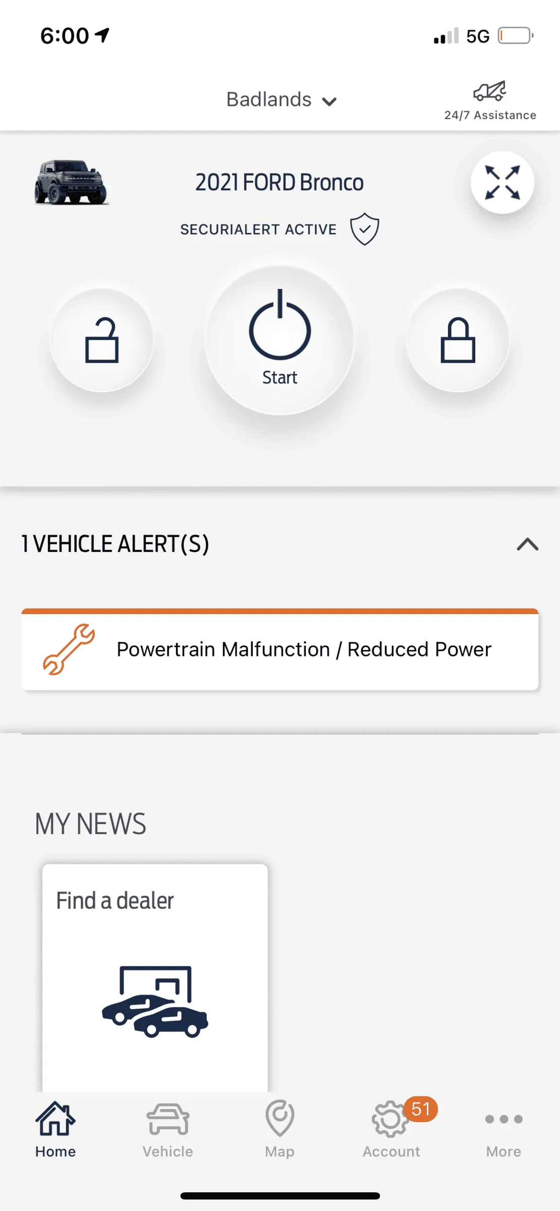

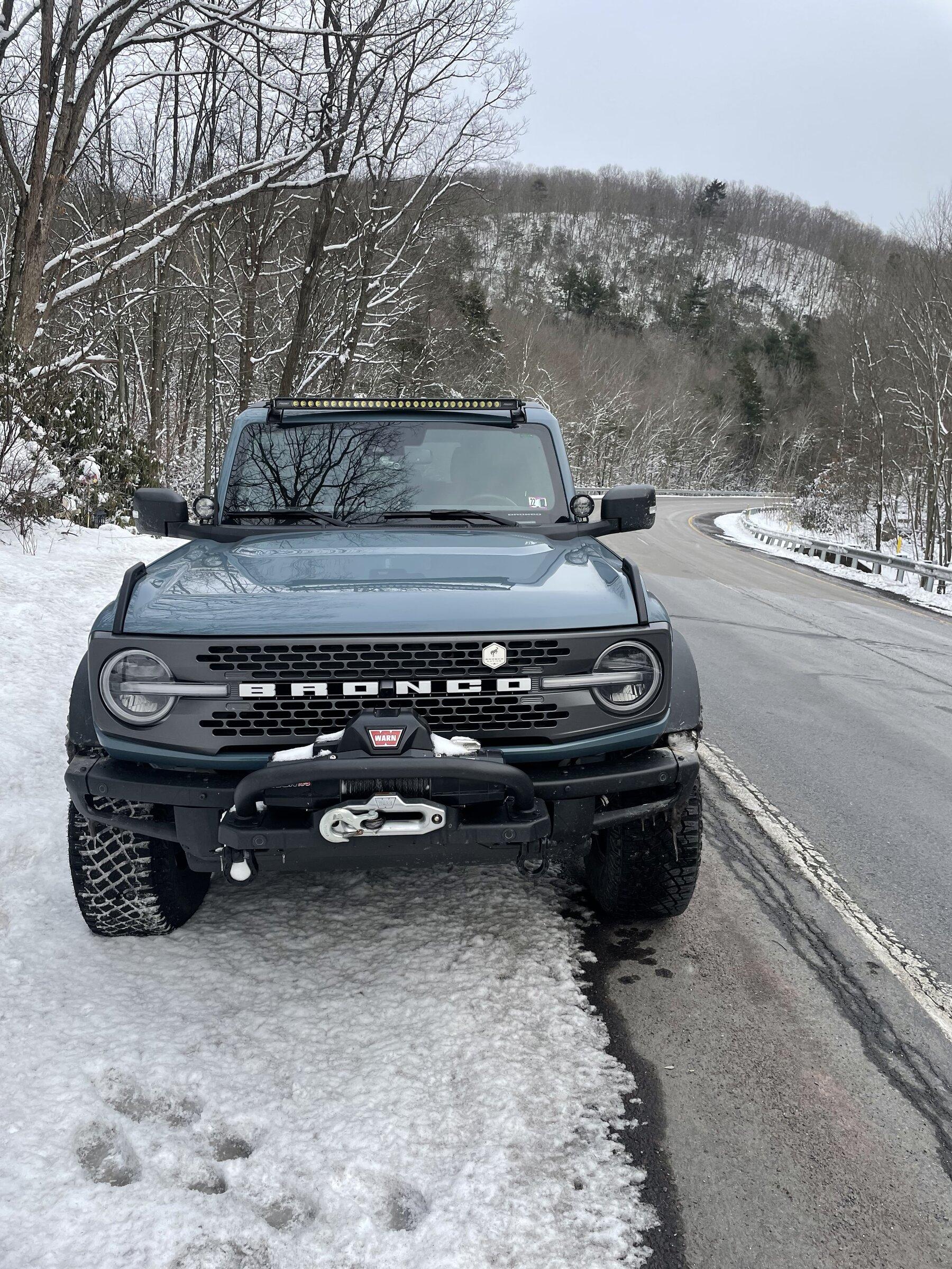

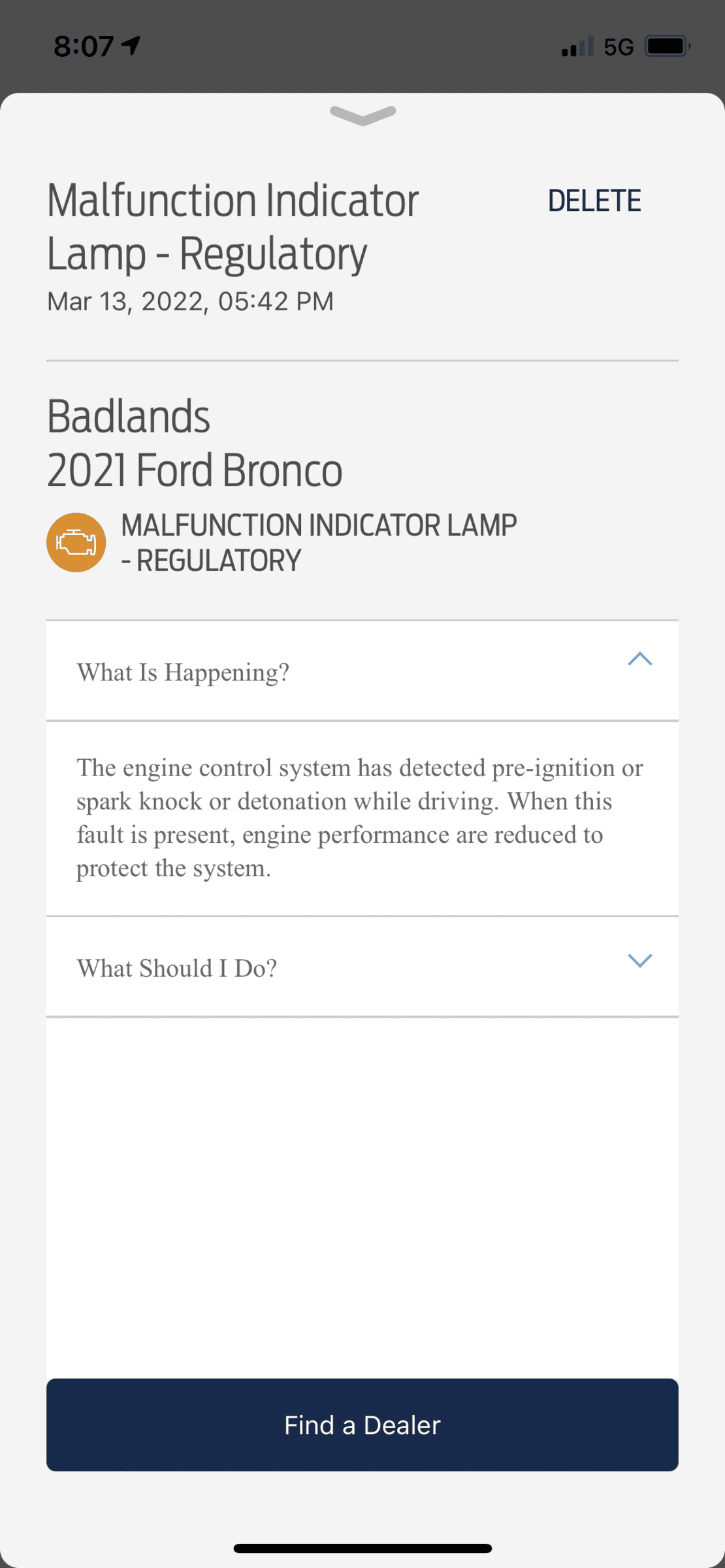

Hey guys, unfortunately I stopped for fuel on Sunday and had my Bronco filled up with super unleaded. (full service station) Unknown to anyone there was a mix up when the fuel was delivered and the delivery guy put diesel in the underground tank. I only made it a half mile up the road when i lost power and got check engine light. The vehicle had to be towed into my Ford dealership. I will keep everyone updated on the repairs, the cost anything else. The Ford technician said the tank needed to be drained and filled with fresh fuel, oil changed and new spark plugs. Good thing for me, the gas station told me they will cover everything 100% towing, repairs and the fuel I purchased.

I don’t see why the plugs have to be changed. I’d think just some fuel system components.
its just good measure. nothing has to be changed at all if the truth be told. empty the tank, fill it up with gas. it will take several starting attempts to get the diesel out of the line, but once it clears, it will be all good.
They would be quite fouled on diesel. Possibly cracked.
