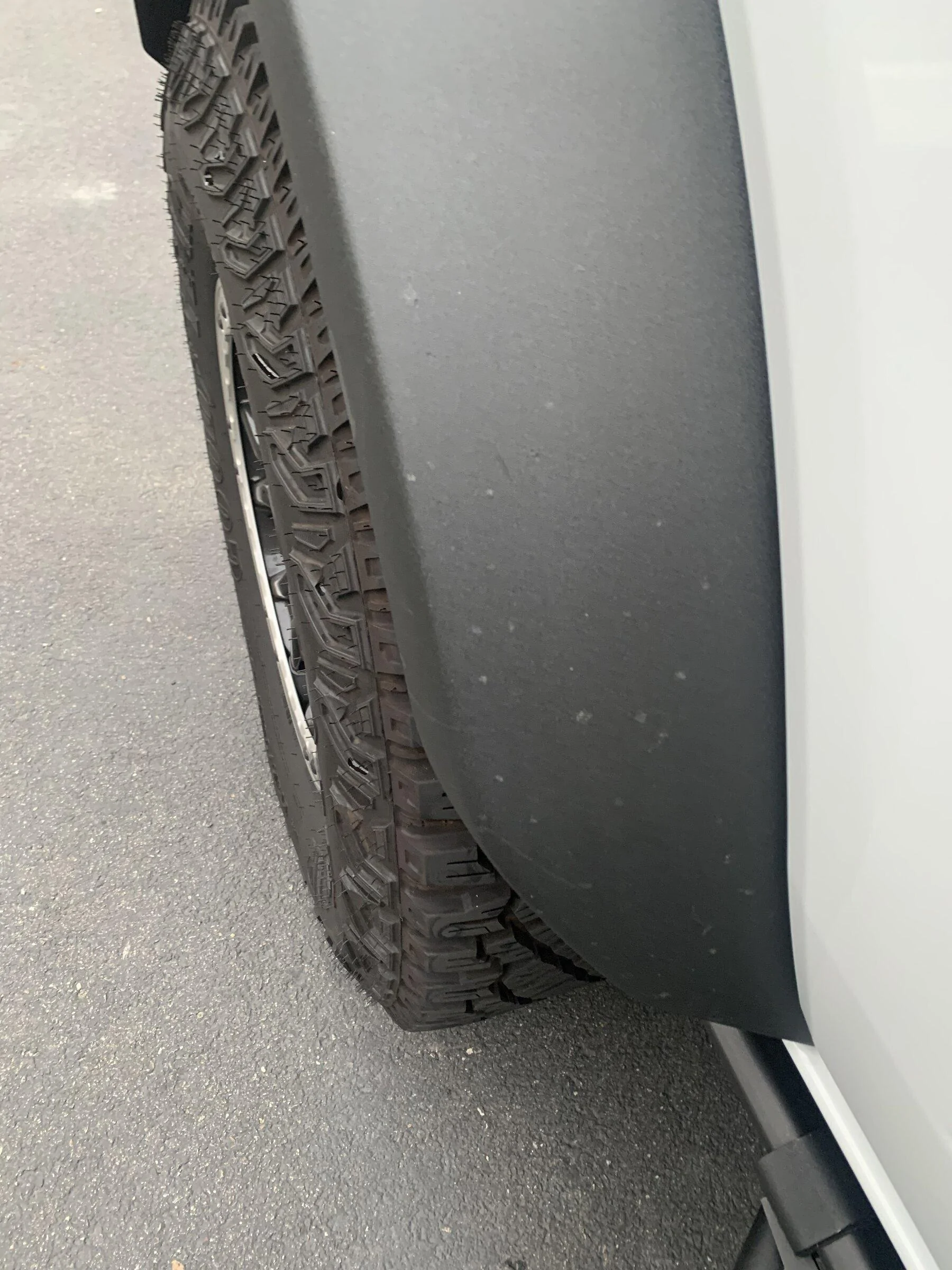

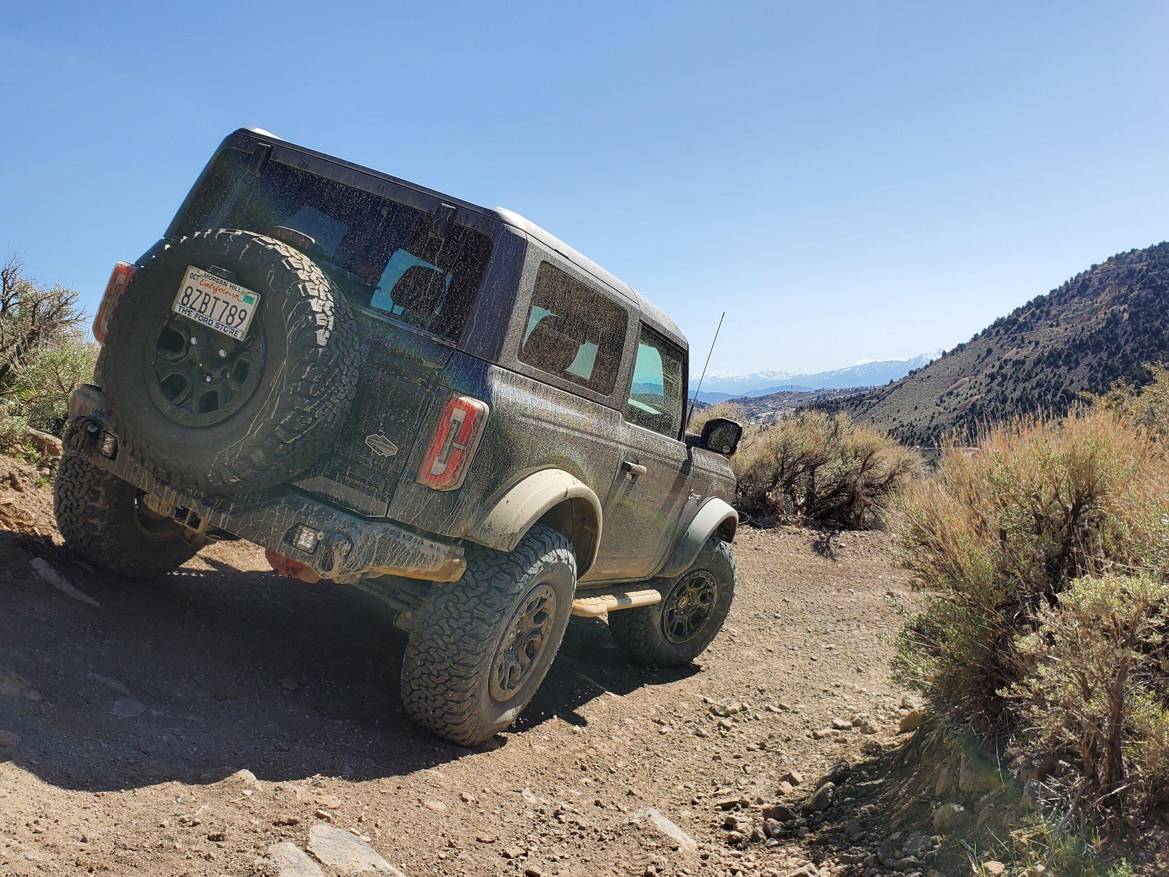

As most of you know, it only takes a light splash of mud or a bit of wax to stain your unpainted fender flares. There are a few topics on this with many different product recommendations. In this thread I just want to share one such product that works pretty well for me and hopefully might spare you from some frustrations.

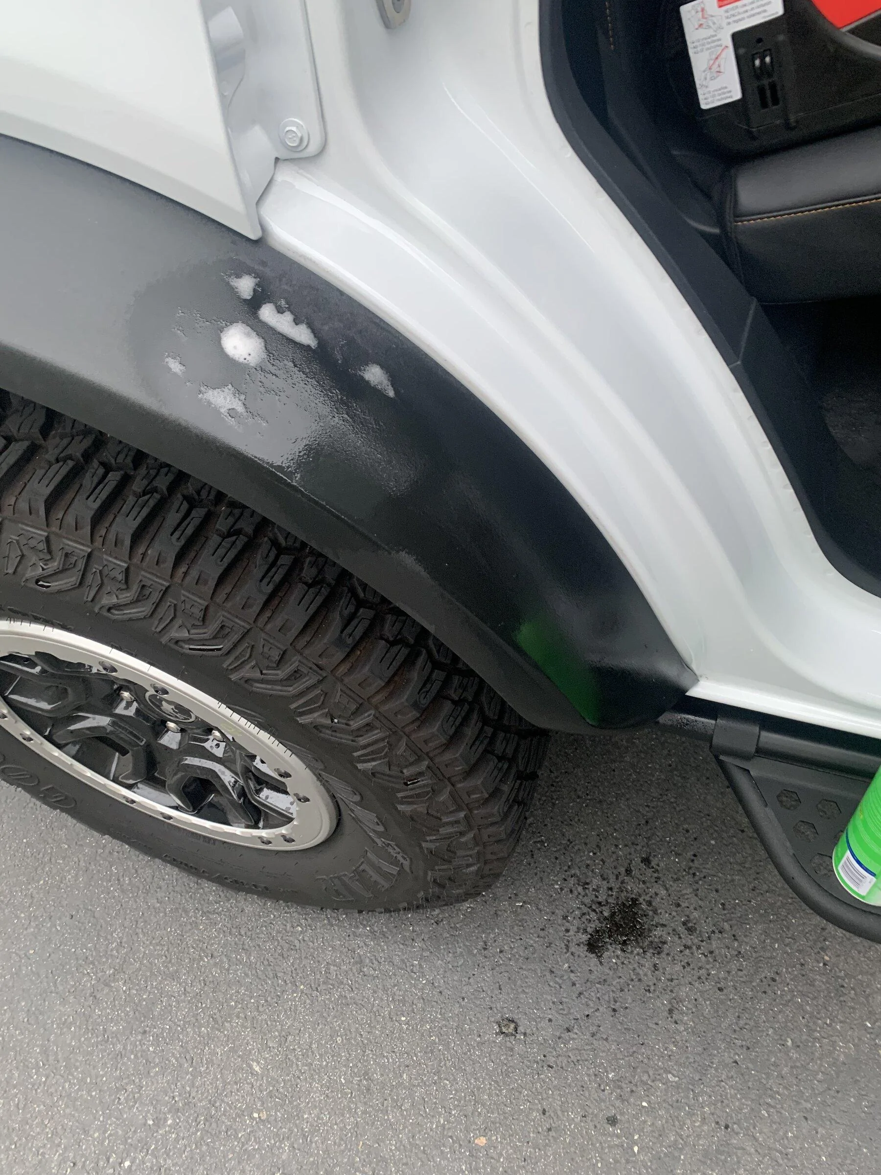

The product is Scrubbing Bubbles Bathroom Cleaner and it works by penetrating the plastic and dislodging the dirt. I let it foam for a few minutes and wipe it clean with a cloth. Credit goes to my wife who felt sorry for me trying to scrub the stains off with every conceivable cleaner.
Mud Stains:
Ford Bronco How to clean your stained fender flares C8FE4C2B-68E7-4722-9ECF-A79ECA9C956C

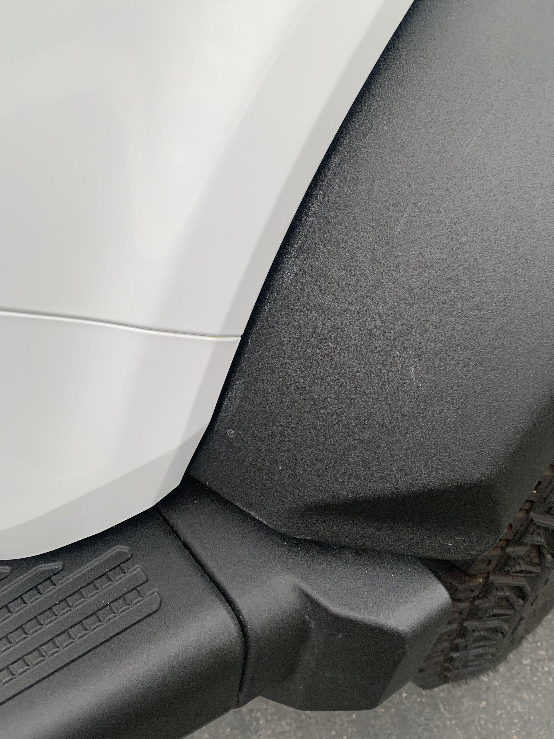

Wax Stains:
Ford Bronco How to clean your stained fender flares 27CE8490-1174-432C-88BC-F1E0CDA98A22

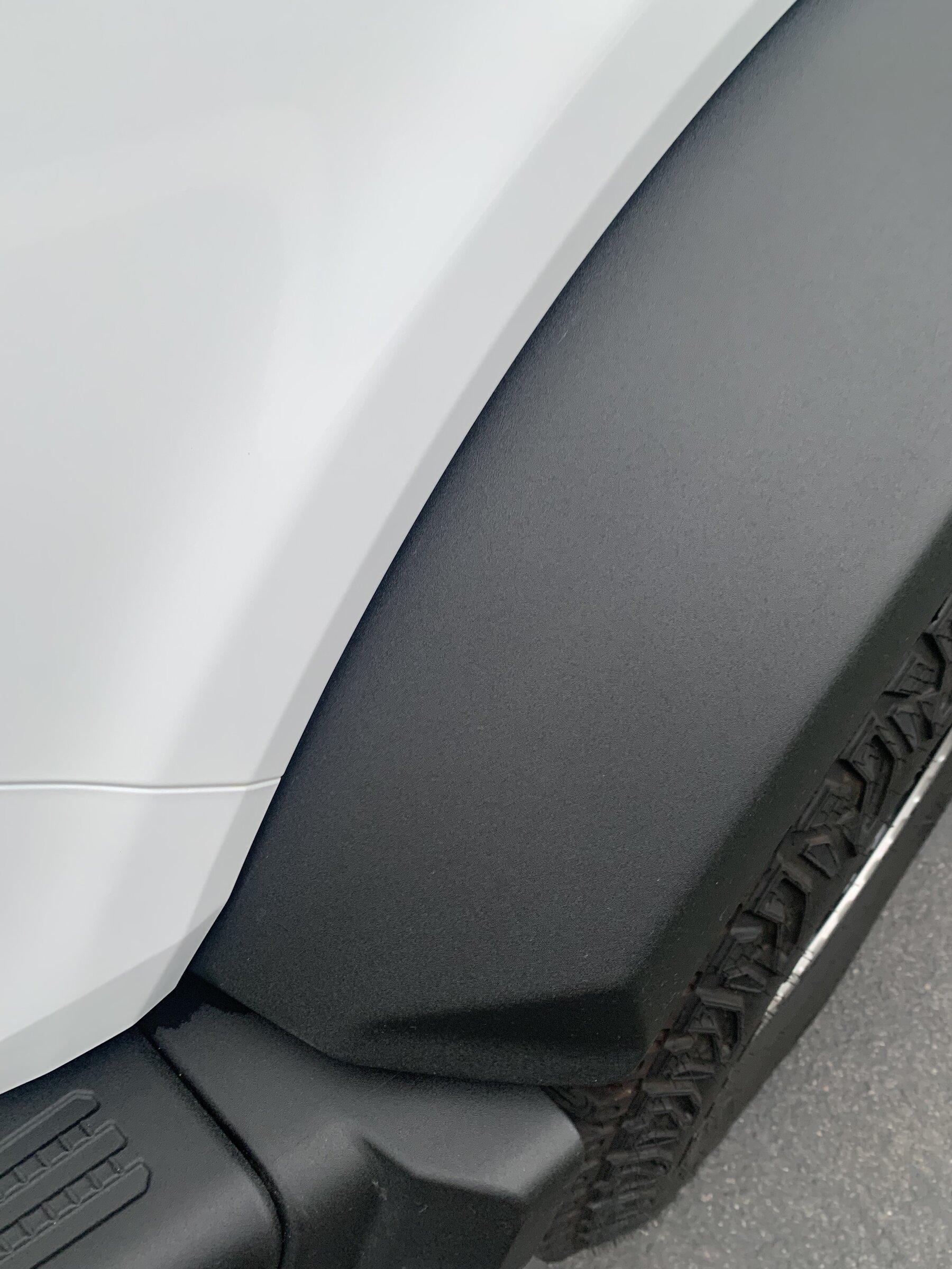

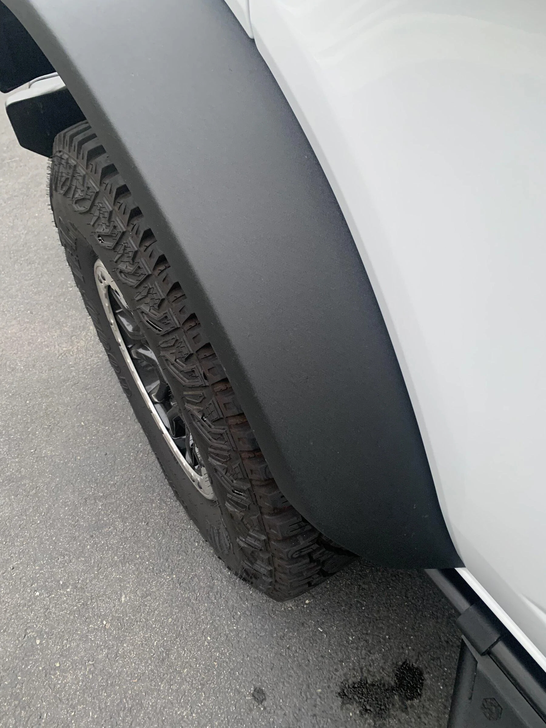

Results:
Ford Bronco How to clean your stained fender flares 6FB8A200-9FB9-433E-B9E5-485C2D3263E6
Ford Bronco How to clean your stained fender flares A51E3ECA-138B-4A7B-BBE1-0A33A787E6EB
