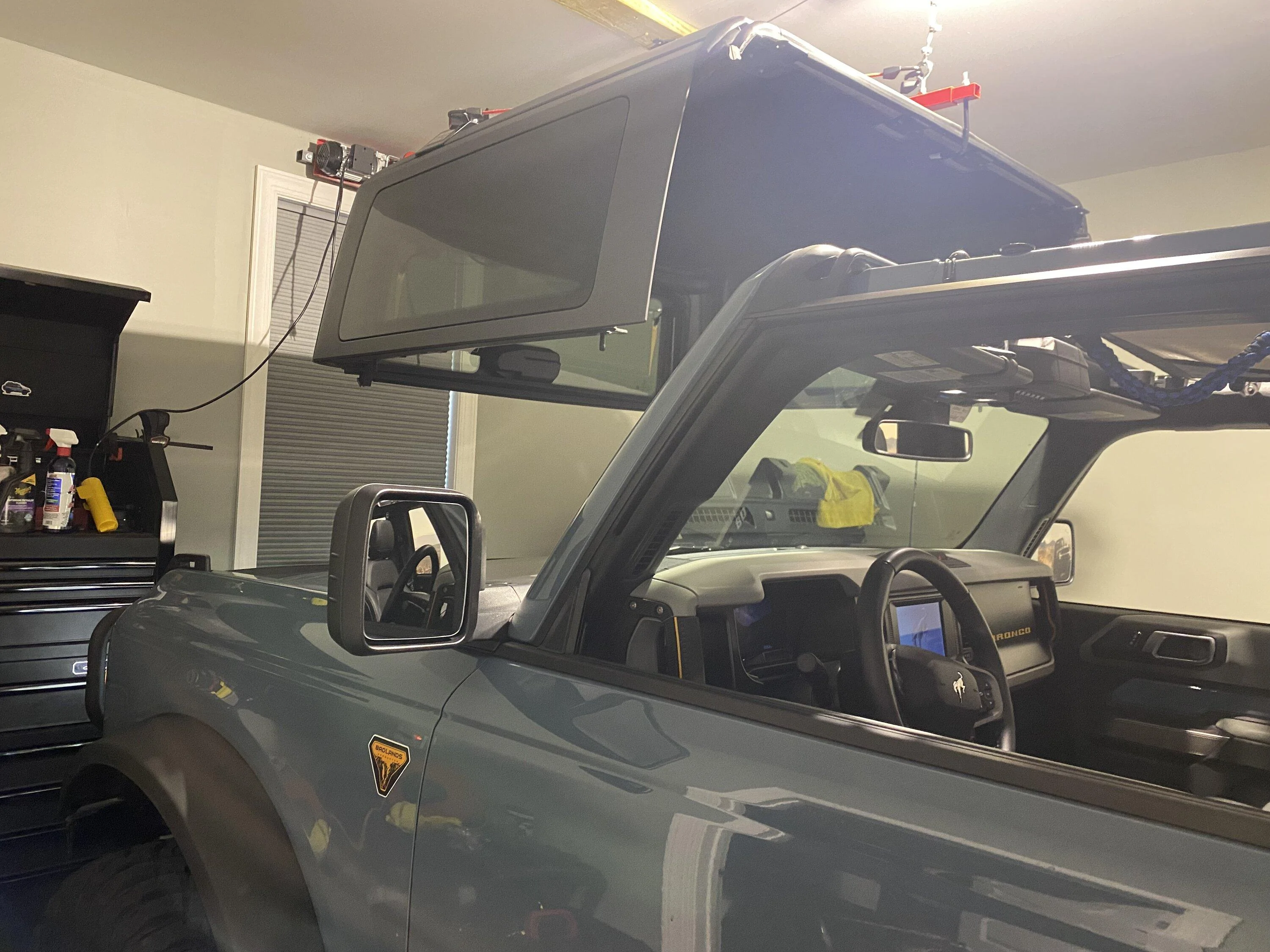

I have a ceiling mounted winch and a power ratchet with the torx bit (far less likely to bust a window in a rush). My 2 door top goes on/off in 10 min or less. I leave the top hanging from the ceiling when not in use. I park underneath it when it’s off.

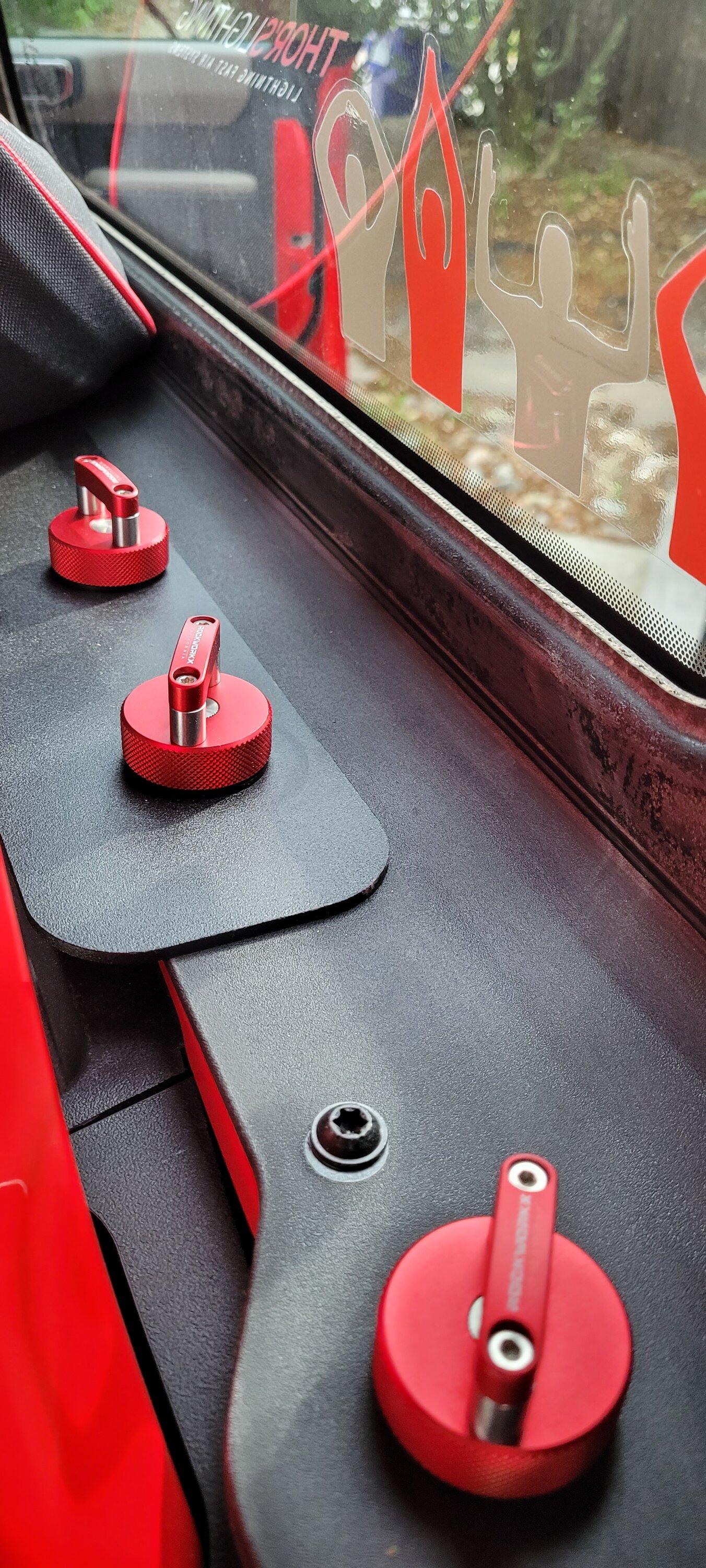

Why in the world are you using hand tools lol. Get the Rockworx thumb screws, or at least a cordless ratchet.
Yeah. They look awesome and fairly priced. Will be ordering the silver ones. It looks like there is plastic/rubber on the bottom where it contacts the top?

Yeah. They look awesome and fairly prices. Will be ordering the silver ones. It looks like there is plastic/rubber on the bottom where it contacts the top?
Good to know. Thanks. I was worried the frame would warp, or one of the pins would pop off.
Yes they have a rubber washer. They work great and are a must if you take the top off often. Make sure to get the two for upper roof bolts as well for completely toolless removal (they used to be sold separately, not sure about now).
That is the same setup I have for mine! Love the hoist I can remove the top by myself and reinstall it by myself. I like that it gives me some where to store the clam shell when it is off too.

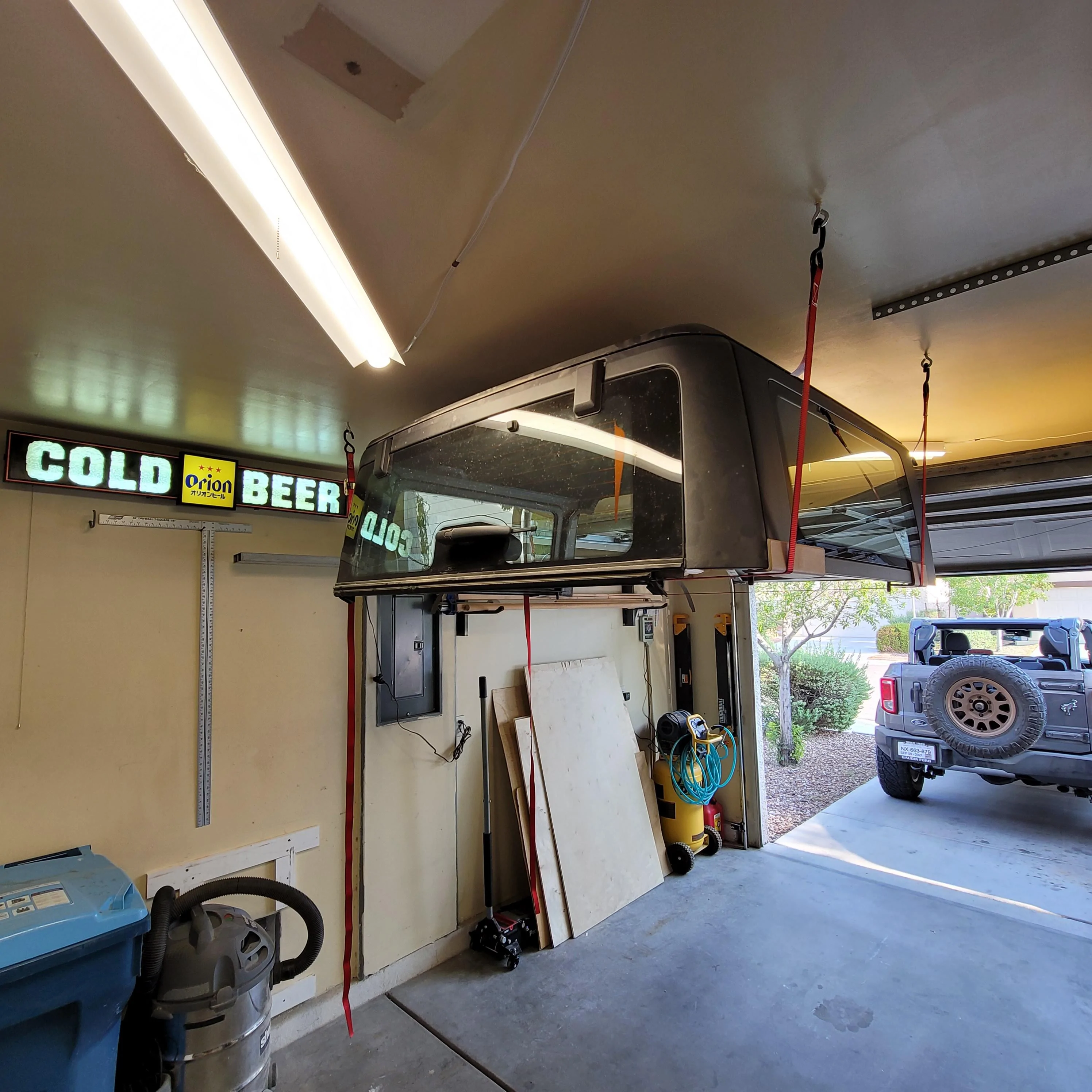

$15 cam straps and 4 of those cardboard corner reinforcements you find in heavy shipping materials. *Feather the trigger* on mini impact with wobbler for the bolts and dont let the anvil strike more than 3-4 times.
Can do comfortably solo in 15-20min. 6'1" in good health and have done about a dozen times with no issues.
What brackets are you using for the hardtop slots for the roof rack? I've been searching for something like that so I can rig up my ceiling mounted winch as well.
