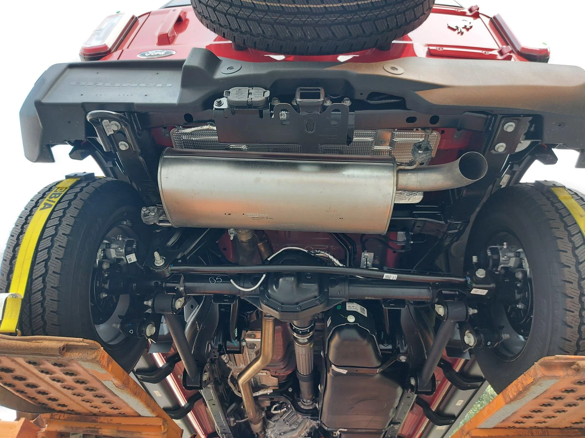

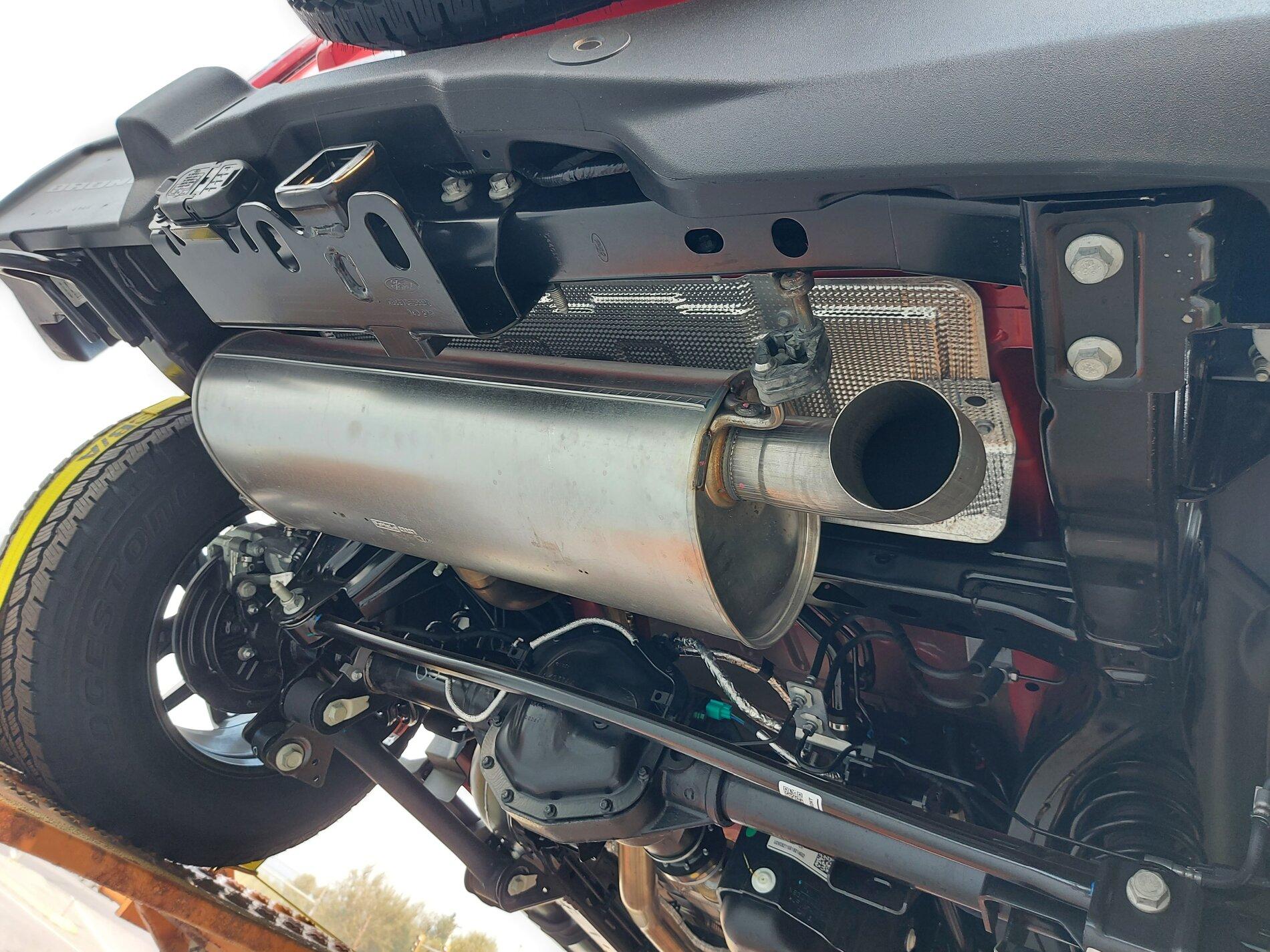

Just saw my first one IRL and it was on the top deck of a transport truck so got good shots underneath. There's room for a more robust reciever attached to the frame rails, but it would likely need some minor adjustment to the muffler and exhaust tip.

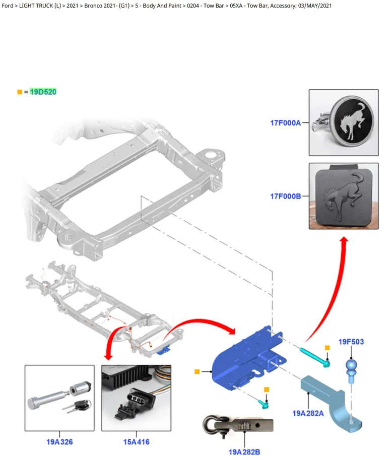

Good conversation thx! My 4-dr BL is "supposed" to be built next Friday 9/3 and super excited; I did a MIC delete and a Tow pkg delete to see if it improved my odds; in retrospect, should have kept the Tow and hoped for the best ;-). In any case, since my use-case is only to support a heavy duty Hollywood eBike rack, I will aftermarket it and not install wiring.
I see the OEM part and my dealer of course doesn't discount but the local Lasco Ford, Lasco parts has discounting and local pick-up if I want. The part number is: MB3Z-19D520-A ; MSRP is $350 and they have it for $269.50; the full URL is:
https://www.lascoautoparts.com/oem-...vJnk9MjAyMSZ0PWJhZGxhbmRzJmU9Mi0zbC1sNC1nYXM=
The description and pics are not really there and I called them and the friendly parts dude answered my Q's and then emailed me the PDF of what it looks like and what's included. See pic below. He stated that the stuff with the golden/yellow little square symbol is what's included. My only open query is that it shows the long bolt but only one of them; I'm "sure" there will be (4) included.
