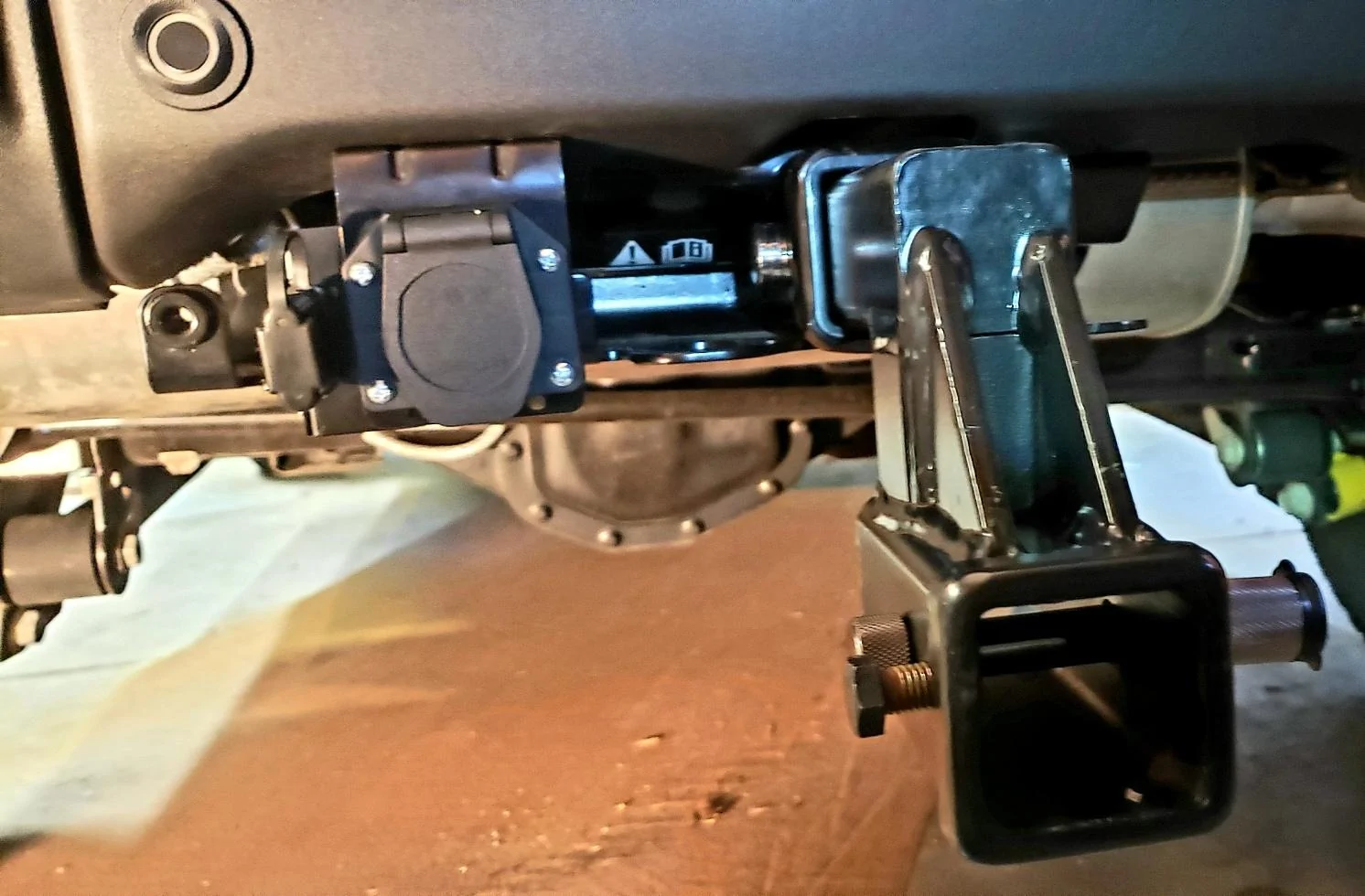

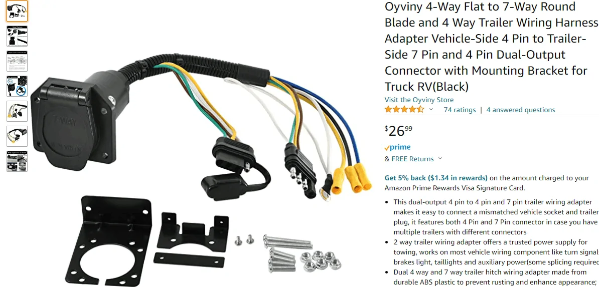

Interesting thread as I just did something similar to get a 7-pin. Like many of you, I dropped the tow package in order to speed up delivery. Once I got my Bronco (early Nov) I started regretting it since I would like to take it on some light camping/boondocking, which I plan to this weekend. In preparation for this I had my dealership install the Ford accessory towing package (the same one discussed here that only comes with a 4-Pin). However, even the smallest of campers with weight below 3500 lbs seem to require a 7-Pin. So after a bunch of research, I installed this myself today:
https://www.amazon.com/gp/product/B08N5WR1RY/ref=ppx_yo_dt_b_asin_title_o02_s00?ie=UTF8&psc=1

Below is a pic of finished install. I removed the mount for the Ford 4-Pin to make room for this aftermarket piece, which includes a new mount for the 4-Pin to the left of it. I did have to drill two small holes in the bottom of the bumper to mount the metal frame for the plugs. The Ford version of the 4-Pin is now tucked away in the back with the rest of the wires.
Right now I only have the 4-Pin related connections wired into the 7-pin since I do not have time to wire a constant 12 volt line for trailer battery charging, reverse, or the brake controller. If I had time, and knew how to do it, I would add the brake controller to this setup tomorrow! Matter of fact, I have asked my dealership to quote me the install for the Ford brake controller to my 4 pin accessory setup. So far they are still trying to figure out how after 2 days! This is there words not mine! So there is still not a lot out there on these 7-pin setups for the non-factory tow packages.
Ford Bronco Adding Factory 7-way to First Edition 20220126_232653_resized
On another note, the pic also shows a 4" Drop Down Extender Hitch. This was to get the hitch lower for both a 2,700 lb small camper and away from spare tire (with the regular ball hitch with 2" drop I am at 18" to top of ball). It also allows me to see the ball when backing up since it extends out 9". However, after doing some reading it seems the common thought is that extenders reduce the tongue weight by 50%. I think that is a conservative estimate, still what I am planning on towing is already near the max tongue weight of 350 lbs, therefore I am planning on returning the 2" ball mount hitch for a 6" Drop Long Ball Mount hitch (like one below) and removing this extender (will keep it for a bike rack maybe). Seeing the ball to backup isn't worth it. I do find it a bit odd that these longer ball mounts also do not reduce the tongue weight by some... Do any of you think I am overthinking this?
Ford Bronco Adding Factory 7-way to First Edition 1643261782668
Anyway, if interested, I will report back how my towing event goes. I am renting a 2700 lb trailer over the weekend...
