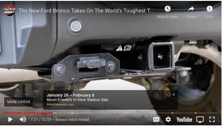

Took a screen grab - looks like just the 4-way accessory part.

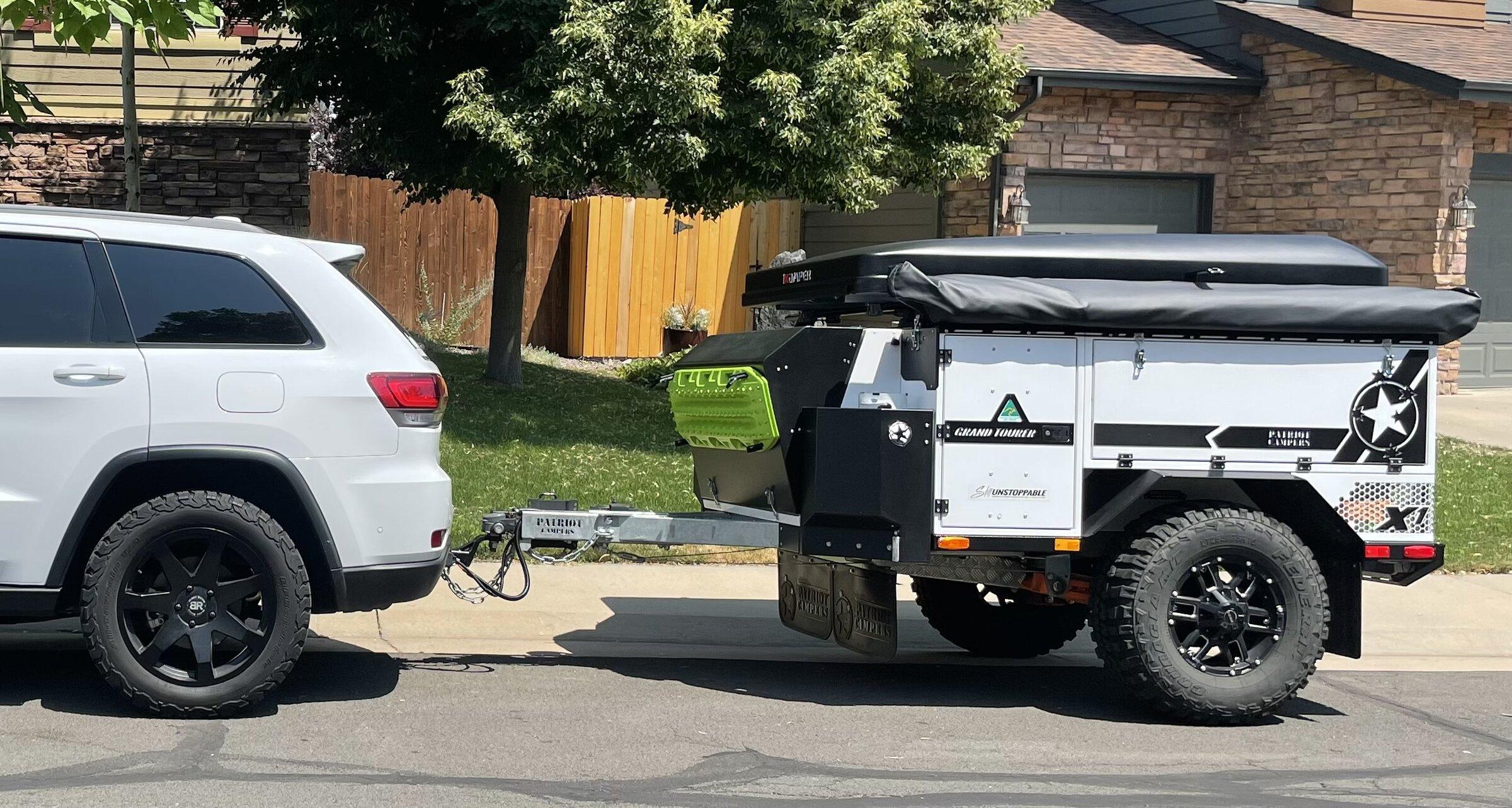

Horseshit! So you’re telling me that I should always tow my offroad camper with my fullsize truck? Having electric brakes when towing through the rockies and on steep rocky trails on a mountain shelf comes in very handy. The trailer is just as capable as the damn Bronco is. Pic is behind the wife’s GC trailhawk that she sold for the 4dr BL.

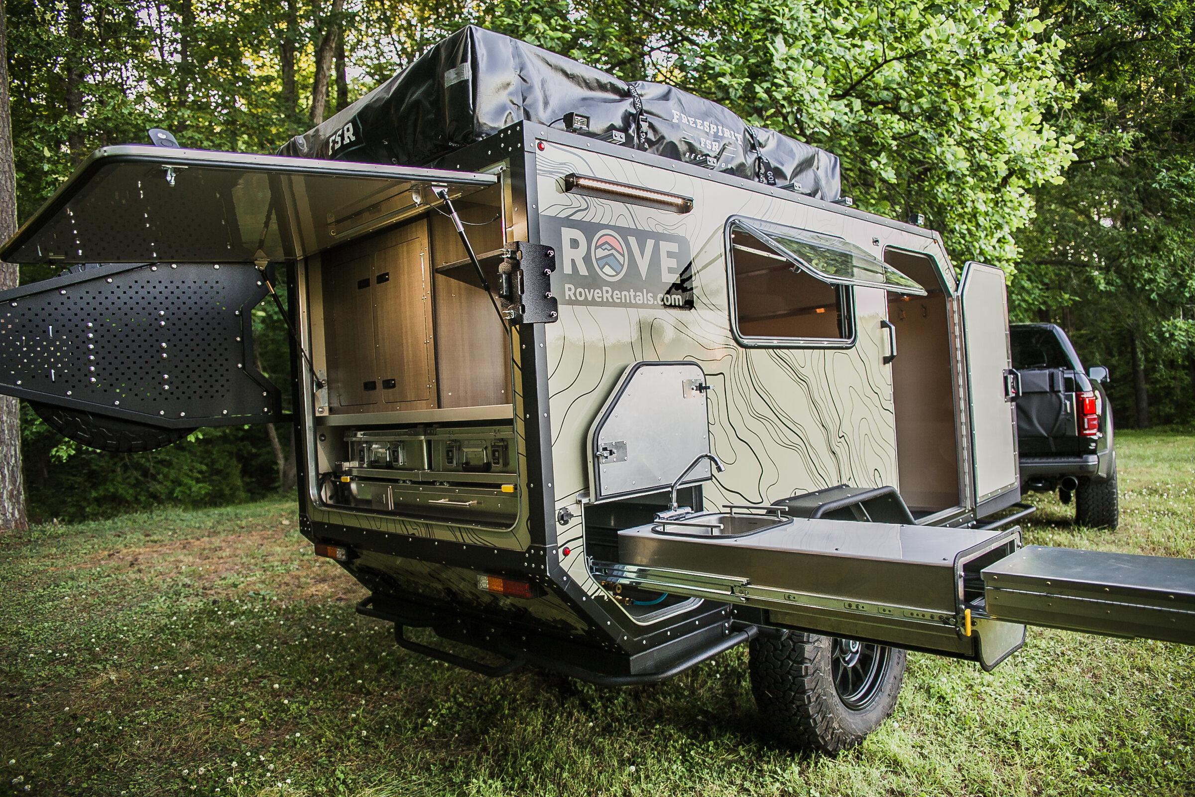

I'm pulling something similar!
