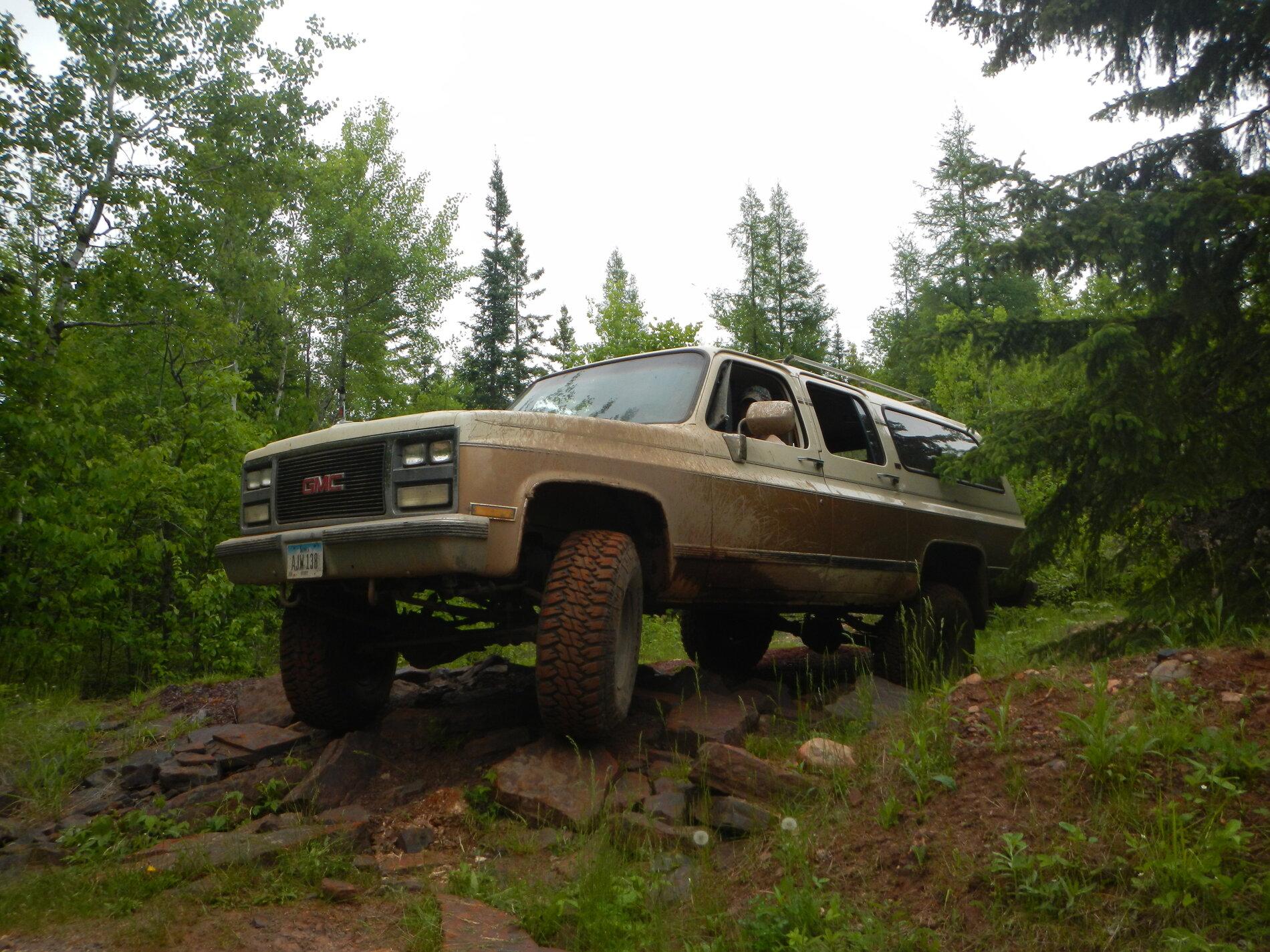

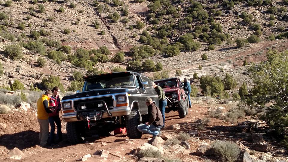

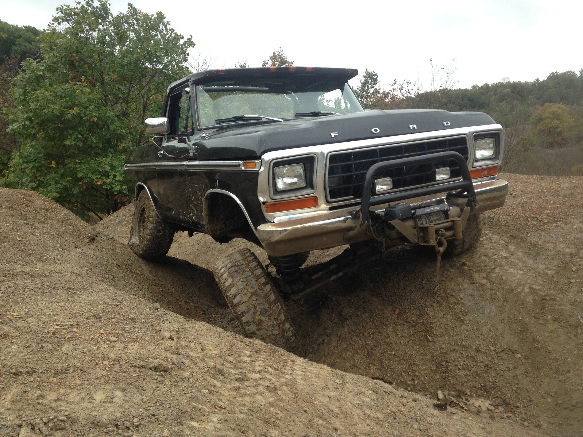

MIOBI (Make It Or Break It) - Knoxville, IA (private owned park)
Strike Ravine - Moab, UT
Iron Range - Gilbert, MN (Public DNR run park)
