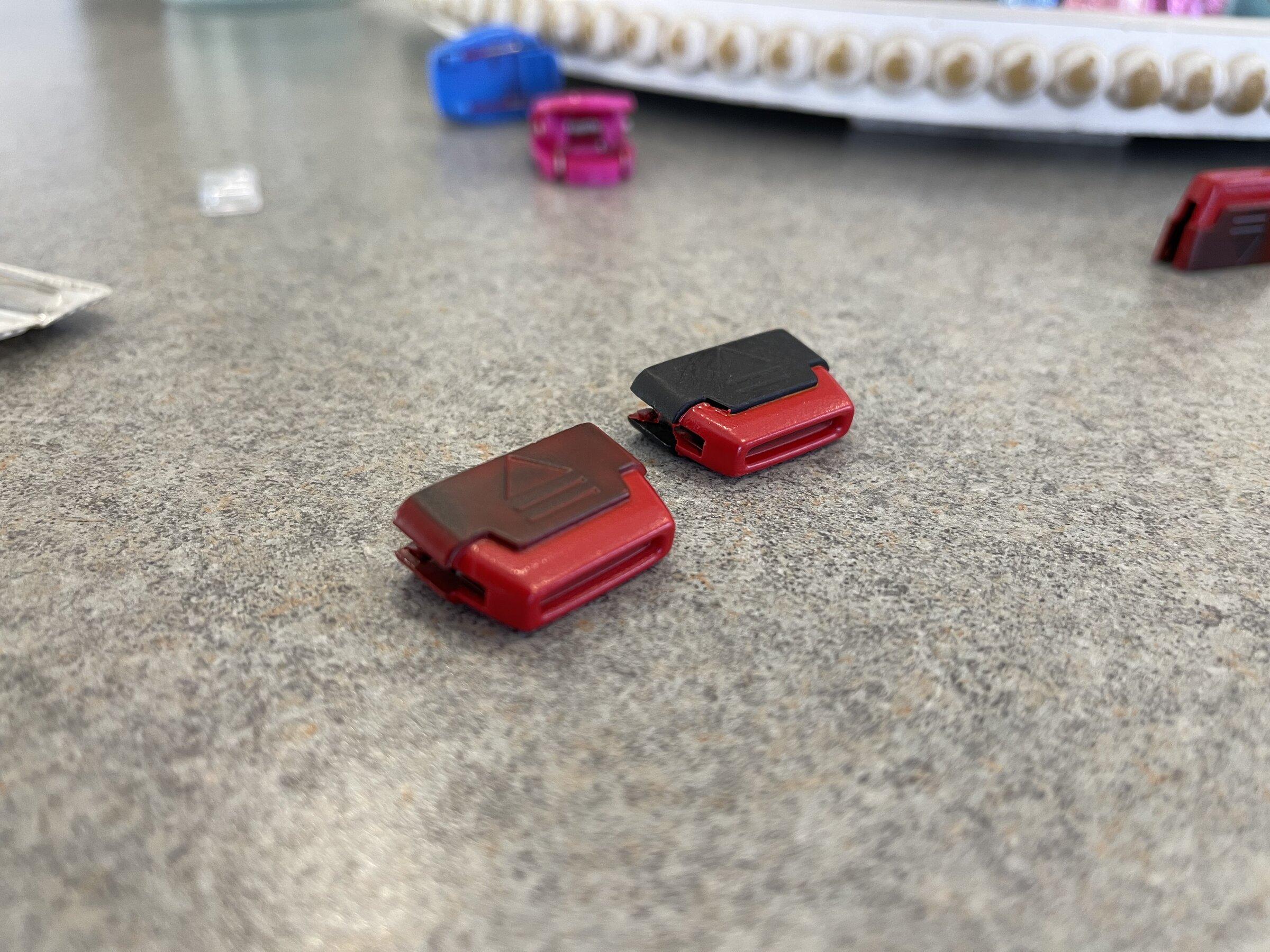

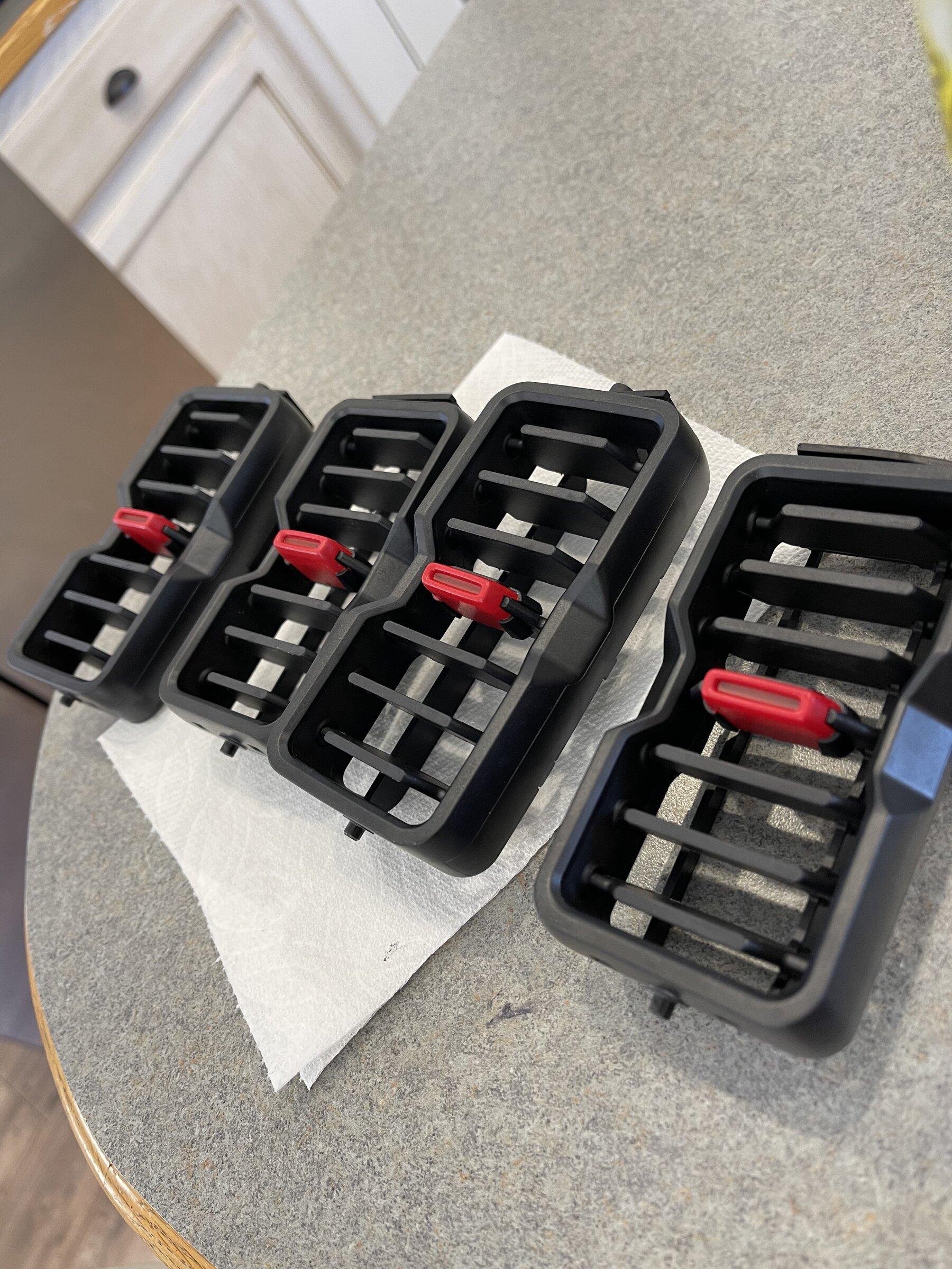

What did you do to change the color of the "tabs" in the vents?? Paint, Vinyl ???? did you do the color change with them on, or is there a easy way to remove them?? Thanks......
Wrecker
Jacob
Mar 11, 2022
I took them off & used red plasti dip. You can remove them by taking the vent piece out & spreading them open from the back & pushing them off forward. Plasti dipped, razored then peeled off the sections I didn’t want red.
That is a brilliant idea! Thanks for sharing details.
