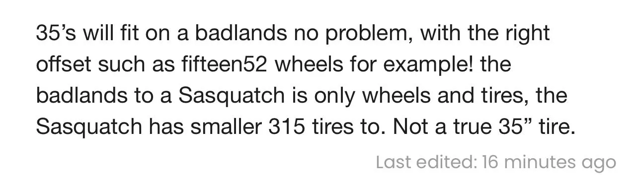

Here’s what you originally wrote and my reply:
Ford Bronco Badlands vs Sasquatch E9E76910-3235-4C5B-A737-05F700C5C519

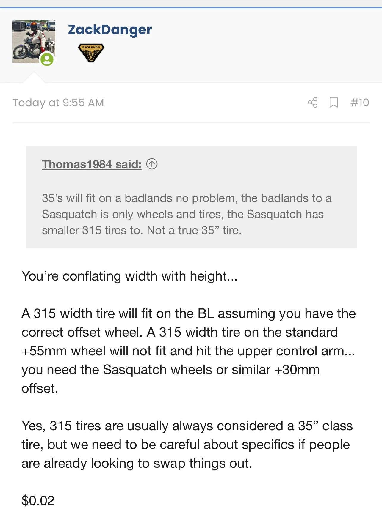

I was making it clear that one can not simply state that 35’s fit on a badlands no problem... there is a problem with *width*, and people need to be mindful of that, and we need to be clear about what we are communicating.
What I don’t appreciate is you editing your original post and then telling me to go back and read it again, implying I misread it the first time.
