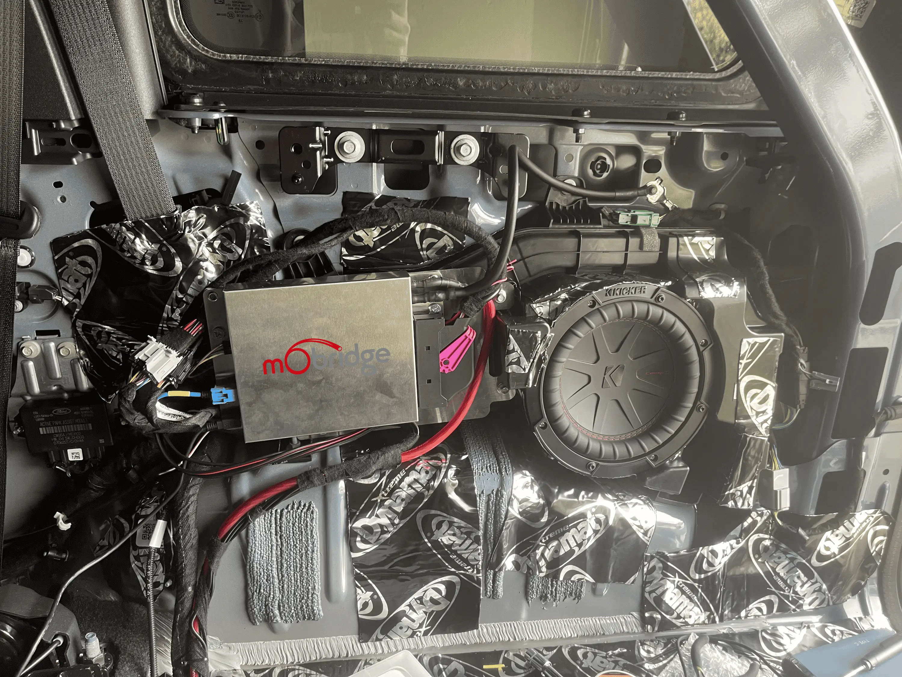

Once you swap the ACM module over to the A2B one and code the car accordingly (If we end up doing this kit, it would include a coding dongle that does all this for you) the signal is then sent over A2B raw. So we get sent a unfiltered digital signal straight to our amp.If you have the base system you’ll retain the chimes and turn signal. You’ll need a T harness which routes speaker wire inputs into the dsp. There’s other systems that use DSP even the kicker
How do you propose your equipment will change the output if the output is already filtered from low frequencies? I suspect that you’ll use the front channel signals which are already full range and sum the signals without using forscan to change syncs eq settings to flat?
