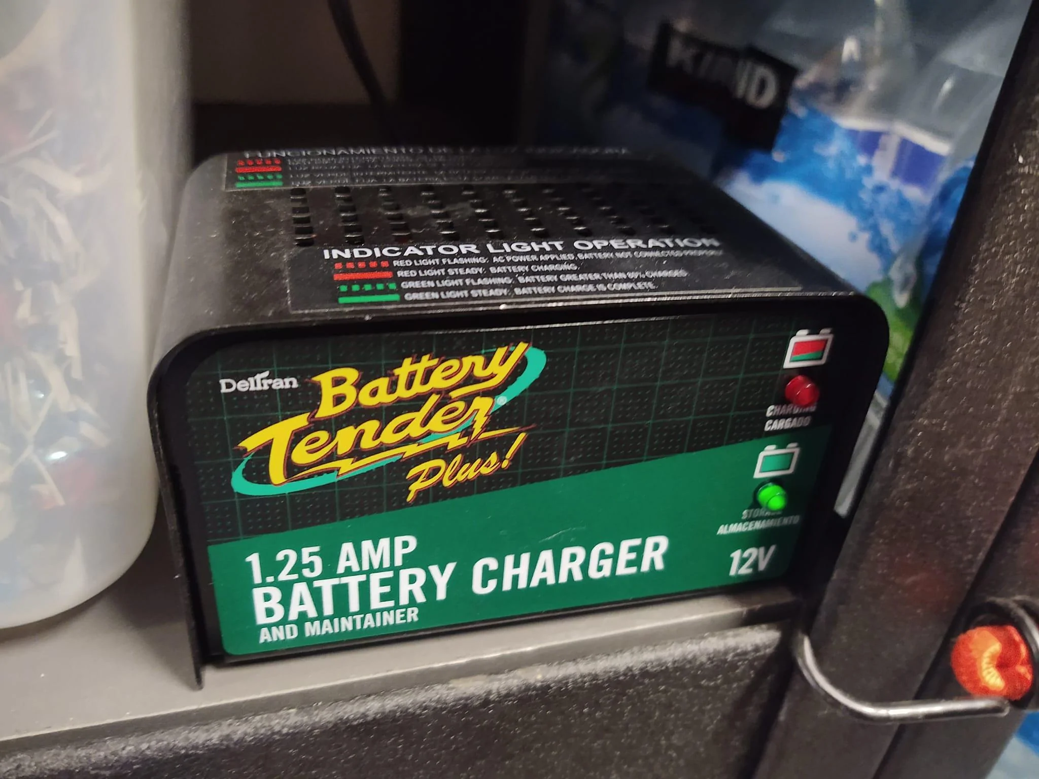

As far as the battery; these new vehicles are never off, something is always running. I keep mine plugged in 24/7 to a Deltran Battery Tender (all of my vehicles). Unplug and go! It is always ready, battery topped off and it lengthens the life of the battery.

If I don't run mine much for a week I'll put a smart-charger on it until I get the battery 100% charged.
When I close the hood after the charge... it always makes a click or two.... always!!!
I assume that is just R2D2 telling me -- "thanks for the meal -- I'm full"

We have a bronco customer with a battery draw caused by the rock slide steps. Have had to drag it in twice, charge and return. Told him to either call rock slide and get a replacement module, disconnect them or keep a battery tender on it since it's not daily driven. He has not made any mention of wake up or power down noises but once battery voltage drops below a set limit modules start freaking out and do dumb stuff.
