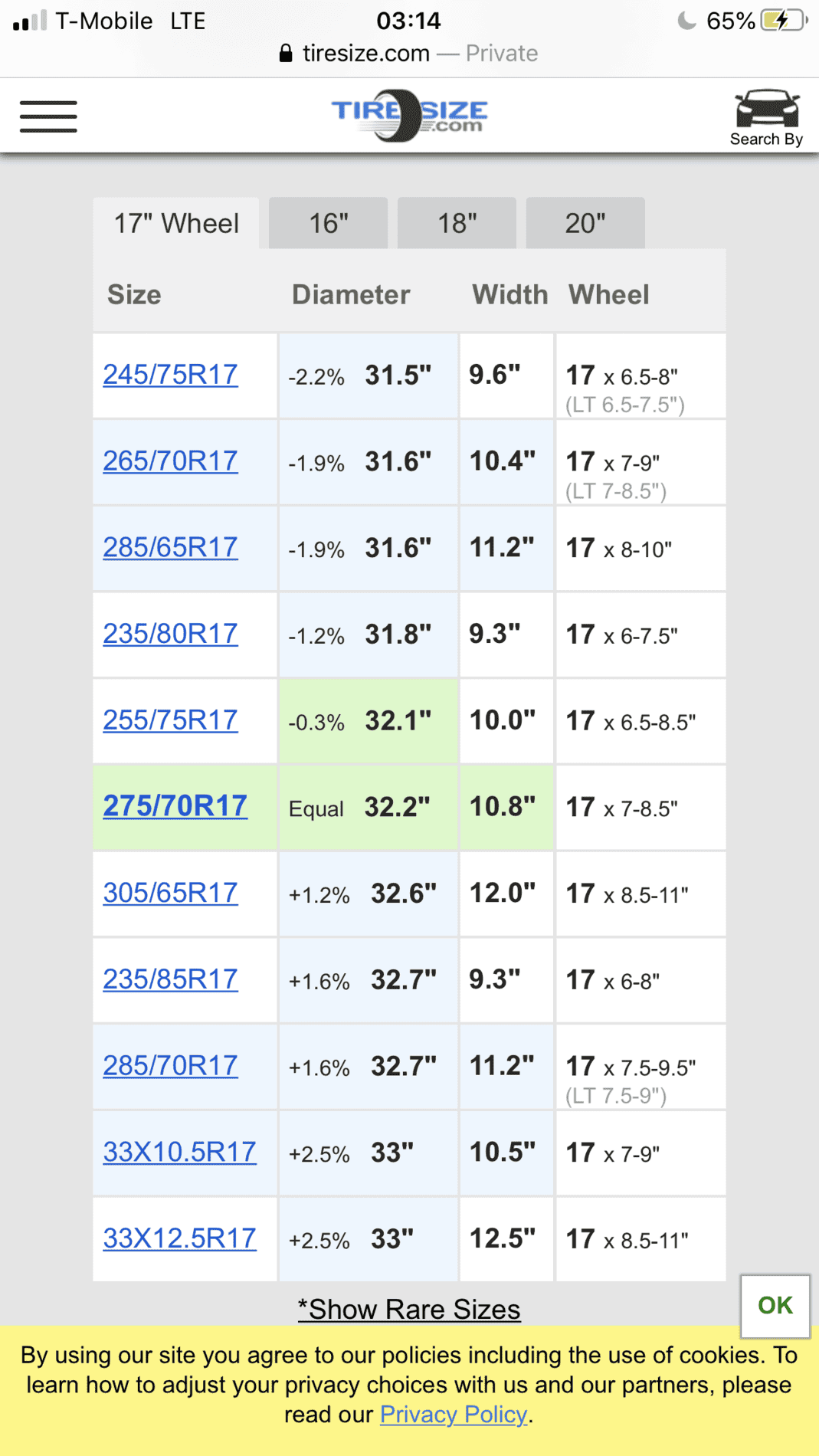

That's what I was thinking. A real set of 33s won't be that much smaller than the "35"s on the squatch. Hoping I can fit either 295/70s or 285/75s on the stock steelies without spacers.
295/70R17 tires are usually arond 33.5 inches, and 285/75R17 tires are about 34". They likely would fit with the Sasquatch package.
Yeah, but I'm not doing squatch. Paying to limit articulation doesn't sound like the best use of my money. If I have to change coilovers to get a true 33in tire to fit, I'd rather pay aftermarket and get more articulation.
And those tires are more like 33.2-33.8 depending on manufacturer.
Ford Bronco Black Diamond Bronco Thread 5CF76DE8-ED58-45E9-B414-C9A17BC08FE9
I'm just going to wear out the Grabbers, then let everyone else tell me then what will fit the stock BD. ?

That's a 275, not a 295 or 285. BTW, the 275/70R17 BFG AT KO2s are likely what I'll opt for with the stock wheels after the Grabbers wear out, if I don't get wider rims.

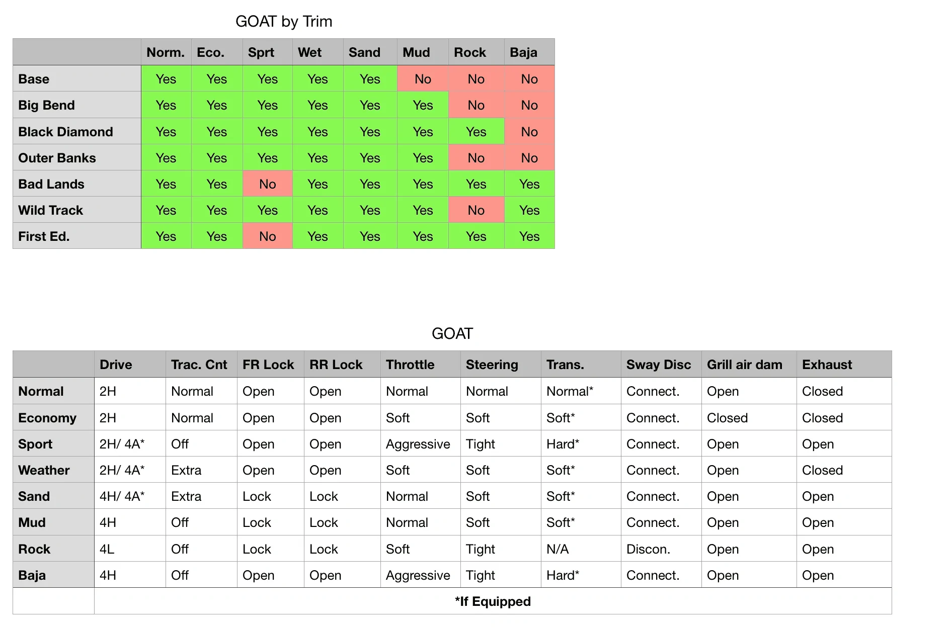

I’m pretty much set on BD. Only other trim I like is wild trak and that’s mainly because of Baja mode and the 2.7 standard. If I could get Baja mode in the BD I’d be happy but it’s nothing a tune can’t fix.
I don’t see how the GOAT modes will make much difference for off road abilities. 4x4 transfer cases go into 4hi or 4lo. The only difference between Baja mode and sport mode is 4hi in Baja from what I saw on another post here. Manually switch to 4hi from sport mode to mimic Baja mode?
