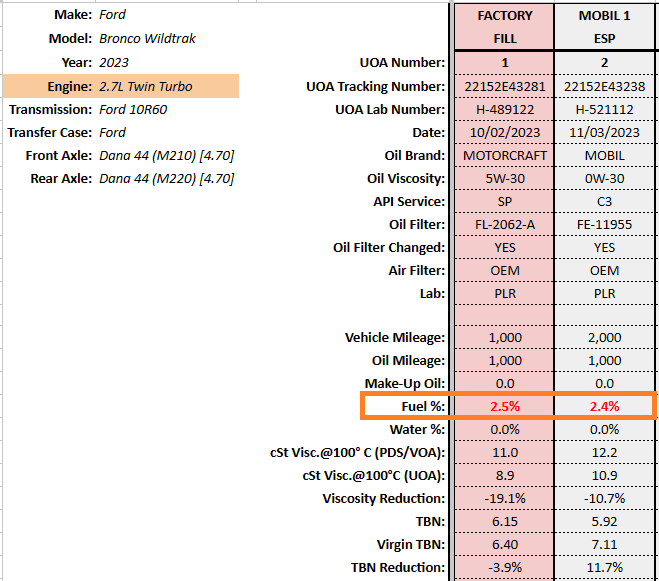

Fuel dilution appears to be a thing on Ecoboost engines period. The first 1,000 miles were from Dallas to Colorado Springs (flew to Dallas to buy it) and there was no idling. Open road is where the least dilution should happen, yet I had 2.5% (which is too much) on the first 1,000 mile oil change and 2.4% (also too much) on the second 1,000 mile oil change. The lab I use (Polaris) uses gas chromatography to determine fuel content so it is accurate (other labs such as Blackstone do not so the fuel concentration is not accurate).
Motorcraft oil did not stay in grade, the Mobil did on the second run, but it is M1 ESP 0W-30 so it begins with a much higher thickness than other M1 oils AND this is only a 1,000-mile run. I would opine that it would be out of grade on a 5K OCI. Just completed a 3,000-mile road trip so I'll see how it did. Unless I have the unicorn of 2.7L engines, one thing is for sure--forget about long oil change intervals in it.
Ford Bronco Break-in oil change 2.7 2023-11-08 19_00_28-2023 Ford Bronco - Google Sheets and 15 more pages - Personal - Microsoft​
