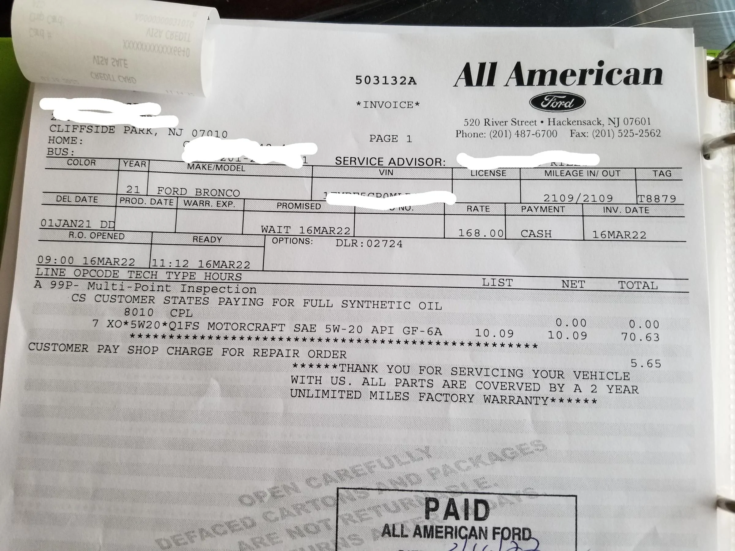

I just got my first oil change yesterday @ 2,109 mi. I had a free first oil change coupon from Ford that I tried to use, but I wanted full synth, so I had to pay for the oil. So $80 bucks for what normally would be a $130 oil change. Odd though, the dealer used Motorcraft SAE 5W-20 API GF-6A, when the cap says 5W-30. Ford know best I guess...

Take it back and ask them why they put the wrong oil in? It calls for xW-30. You would be better off if they had used the syn blend in the right viscosity. Plus the motorcraft synthetic doesn't meet Ford spec WSS-M2C963-A1.

I would definitely have them swap the 5W30 unless the dealer can site where the factory recommends the lighter viscosity oil. It's nothing to panic about IMO, but would not be my first choice personally. I also wouldn't worry about the new spec with the 2.7, it's specifically for the DI motors. The 2.7 uses DI and port.
