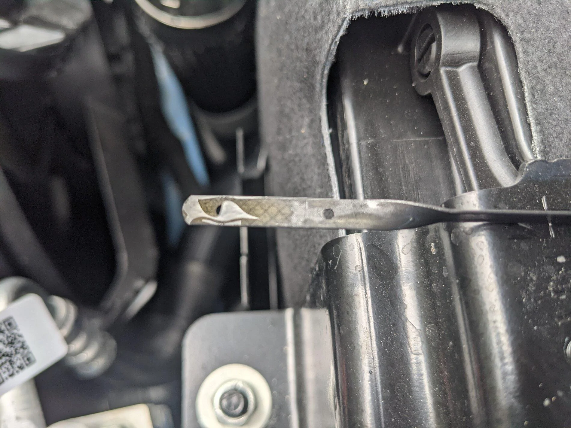

Adding my data point: I changed my oil today at around 1200 miles. I checked the dipstick before starting, cold, after the vehicle had sat all night. The oil on the dipstick was well into the twist, over full according to the marks. I don't have a super accurate way to measure how much I drained, but it was around 6.5 quarts. I put 6 quarts in, waited about 30 minutes, and the level was just under the top hole of the dipstick. I drove around for a bit afterwards. Now I'll let it sit overnight and check it in the morning. If it's below the dot I think I'll add a bit more, trying to split the difference between the dipstick guidance and the 7 qt recommendation. It will be nice once we get some confirmation on whether the 7 quarts is right or the dipstick is right!

Yup...pretty much spot on with what I noticed. Stick level was well into the twist pre-oil change, then I got 6.7 to drain, added 6 which put it right at the top hole after the start/stop/15-minute wait period. Then felt guilty because of the advertised "7 quart" capacity. Frustrating...

I changed mine today. Not sure what came out, but 6 qts put me middle hash after a 15 min engine run post change and 30 minutes with engine off. I'm going to leave it and check in a week.
I keep checking mine after adding 6, and it's near the top of the hatching.
I have a quart ready to pour in if @Ford Motor Company wants to chime in and confirm that 7 quarts is key. Maybe they can also explain why the dipstick would be wrong and why the engine was drastically overfilled at the factory...

Just checked mine again, 6 hours after oil change. Mine looks just like the pic above.
