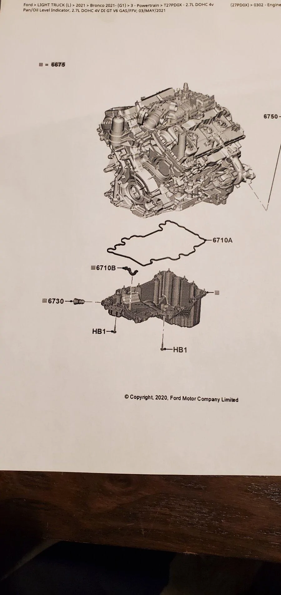

I was hoping that for wheeling purposes that the pan would have a set of baffles or a windage tray like the old school racing pans intended to keep oil in the sump during abrupt acceleration...but it is just a traditional pan design. I think Ford may have had intentions to have some whiz bang system, but then dropped the ball and slapped a 6 quart capacity pan on the 2.7s. Like the intended map program that was supposed to be released in the Fall that has a cool video out but no actual access...so I went with Gaia (because it works with Android Auto and if you start to create an account and then stop they send a 40% off coupon a day or two later).
I'm not sure who the guy was, but those threads about everything you wanted to know about the2.7... I swear he's specifically stated that the Bronco's oil pan had baffles and that is what made it special.
I'm just wondering if the wrong oil pans are being used...aka the F150 pans.

I checked...the F150 pans have the drain plug at the rear, and Bronco at the passenger side. The image I attached earlier was pulled from the Ford dealer parts system, from my VIN (note the absence of baffles or a windage tray). Also note that even if a pan does have a windage tray and or baffles, overfilling said pan = bad news for the engine. If oil comes in contact with rotating parts (like a CRANKSHAFT), frothing/foaming can occur...and oil that is in that state will not be able to lubricate the way it was designed to. In addition, too high of an oil level can lead to oil making it past the oil separator/pcv system, and into the turbos/intercooler. Anyone who thinks "ah what's a little over the max level going to do" has probably not witnessed the destruction too much oil can and does cause.
