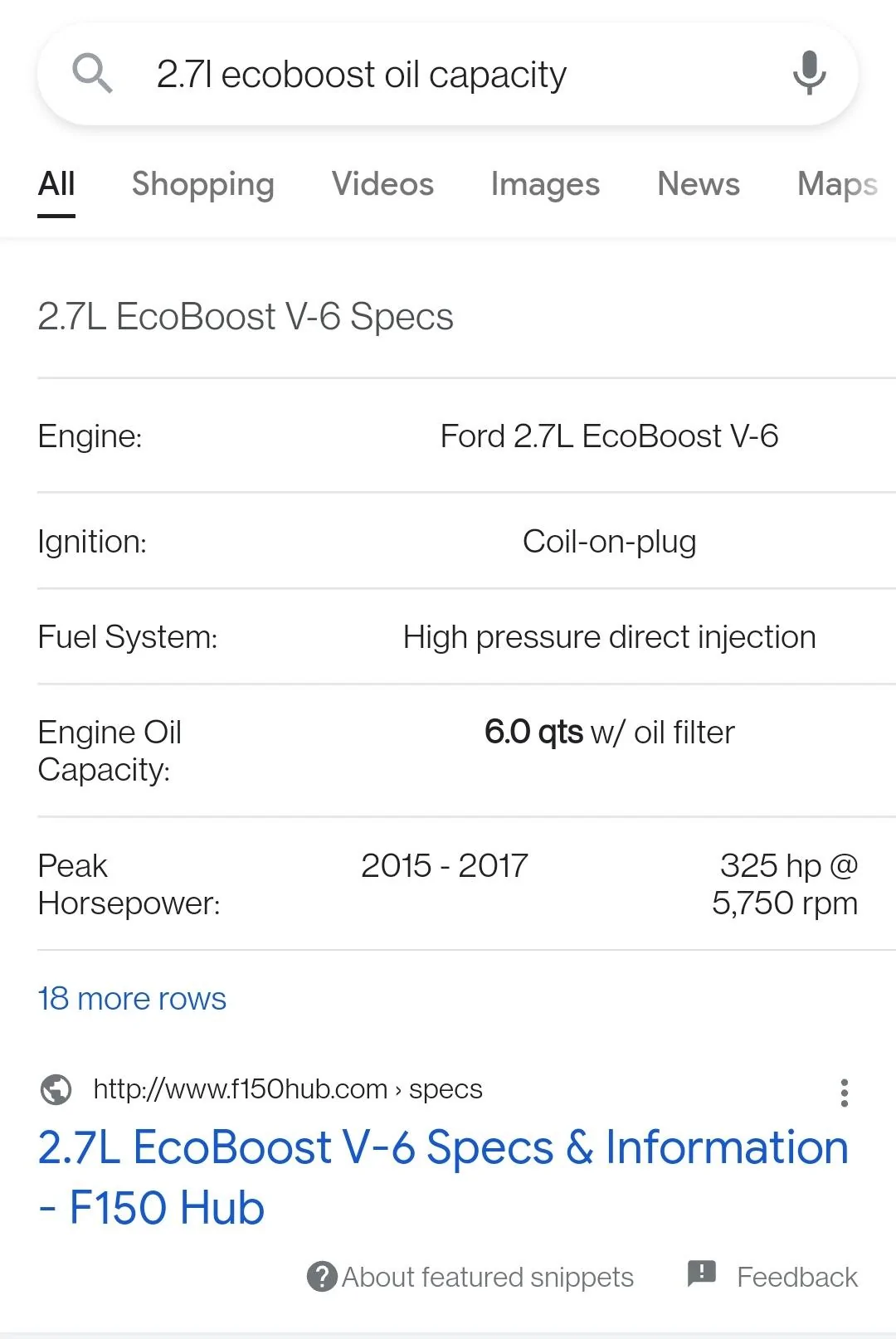

And then there's this to really confuse the situation.
Ford Bronco Dipstick Pic? Screenshot_20211110-072929

Thanks for the info. Because I am only trying to find appropriate amount to fill, not check for consumption between changes, what would the mother Ford-ship suggest given my experience? Here is exactly what I did:
1. Checked oil the morning after I took delivery of my Bronco and drove it home. On a level surface, the stick read 1/2 inch above the max fill mark. I repeated the check process twice to ensure no error reading the stick.
2. For my first oil change, I let engine reach operating temp, then shut it off. I removed the oil filter housing completely, and then removed oil drain plug and allowed engine to drain for a full hour. Measured what I got out, and it was exactly 6.7 quarts.
3. I installed new cartridge, filter, and o-rings, and then installed the oil plug, and added 6 quarts of oil.
4. Started engine, ran for a few minutes, then shut it off. Waited an hour to check oil. After an hour, oil level read EXACTLY at the max fill line.
5. Drove car until it reached operating temp, then shut it off, then checked oil the next morning...it still read at the max mark.
So...in my case, I got nearly 7 quarts out, and added only 6...but stick reads full. Do I just leave as-is, and do 6 quart changes in the future even though "capacity" is listed as 7?

I don't think the 7qts is accurate from what I am seeing online googling and other forums it looks like should be 6qts

Leave as is. I think they have a misprint somewhere that's not been corrected yet as others that have serviced all report 7qt is way over full.
